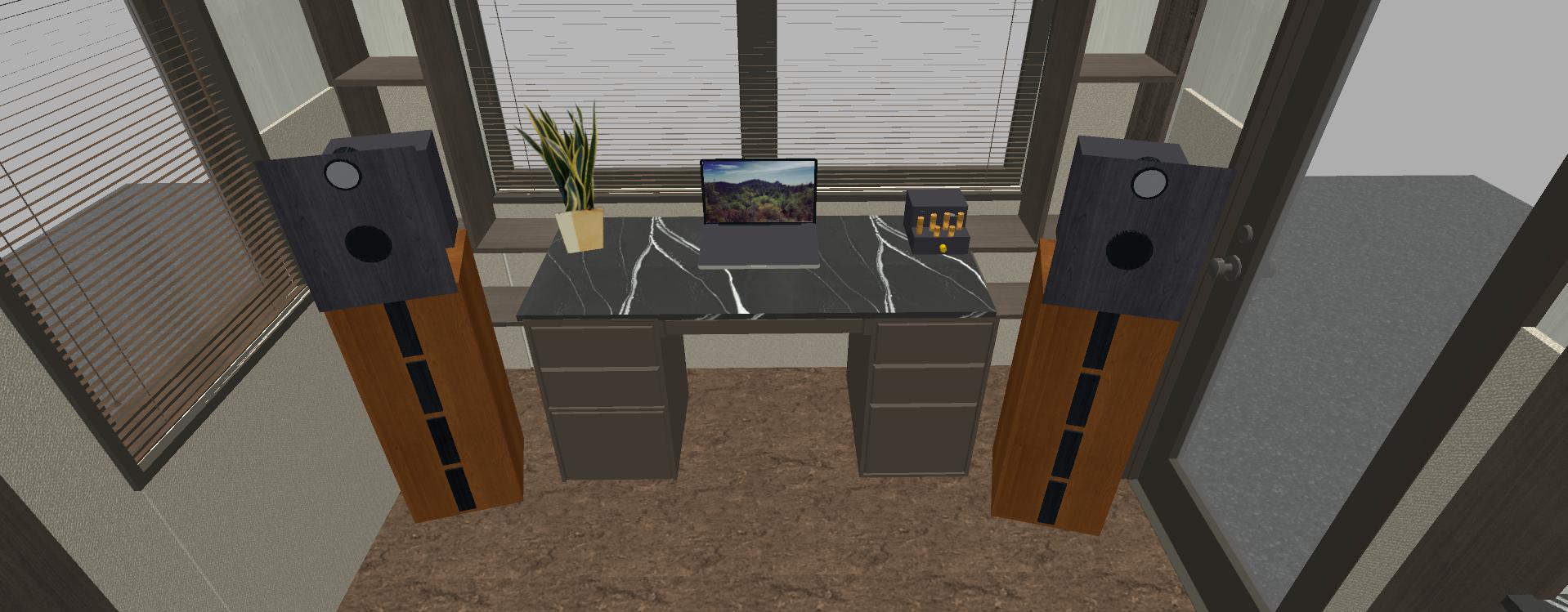

I looked at just about everything I could find for a bass horn and nothing seemed to work out, still open to it, would love it, everything just to big even to go down to 80 hz. Actually I did not dig that deep into a folded TL, etc. but what I did see did not seem to be viable.
I would love to get to look like this and sound great, also moved the door 2" further forward to better access.
No subwoofer, shelves are design ideas.
Couch can move back 25" for sit down listening though we seldom do.
If used sub amp and router behind desk drawers(actually high grade and modern filing cabinets) with custom center drawer and 2cm Brazilian green soapstone top like the kitchen. Wiring in conduit in wall. TV folds down from ceiling, we seldom use it.

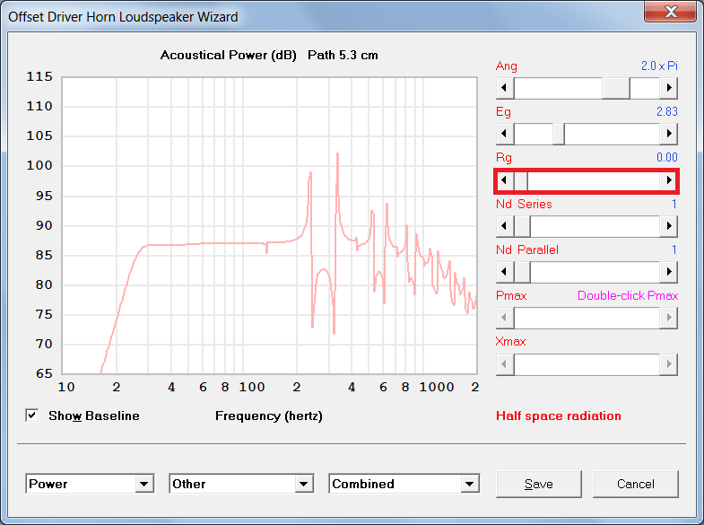

That is a question probably best directed to Martin himself 🙂.Any chance of getting the MJK TL to take into account Rg,
His existing methods give a baseline design to start with, which can then be manually tweaked to maybe produce an even better performance.
Would a TL be the best option in your experience or might another alignment work better, or easier, or both?
Hi Rick,
Every loudspeaker type has its advantages and disadvantages, and every user has their own idea of what constitutes "best". Only you can decide which system to ultimately choose. It all depends on the quality of the driver(s) you use, the size of the enclosure you can accept, the purpose to which the speaker is to be put, the environment in which it is to operate, etc, etc.
A well-designed transmission line system can produce very good results, but so can a well-designed bass reflex system, a well-designed closed box system or a well-designed horn loaded system. The list goes on...
Kind regards,
David
It certainly can. That is what I had in mind when I referred to manual tweaking. Generate a baseline design using the TL Design tool, save the results back to the main Input Parameters window and then open the Loudspeaker Wizard and play with the value of Rg to your heart's content 🙂. Note that negative values of Rg can also be specified, if so desired.OK, thanks, assumed this could be done in HR as part of the Wizard.
If however you want the feature to be embedded into the MJK methods themselves, then only Martin can help you there.

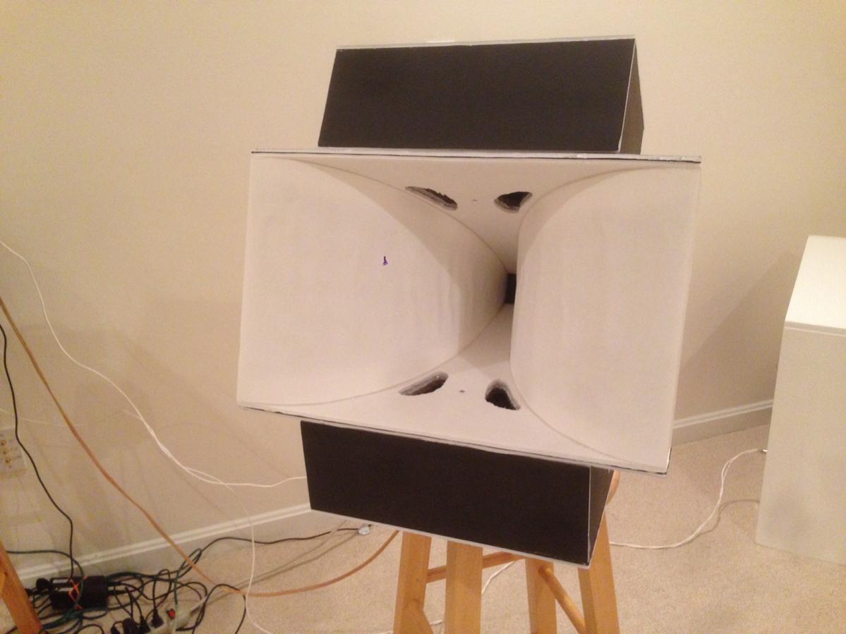

That’s cool that you knew Dr Edgar. I use his tractrix horn profiles on all my tractrix horns. Adding midbass injection ports on the tractrix make for some of the best sounding speakers I have ever made. This is the Trynergy.I can move them out as far as 5 ft but 3 is better, door on the right not installed yet but where it would have to go though with more work to fortify the RV wall I go move it 4" further out from the back wall, I will draw that in. We will not use the door except for going out to the BBQ, deck, in the right weather so speakers can be moved as needed and critical listening moved out to do their best.
