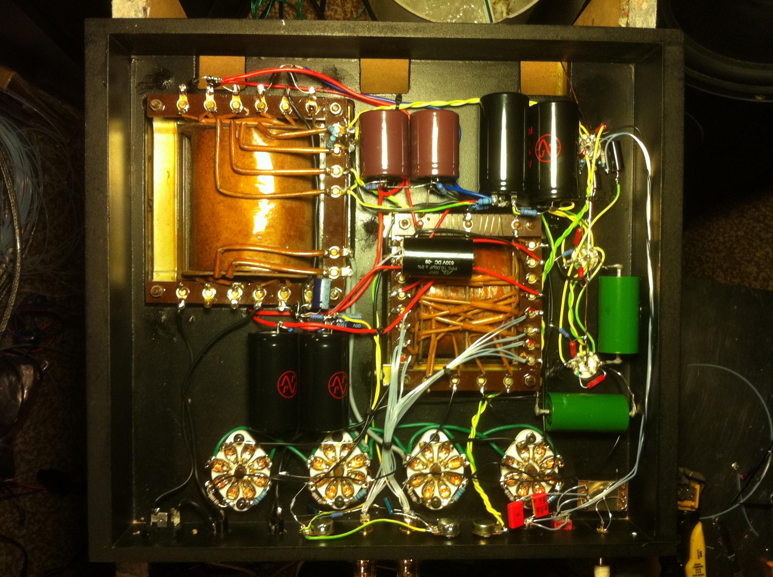

Here's the pciture of one of my monoblocks during production. I actually wanted to use vintage russian caps all over but my tech talked me out of it since the values were hard to get. So we ended up with JJ electolytic (the brown Samsung caps are not there anymore) and K75s. I also considered using K75 10uf instead of the Scr but I can't find it nowhere..
thanks for your quick response. I ordered the K75-24 since the values that i needed (0.22 and 0.47 at least 600v) wasn't available at the moment for the K75-10. I also planned to buy K40y but I ended up with K75 which suppose to have better (addictive) midrange comparing to K40y. I guess for that kind of money we talk about here, I will also order K40y just to experiment.
Nice looking build, although the fuse holders look like the side tab is awfully close to the chassis. YOu might also add rubber grommets where wires go through the chassis.

If you experience any hum issues, you might try to rework your heater wiring and twist the wires.
