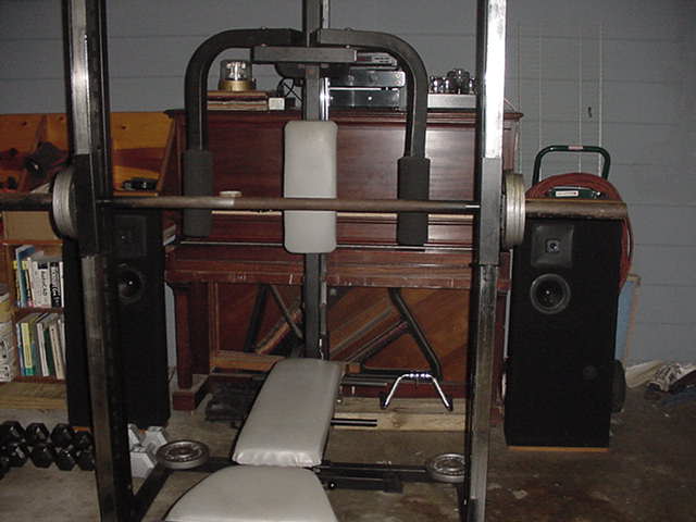

So Skippy, what are your dimensions? I see from your latest picture that you lift.
Can't say I am an Adonis or anything, but I bulge here and there. Mostly in the midsection, tho.😉 Comes from happy living and a great cook for a wife. She can take the simplest meals and make them gourmet.
At any rate, the guns are 19 inches (I know, everybody raves about my guns. Can't stand them tho. Don't do much and they grow 20%!!! Wish the chest was bigger!), chest about 50, legs not to shabby, but the gut offsets much of it. There is a real big and tight sixpack under the layer, tho. I do crunches with the pulley machine at the gym. Can bench 330 on a bad day. Squat about 1400 pounds. My legs are incredibly powerful (runs in the family... no pun intended!😉), and yet the least worked out... until recently (hence why my weight has gone up!). I weigh about 220, but if I lost the gut can be a lean 195. That at 5'6". Man that muckle weighs alot!
