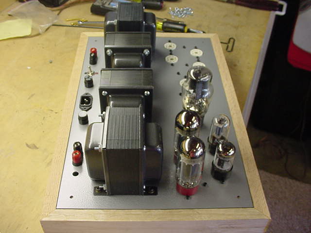

Great going, looks far better than my unfinished SRPP 6B4 SET 🙁
I have been mucking around with the circuit a little, I now use DC on the filaments to get rid of all the hum, and I have inserted a little negative feedback (not too much, there isn't enough gain) which made little difference, but seemed to improve the bass a bit. I wish I had a scope! 🙂
With regards to the high frequencies, after a few days they had definitely improved. It's all there now, much to my relief.
Next thing I will try is increasing plate dissipation on the Sovtek 6B4, up to 25W or so. Anyone tried fixed bias on a SET?

I knew it would work and it doesn't sound bad at all with the 125's. I left out the blocking cap at the input though. I think I should have put a resistor in it's place though as my preamp can drive it well into audible distortion and very loud output.

Thanks, I'm sure when you get done mucking about you'll dress her up a bit. I followed your thread on that amp earlier. Glad to see your still working with it. I will probably let this one burn in for a bit before I make any changes. I've been listening to a 6Bq5 pp for a while now and my ears are picking up a huge difference. My bass is excellent though it's probably due to my TL's. They really put out good tight bass, and get pretty low as well. I can't wait for the high's to catch up.
The 125ESE's will get you going with SET. After that you can always move up to better. I probably only have 300.00 in this amp. To me that's pretty cheap for SET.

I've been running it all day while I build on the 6L6 push pull. It is really starting to smooth out really nice now. It is an en excellent amp with extremely high detail. I can just imagine it with some good iron. I can really see what the hype about SET is all about now. Looking at some of the other 2A3 designs I had no doubt it would work. Why the 12AX7 though, why not the 6EU7 or a 6SL7 driver? Just curious. I built the amp with the filaments set up just like the plan and get absolutely no noise what so ever out of my speakers. I havn't done any measurements though. Thanks again Gabe!!!!!!!!!!!!!!!!

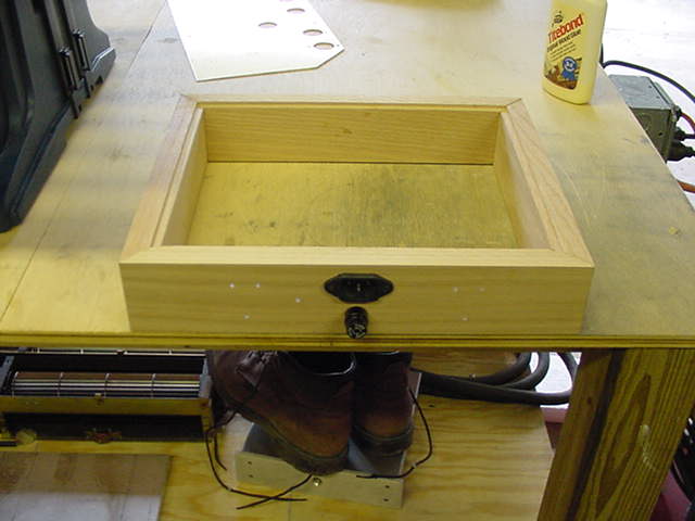

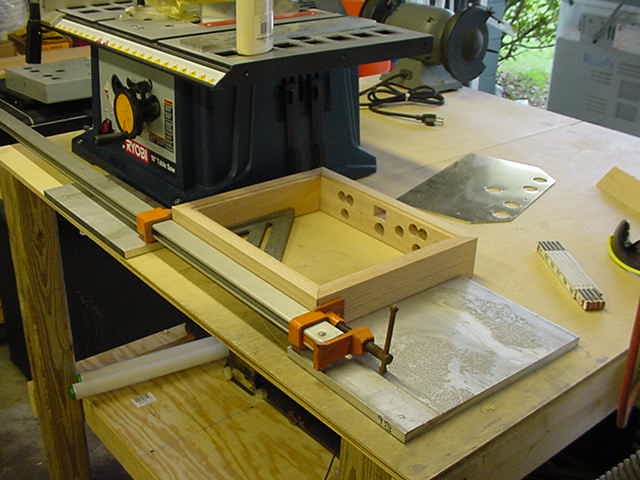

The trick is it's either right, or not right. It's yes or no, there's no in between. Your cuts and angles are correct or wrong, and no amount of fudging or wood putty will make up for a wrong cut.arnoldc said:nice woodwork! i hope i have the skill and equipment to make one like that 😉
To summarize the Waterboy's biggest fan "YOU CAN DOO IT"
