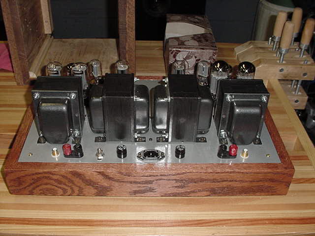

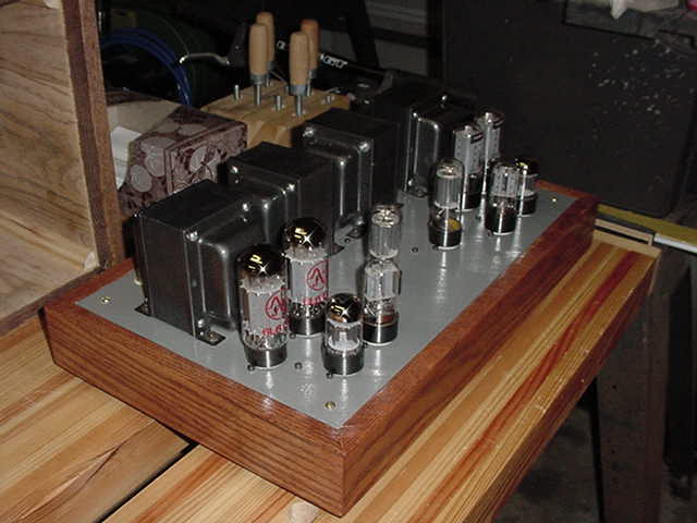

Hi Gabe, long time, never seen, this is the 6L6 p-p ultralinear at the tubecad site. I've been fiddling around with some other stuff and finally finished it. Here is the link to the scam http://www.tubecad.com/Classic_Articles/page5.html
Raja, here is a peek under the hood.

Ah! Fullly differential circuit! Let us know how it sounds. Been wanting to play with this circuit for a long time, to see how it compares to my MAG.
Of course... the diff circuit is supposed to be zero even order harmonics. So it should sound solid state.

Well, I've been listening to an Adcom GFA535 for the last two months so my ears are out of wack (I hated it). I can tell the sound of tubes again as the sound has smoothed back out a bit and I no longer cringe. There is something not quite right and it may be due to the fact that I had a problem with one channel and have different values for the coupling caps on that side as well as different output tubes because I dropped one of a matched set. I put in 47K in series on the input because of a buzzing sound which I thought was an overloaded input and wound up being a loose screw on a speaker grill, so I have a bit of tweaking left to do and a punch list to go through but I will let you know. Right now the bass is good but not taught, good midrange detail and smooth highs. Sometimes the vocals sound a bit nasaly and it may be due to the extras in the circuit or the mismatched coupling caps, I don't know.

Hey Pf. You should be proud of this thread. Some great information and pics with both your builds.
Great amp! I've looked through this whole thread and didn't notice any schematic. I know it's kinda old, but is the schematic here anywhere?
