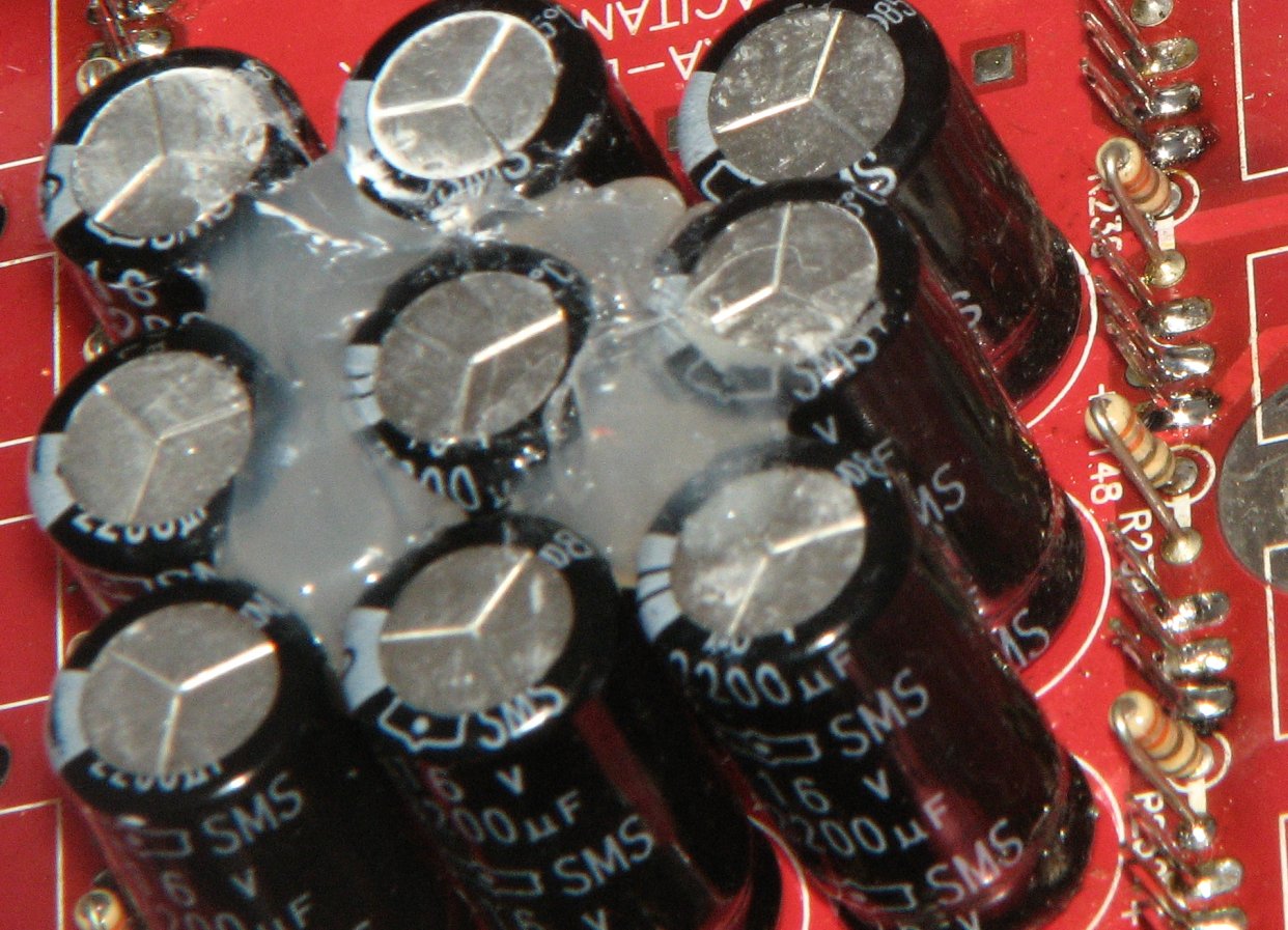

Since it's 25 years old though, thought it would be good to check/replace caps.

When I pull the amp from vehicle I may take off the bottom and see what caps they used, I'm guessing all builds used the same.
Seems fitting to replace caps with Rubycons, since it's a Rubicon amp.

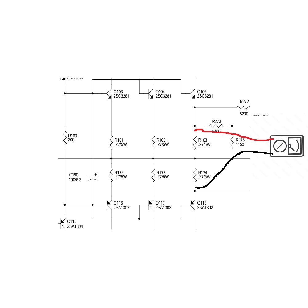

If I remember correctly, a guy that worked at Soundstream told me to check for current hogs... He said to check the voltage across each pair of emitter resistors, the voltage should be equal. If not, check the individual emitter resistors to see witch transistor is pulling too much current. try to get the final output trans to be fairly equal.

Yeah, the builders were supposed to remove any hogs and replace them. Apparently they skipped those steps, because the reviews on this amp all say the same. It runs too hot and draws gobs o current.

This is what a tech wrote me from SS...
To check the bias for each output pair, measure the voltage from emitter pin (TIP102) to emitter pin (TIP107) for that pair. NOT across just one resistor. You want to measure across BOTH emitter resistors. See attached. Also, double check the pretest and final test docs for correct voltage range. If you find a pair that is higher than the rest, then measure across each emitter resistor to find the current hog and replace that device. The one with the higher voltage is the current hog. Also, check the emitter resistors too. They can open up on you.
