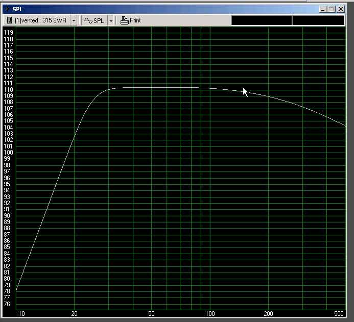

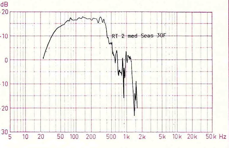

Looking at some alternative solutions...
Enclosed is a frequency plot done with WinISD with a Peerless SLS 12 in a 230 l vented cabinet. (about the same volume as the RT-2 horn)
http://www.mamut.net/dynabel/subdet329.htm
At near maximum linear excursion, the plot shows a flat response down to a -3 dB at 23 Hz
I guess a horn would have to be pretty big to do the same..
Of course a horn might play 20-30 dB louder, but i guess 110 dB will be acceptable for domestic use anyway.. :)
I've read that the SLS woofers are only suited for closed box, but the data sheet states that extended response can be achieved in a vented design of 55-75 L..
Again, the sim I did was for an enclosure significantly larger than that.. Am I missing something out here, or might this driver actually work as well as it looks in such a very large BR enclosure??

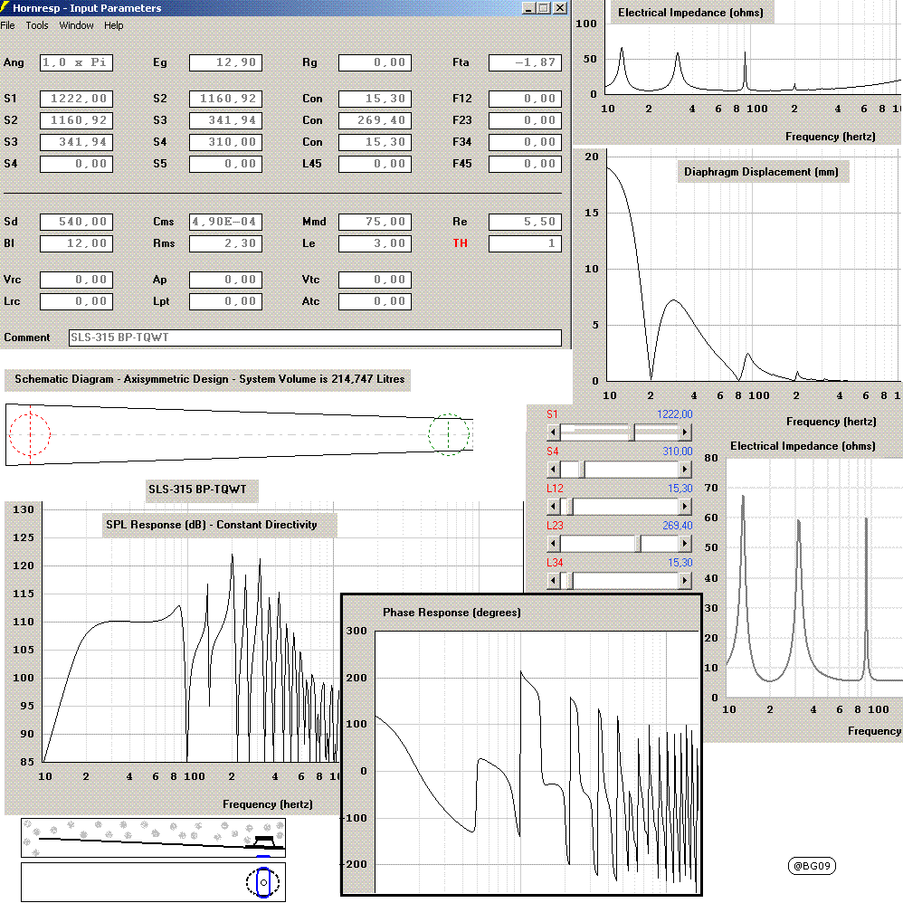

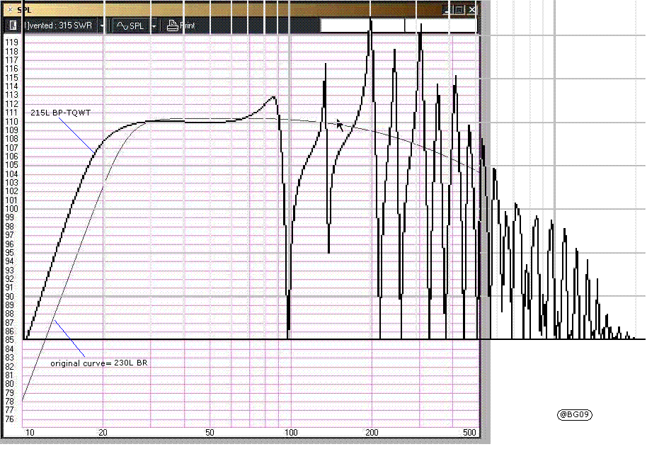

Hi Elbert,
You are right a horn would be huge but not if a BP-TQWT, See picture 1(2).
Actually the 230 L BR box you mentioned can be compared to the about 215 L simulated BP-TQWT in picture 2(2) where the difference can be observed.
Note: A BP-TQWT is stuffed like an ordinary TQWT and the ripple over 90 Hz is negligible (IME) if simulated as can be seen using MJK:s TL programs with about 8 kg/m^3 stuffing density.
IME. A tapped horn with a series inductance or not/ BR-box has much lower SQ than a BP-TQWT that is FR QW extended, traded for BW from mid-bass efficiency.
IMO 110 dB is more SPL I heard in an ordinary living room that I could copy with.

wow.. that was interesting!
Looks like the classic transmission line to me! :)
Been a while since I've looked in to that by the way..
But heck, this thread is really starting to de-rail now..:shutup:

Looks like the classic transmission line to me!…
Yes, it’s very similar but there are a difference that makes it possible to acoustically filter out some of the speaker driver generated distortions that are not present in the input signal, especially in the upper bass. (80-160 Hz).
I’ve compared TQWT’s with BP-TQWT’s using the same drivers close to x-max and found that the sound is produced/heard differently: TQWT’s sums at far field while BP-TQWT’s always at a point in Nearfield = the port.
Of course there are TQWT’s where the port is very close to the driver entrance and if the driver generated buzz and rattle/ distortion is low its hard to hear any difference, but IME only expensive driver types with very stiff cones (aluminum) and large x-max works satisfactorily.
My surprising experience is that ordinary (inexpensive) stiff paper coned drivers in a BP-TQWT are if designed with care almost behave blameless near x-max but not in other BR type of boxes.
The speaker localization que(s) are IME heavily attenuated if a BP-TQWT equipped with a suitable placed port, if you compare the two types the advantage is easily recognized.
b

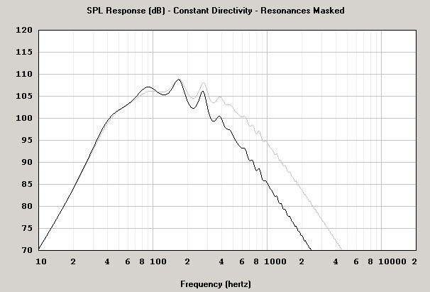

After some tweaking with the active X-over, EQ, and general levels, the Horn is starting to work really well..
Since its running with the SEAS woofer from the right speaker, tweaking and tuning is not optimal so to speak.
But the sound is now what I would best describe as dry, deep and tight..
Listening to some classic Motown tracks, the fender-bass with flat-wound strings, complete with "live" studio reverberation, it really shines!
So I've decided to try and find a suitable woofer and then perhaps build a sub-EQ to fine tune the horn electronically. With the 10 band parametric I have, there's really only the two, perhaps three lowest controlls of 31, 63, and 126 Hz that's usable.
After a heap of iterative hornresp sims, it is becomming evident that the selection of suitable drivers is very limited.
So far, the sim that gives the most promising result is actually the SEAS 33F-WB!
the gamma LA1231 is very close except for seeming to be a few dB below the seas at 35-45 Hz (not by much though)
The advantage of the gamma is that the response is smoother further up than the SEAS. This is probably due to the very low cone weight, all the sims I have doone seems to show a very strong correlation between cone weight and ripples in the response curve.
Enclosed is the plot for the SEAS driver with the gamma curve superimposed in grey.
The strength of the SEAS is that it has 2mm more of linear excursion over the gamma.
But the biggest drawback of the gamma is that the integrity of the data I have scraped together may be somewhat dubious and the fact that its origins and quality are a bit obscure...
So that leaves me searching for an extra SEAS 13" woofer (hard to come by as they went out of production in the mid 80's), or any modern equivalent....

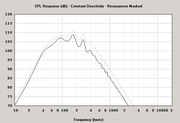

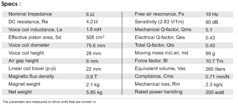

Thanks for the suggestion tinitus!
Low frequency extension comes out significantly better than the SEAS 33F-WB.
But unfortunately, the heavy cone (I assume) causes a more ragged response which will probably make integration with the stereo speakers more challenging.. (?)
I've attached the response from this SB Acoustics driver superimposed in gray over the SEAS response..
The perfect driver would probably have the smoother response of the seas driver and the low end extension of the SB driver.

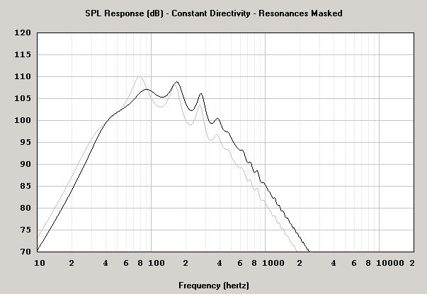

And following this up..
I modified the moving mass of the SB driver from 99 g to 35 and did a new sim.. And the result from that was in deed excellent looking..
A driver (if it existed or were even possible) with that response would certainly be worht trying.
Enclosed is the response superimposed in grey over the SEAS again.
