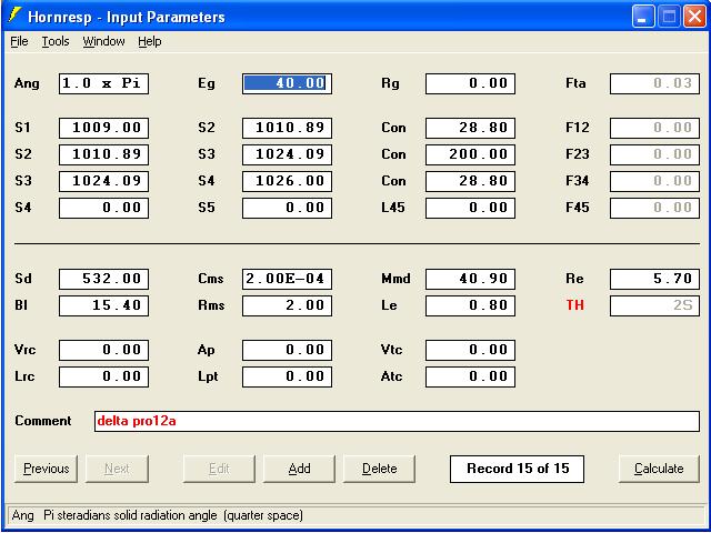

I think something is wrong if you cannot get 40Hz out of your horn. A sim that include the whole horn path as well as measurements should clarify the situation.
I thought the added smiley should clarify my intention with my recent post 😉
I would not write so nicely about the RT-2 horn if I had not built and listen to it myself. I really like the sound it produces, low distortion and a fast stop (essential for me).
No malice intended in my reply to your previous post, quite the contrary! 😀
The reasoning behind not adding the last "external" section to the horn model I have "borrowed" from Bjornos post, was that this was actually calculated in by hornresp due to the quarter space boundary condition.
I must however say I'm not 100% convinced about this, but then again, with low frequencies and room interactions, it is sometimes difficult to draw the line...
Well, I've not given up completely on the horn yet, after all, the swap from the ill chosen Delta pro to the SEAS 13" revealed that this horn may yet have potential to be realized through selecting the right driver..
Having taken a closer look at both the gamma and the visaton, their relatively limited Xmax has given me some second thoughts, as this might not only limit them in the horn at lower frequencies, but also for secondary use in a conventional enclosure... A peerless SLS woofer with 10mm Xmax might be a more interresting option in that respect..
http://www.mamut.net/dynabel/subdet329.htm
