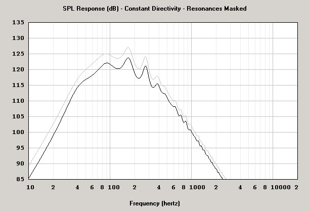

Looks like I'm drawing nearer and nearer to the end of my search for a suitable driver solution to the horn..
The only thing I've found so far that clearly surpasses (seemingly) the performance potential of the old SEAS 13" I've temporarily installed, is a pair of new SEAS CA26RE4X woofers...
But this is not by much, and the price of these two new drivers would be considerable..
Enclosed is a plot of showing the dual SEAS 10" alternative superimposed in grey above the black curve of the SEAS 13", both driven to Xmax.
The dual 10" option is only a few dB above the 13" which also has signs of a very modest dip around 60Hz.
As my stereo speakers, one of which has temporarily donated its 13" woofer to the horn are some 31 year old kit-speakers which are not to exciting anyway, the best option is probably to take them out of service and use the 13" woofers for the horn (one in spare).
Then I can spend the money building a good set of stereo speakers in stead! 🙂
That has crossed my mind too, but dare not say...whether it would be better put the effort into your mains...it makes sense
Besides, in most of your sims I dont see much difference between the various drivers, other than different output
It has also been stated several times that those sims doesnt tell the whole truth
You have experienced a substantial improvement with your old 13" Seas, and probably cant reasonably expect any better than that...proven in real
True true, as discussed earlier, these sims don't show the whole trught, and there is certainly more low end response in my livingroom than what the sims indicate..
True, there is a slope to the response curve, but not so bad that some moderate EQ can give good results. This is again where dynamic headroom come in to the picture, with 114 dB uncorrected at 40 Hz Xlin, one can EQ quite a lot and still play at respectable levlels.
And that's where the SEAS 33F-WB seems to excell..
All woofers I came across with low Fs and good Xlin, had high moving mass and low Vas, inevitably giving a very rippled response in the sims.
And those few woofers I found with low Mms and high Vas had limited Xmax, typically around the 3mm mark.
The seas seems to have all the right stuff.. plus an unsurpassed Xlin of 7mm. I also tried simulations with the other 13" seas woofers, none seemed that good and they only had a Xlin of 5mm.
Strange to think that the first driver I tried after the ill-chosen delta-pros were to be so spot on! 🙂
well, at least i considered (a lot) of the alternatives, and If I go for the SEAS 13" woofers, I guess I can do so with a certain confidence that I didn't exactly overlook any obvious and superior alternatives..
Looks like the money is going in to a decent side system.. 🙂
