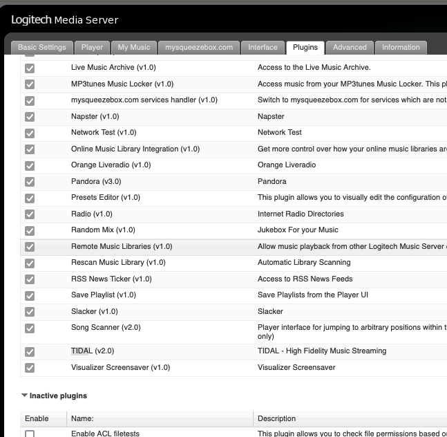

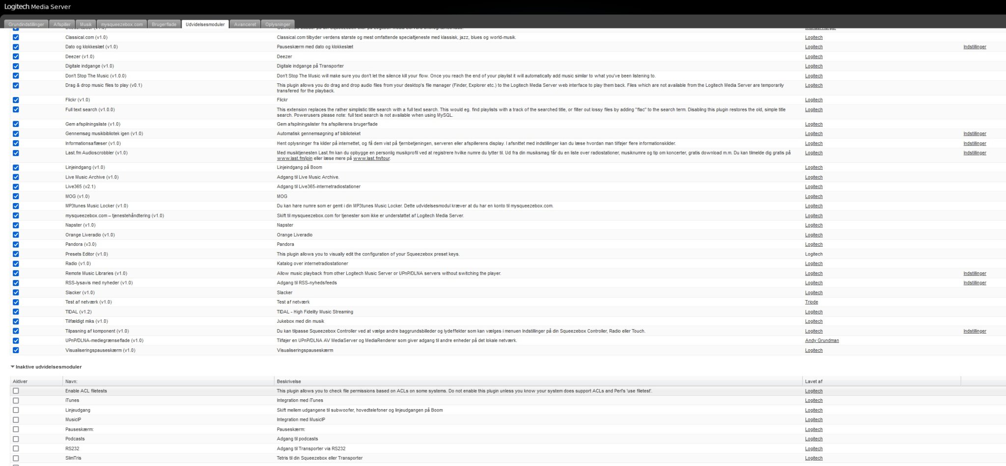

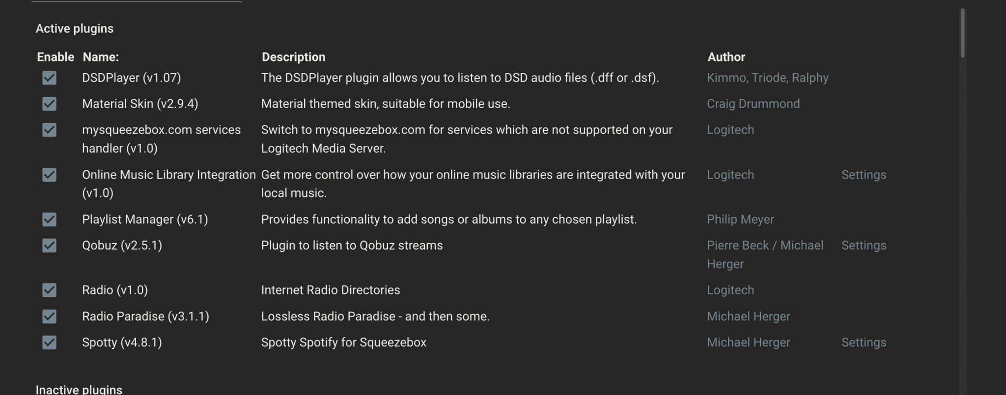

Ok... had it playing. It just skipped sometimes. I then remembered something about cashing... adjusted that.... but then I forgot the account was old and that I made a new one. Dialed that in. Now it won't accept my account details.
Then I looked it up. There is apparently some known error where Qobuz does not allow for login to the webplayer. And you just have to wait for some time-out somewhere(server maybe). And then it works again. 2 days, some report.
Am I missing something....?
Ok... now it works.Using Squeezer on my Android phone. The UI is a little simple... but on the other hand, everything works perfectly 👍
Thanks to all patient participant's - have not been my best day, so happy that it finally just works, and I now can end the day with lovely music before bed 😊
