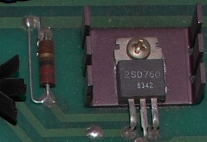

Seen the wire ? =>
jacco vermeulen said:
Seen the wire ? =>
Yup!
There are enough of those revisions (cut traces, parts mounted off the PCB that were originally going to be on it, large parts mounted on the underside of the PCB because of insufficient space, etc) to suggest that these early examples were not really ready for primetime. A simple PCB rev would have significantly cleaned things up, but who knows. Maybe issues were discovered after the amps made it into the field.
It would not be the first time that's happened with high end electronics!

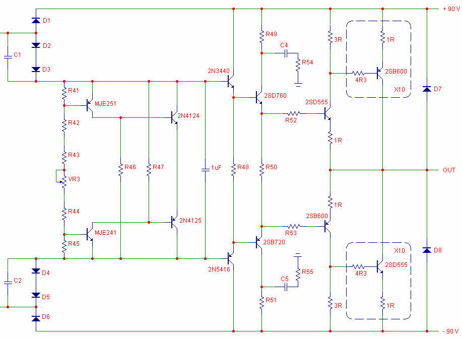

I won't have a chance to do much listening for a bit, but I have drawn up a schematic of the amplifier minus the input stage for now.
I'm sure I have made some mistakes but unless I'm incorrect VR3 is used to adjust bias.
Your Model 5 bias of 55mA-80mA per device seems to jive nicely here.
