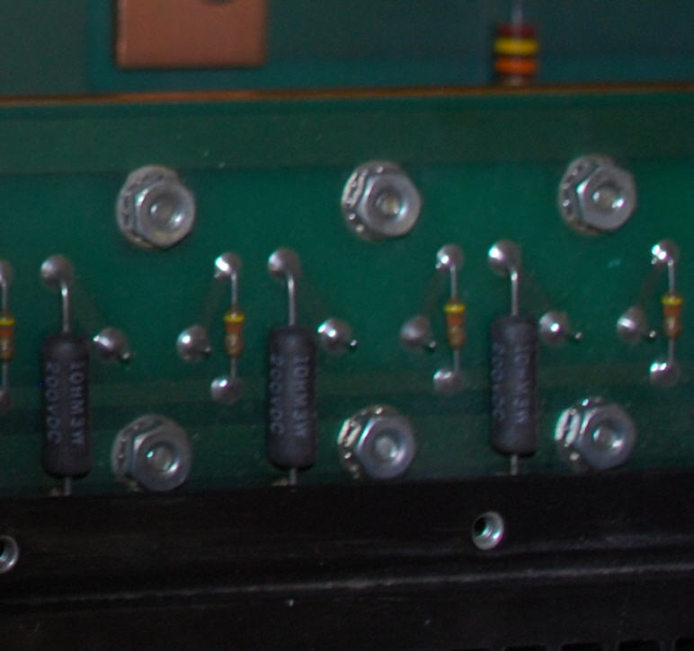

You don't need to match devices, and the 1 ohm Emitter resistors are more
than adequate to cover the current sharing.

I would pretty much Take nelsons work as gospel! 1 ohm emitter resistors is pretty big. I normally see ..33 to .47 an average some some being .1
ONE ohm is pretty rare and i would think pretty loose tolerances will even out with that big of an Emitter resistor.

As for sending back the output stage/heatsink for repair...I don't think this is necessary as it looks like the repair will be straightforward. The other comment I can make on these early amps is, how do I put this politely, that little thought was put into disassembly for servicing.
Just getting the output devices unbolted for testing was a chore.
The support rail for the top cover would not allow a nut driver to be used on the TO3 nut closest to this rail. Plus there is very little clearance to each emitter resistor to get a crescent wrench in there!
See the photo below:

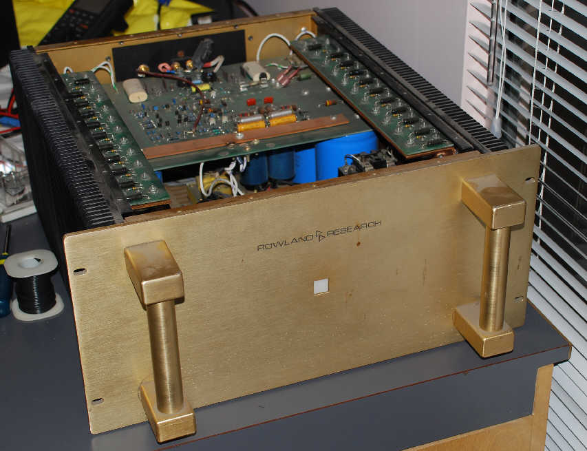

ungie said:
I'll get around to measuring the output device current on the functioning monoblock sometime today.
I made a few measurements of the working monoblock this morning.
Output DC offset hovered around 10mV with a small 1kHz sinewave input applied.
Voltage across the output device emitter resistors ranges from 30-36mV on both + and - sides of the ouput stage.
So, does 30-36mA per device sound reasonable or too low?

Hi ungie,
Looks nice except for the coffee stains on the face plate.
DC offset and bias currents are always measured with no load attached and no signal applied. The amp has to warm up and settle in before taking readings. This typically means the amp is idling for 30 ~ 45 minutes. The other way to do it is to drive the amp into a load until it warms up, then disconnect the input and load and wait until everything stops drifting.

Unfortunately pictures can be deceiving. 🙁
These amps have had a hard life and the faceplates, handles, and top cover are in bad shape with lots of small scuffs and bumps. The heatsinks also have a few blemishes.
Once I get both up and running and have evaluated the sonics, I'll decide if it's worth the effort of stripping the chassis and having all the parts re-brushed and re-anodized.
Your comments on the offset and bias are noted.
I have no idea why I forgot to disconnect the input!
