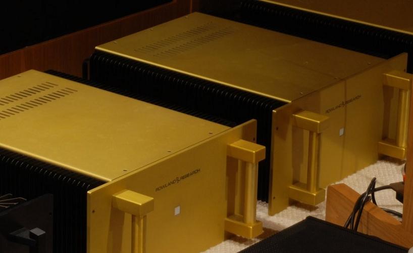

Interesting...the pair I am looking at are the same finish but MUCH earlier timeframe.
I believe that the Model 7 went through 3 series revisions over it's lifetime and this pair is the earliest.
In fact, it looks to me like this pair is part of THE earliest edition as there are no potted modules anywhere on them.
The input circuit is clear to see on one large PCB which is mounted on top of the main filter caps.
Not exactly an arrangement I would go with, but at least performing some diagnosis on the bad unit won't be difficult.

The power supplies are increadibly massive and there is a separate turn-on circuit PCB with HUGE relays to apply AC.
From looking at the burn marks (2 areas) on the underside of the chassis top plate it looks like the bias resistors on one NPN and one PNP output device gave up their lives.
If there is interest here I will take some photos as I dig deeper into these beasts.
The chassis are in pretty good shape but will need some clean up.

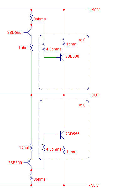

The output stage uses 10 pcs each of NEC 2SD555/2SB600 in TO3 cases, 1ohm Ohmite emitter resistors and a single NEC 2SD555 or 2SB600 as a driver mounted on the common heatsink rails as the output devices themselves. The driver for the NPN output devices is a PNP and vis versa.
The amplifier has three separate power supplies with their own transformers, one for the soft start circuit, one for the input and pre-driver stages, and the massive main output stage supply which has two potted toroids (at least 800va each) and 6 x 21000uF, 100V supply caps.
The good news here is that the main supply can be easily disconnected along with the driver/output stages while having the complete input stage powered up and running.
I'll start signal tracing and measuring the driver and output devices on Monday.
If I do happen to find any damaged output devices, what is the best course of repair?
The original devices are probably unobtainium and I'm wondering if a few replacement devices will work along side the originals?
Otherwise it might be an expensive proposition to replace all 20 output devices with new equivalents but there is always the possibility that new devices will sound better! 😎

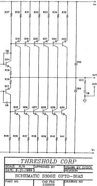

Old Crest PA power amps use the D555/B600 devices. and in those amps, when one output devices blows, THEY ALL BLOW! making them very expensive to repair. And those devices are no longer made (as far as i know) so finding replacements and enough replacements to get them matched is a pretty big challenge!!!
Those devices have been used in many things and some really good sounding amps too! they just seem to be a bit touchy. a shorted speaker cable even for a half second can blow an amp to pieces so who knows what happened.
The first thing i would do is a check all the output devices for shorts. If you find devices that are shorted then check the emitter resistors. they will most likely be blown too. good idea to replace them even if they aren't blown. and don't replace just the bad ones. replace them all so they match if you can't find exact matches to the factory resistors.
If you find only a couple of blown outputs, you might then be able to construct a matcher ALA PassDIY and use the remaining good devices to try and find matches out of a few new devices. or at least figure out the matching tolerance etc.

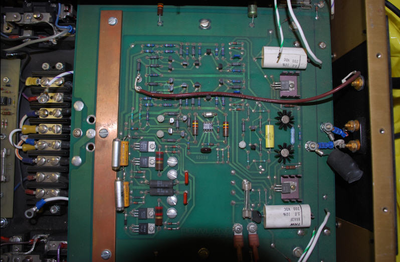

ungie said:Photo of the main PCB, for those interested! 🙂
mlloyd1 said:what Rowland amp is this from?
doesn't look at all "Rowland-like"
mlloyd1
Original first version Model 7 monoblocks.
These guys are likely 20 years old.
Better make that ~25, the 2nd edition is from around '87.
i'll bite my pinky finger off for a couple of close-up shots of the main board.

I have pulled the driver and output devices and there are a couple on each rail that are bad and their respective emitter resistors are also toast.
For a quick check on the functionality of the amp, is it safe to run the output stages with the bad transistors removed, i.e. with only 8 output devices running per rail?
If this is not recommended, what is the best plan of attack for determining good substitutes (2SD555/2SB600)?
And an earlier question still lingers: Can I replace only the bad devices or will there be matching issues?
If I go nuts and replace ALL of the ouput devices do they require matching?

Can you use the output section with the blown transistors removed? I guess you can if you intend to use loudspeakers that are a rather easy load , don´t dip that much and aren´t current hungry. But a justified question remains; what made the amp brake in the first event?
Matching is a good thing with many devices sharing the job. But the one Ohm emitter resistors do a part of this job. With no matching there is the risk of higher distortion at least. NFB can´t cure everything,
It´s possible that with time the once matched output devices have become different and this may be a problem to solve?
But it´s possible to do some measurements like an easy hfe one.
Or at least check the quiescent current for each device.

Some possible notes.
I recognize the board shown as an older version (from having one open in the early 80s).
The one I worked on was different, it was a trade show sample and was being upgraded to the latest revision by Jeff and his tech (circa 89). This one ran the output stage open loop (similar to the Threshold refered to above.
I think these do require matching of the devices for lowest distortion (since they have no global feedback). For an 'easy load' you might be able to get away with running less than the full ampount of outputs, and I like zero's suggestion of pulling them in pairs (one N, one P).
