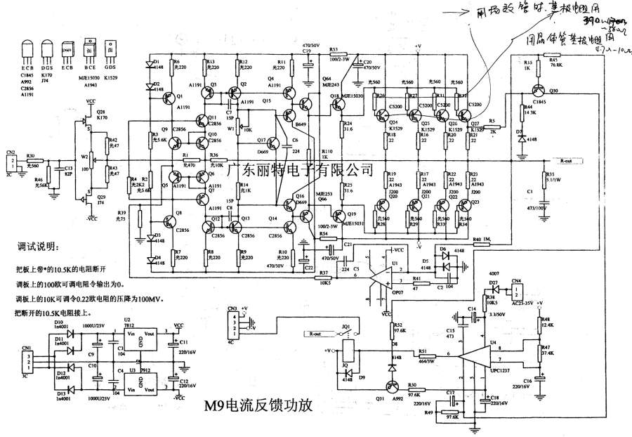

I am wondering if anyone has experience with any of the early Jeff Rowland amplifiers? I have a line on a pair of Model 7 amplifiers but only one of them is functional. The other is complete and the power supply is working correctly but there are a few bad output devices. Rowland is not willing to supply a schematic and I would like to investigate repairing it myself.

georgehifi said:This may help
Thanks George!
I'm sure that schematic will come in handy!
?? why? it is not the correct modelThis may help
OK - this was quite awhile ago and I may be remembering a different model the 3s perhaps but I think the models were all similar.

This is why I said this may help. If it doesn't, no problem everyone get's another circuit to file away in their stash.
