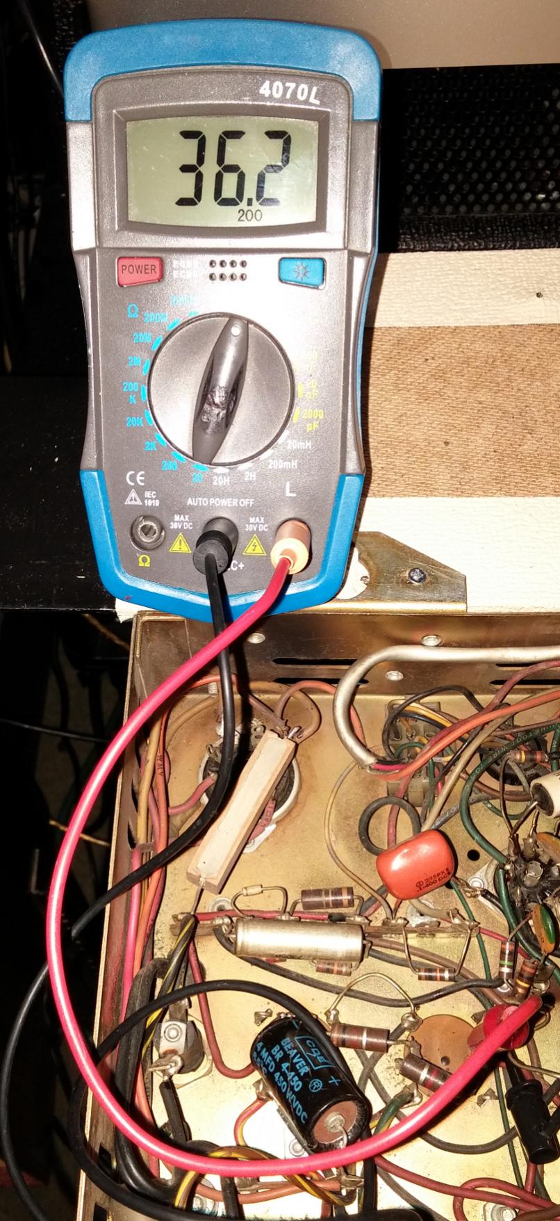

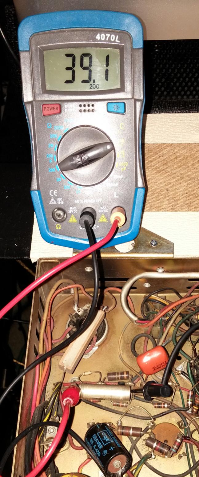

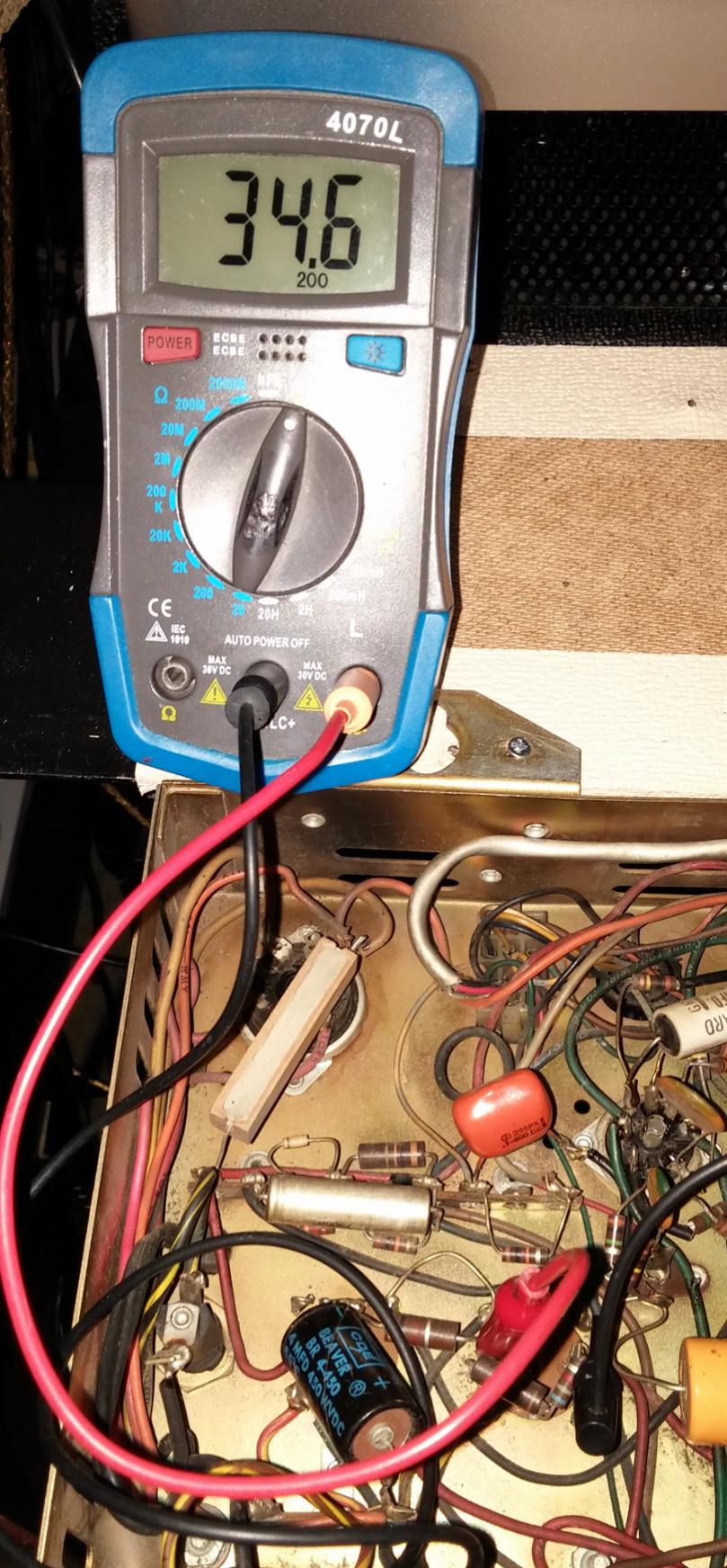

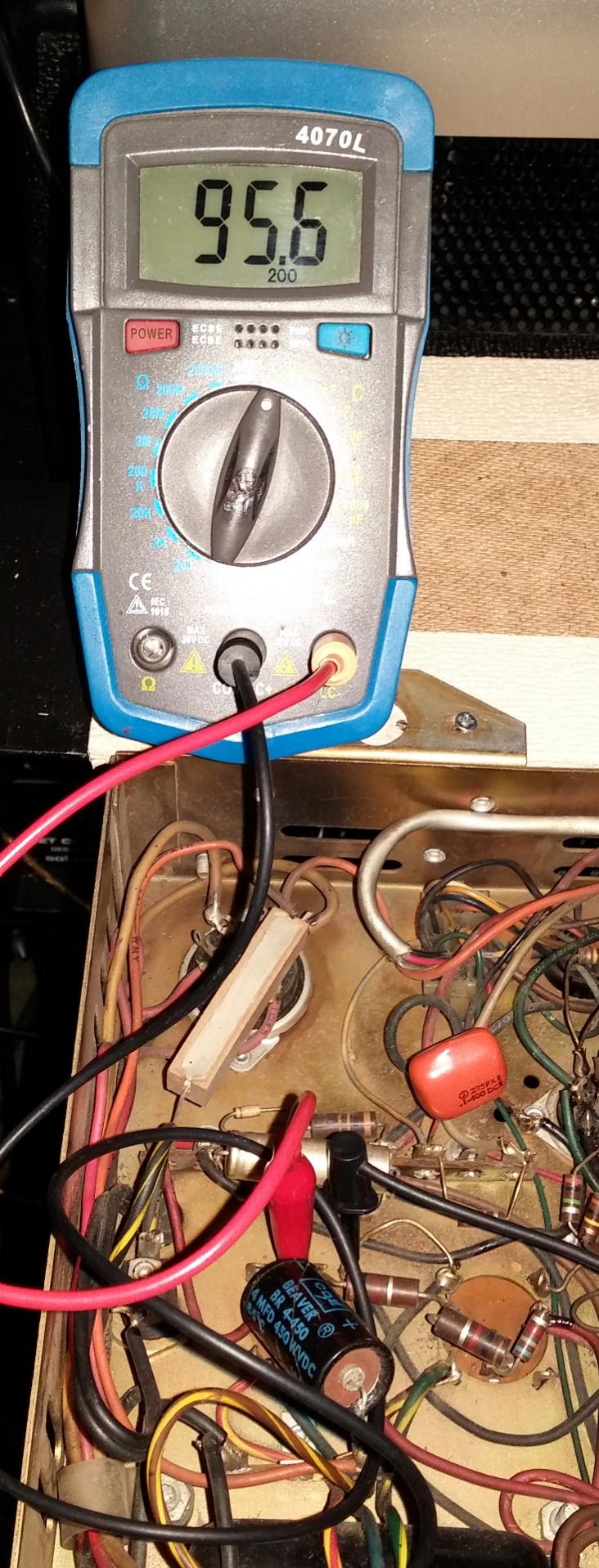

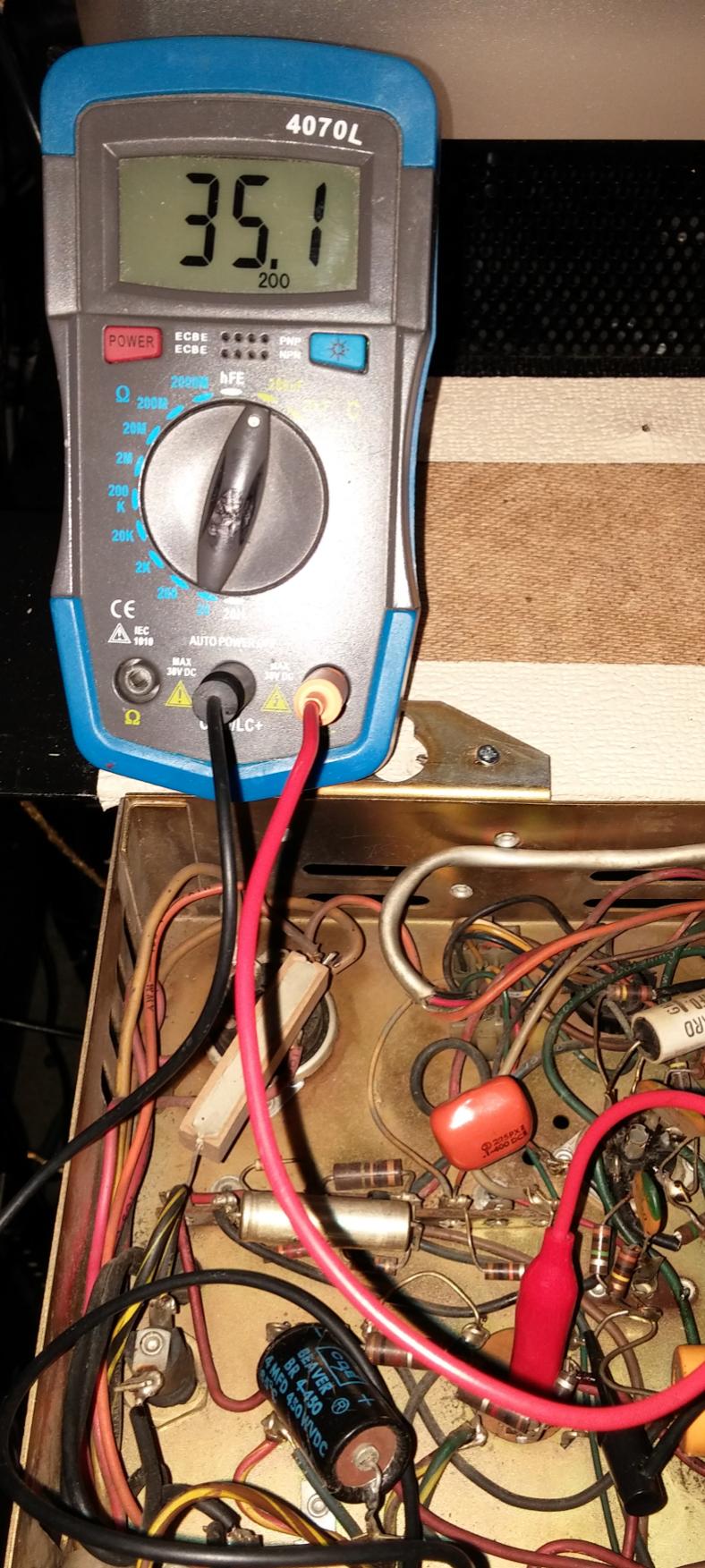

OK. I have just tested the cap values. The cans all check out. c906 does not have it's value.
File name corresponds with cap under test.
