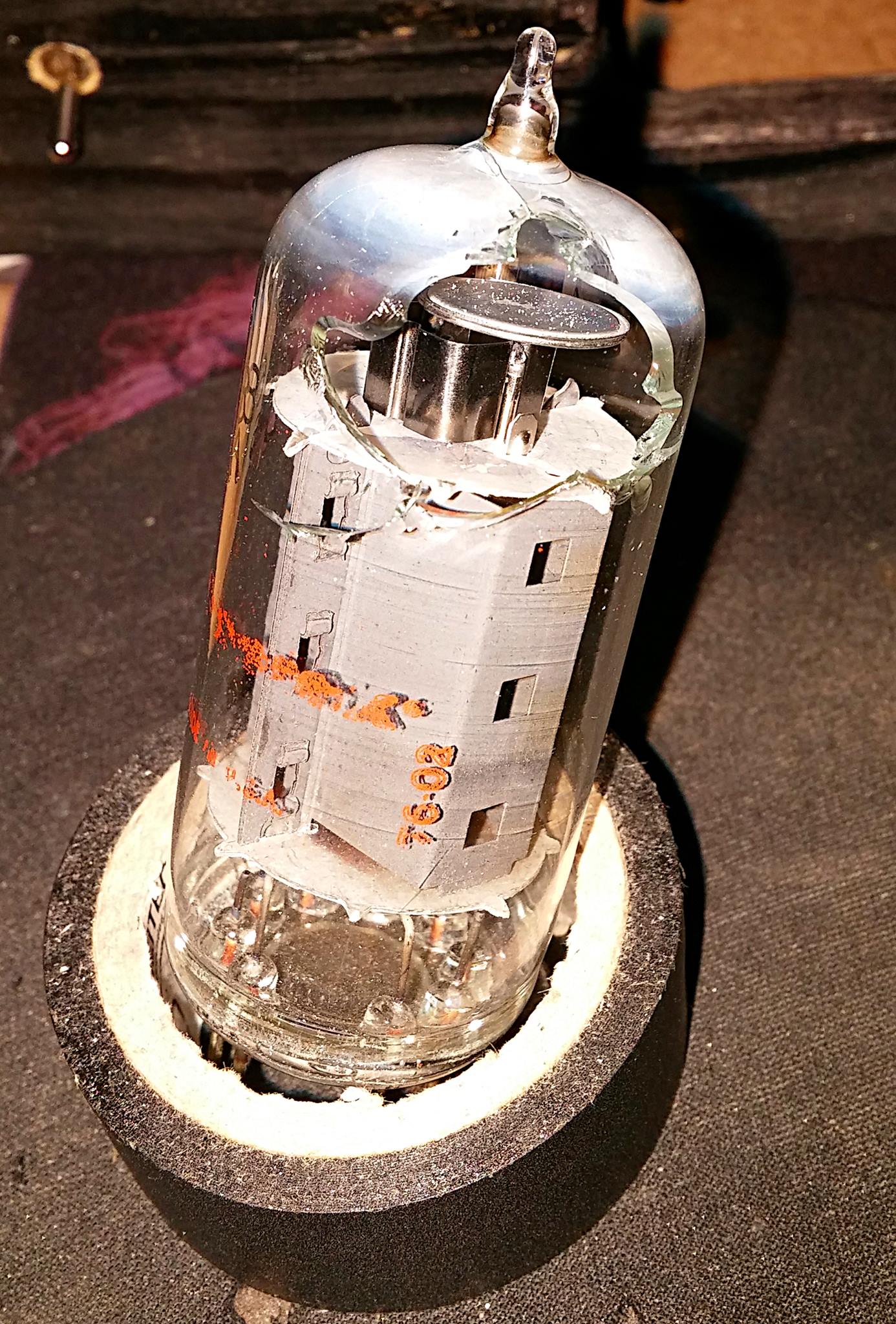

OK. I'm a damn idiot. The project is on pause until a new tube arrives in the mail. :mad:

OK, looking at the 7868 prices, I'm being swayed into doing the 7591 conversion. Either by a quartet of these 1piece Gold Plated 7591 Adapter Top to RCA 7868 Tube Converter Adapter | eBay
or soldering in 4 8-pin sockets. On average the 7868 tubes are $25 each and the 7591 tubes are $10. I just bought 4 NOS Sovtek 7591s for $39.99.
So unless I get the preamp for this guy, I'm gonna go ahead and get rid of the unnecessary stuff like the relay and volume switch.
This is still up in the air. I may still just buy a 7868 if I can get an Amperex at a good price. I can even find one, period

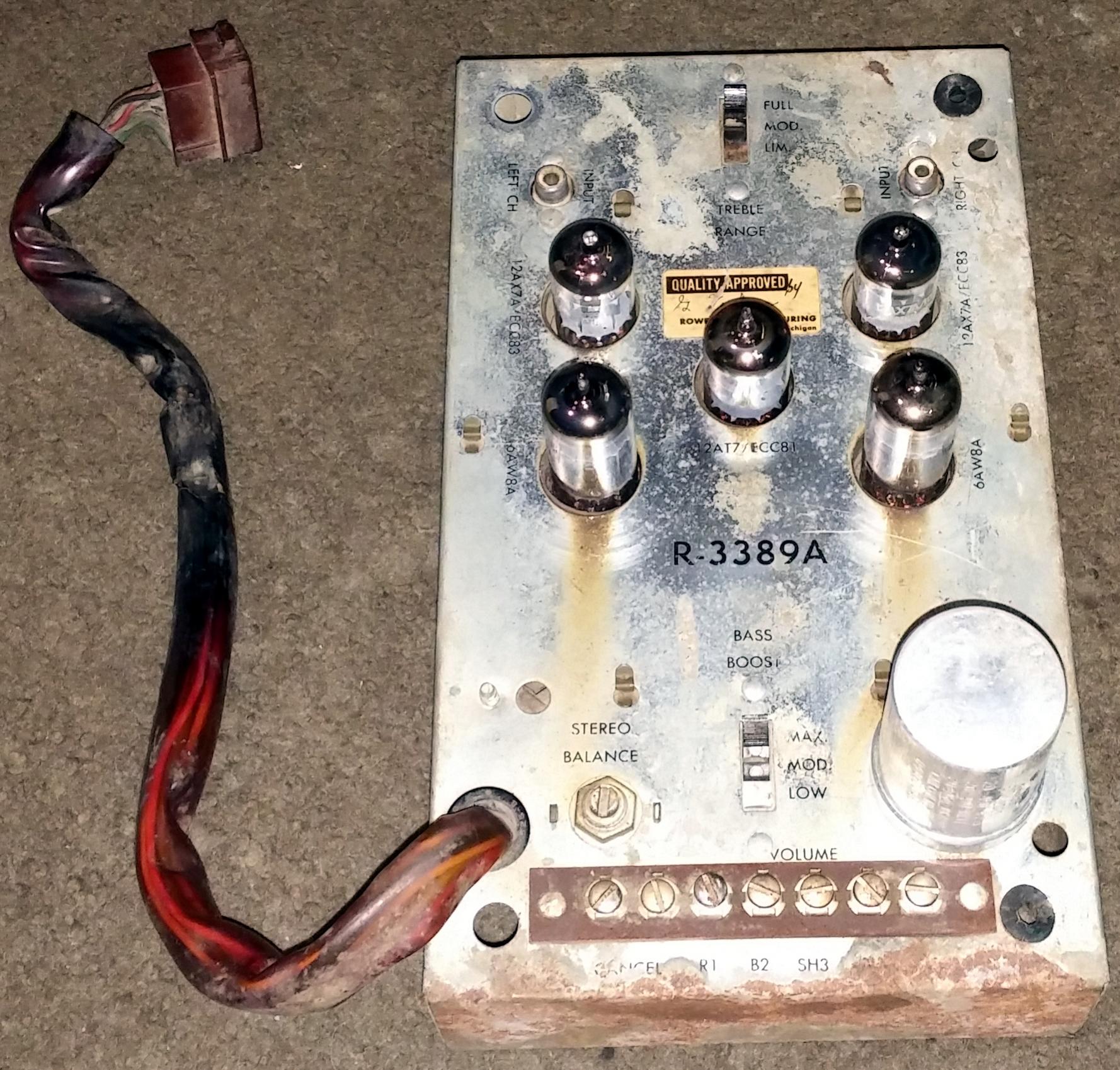

OK so, check it out...
I picked up the R-3389A preamplifier off ebay for $28 shipped with the tubes. It's seen better days but it's got it where it counts. The seller said he tested it and it works. Even if it didn't work, it's worth that in the tubes alone. So I guess I'm gonna stick to the original plan. I just want to find an Amperex 7868. Having a hard time.

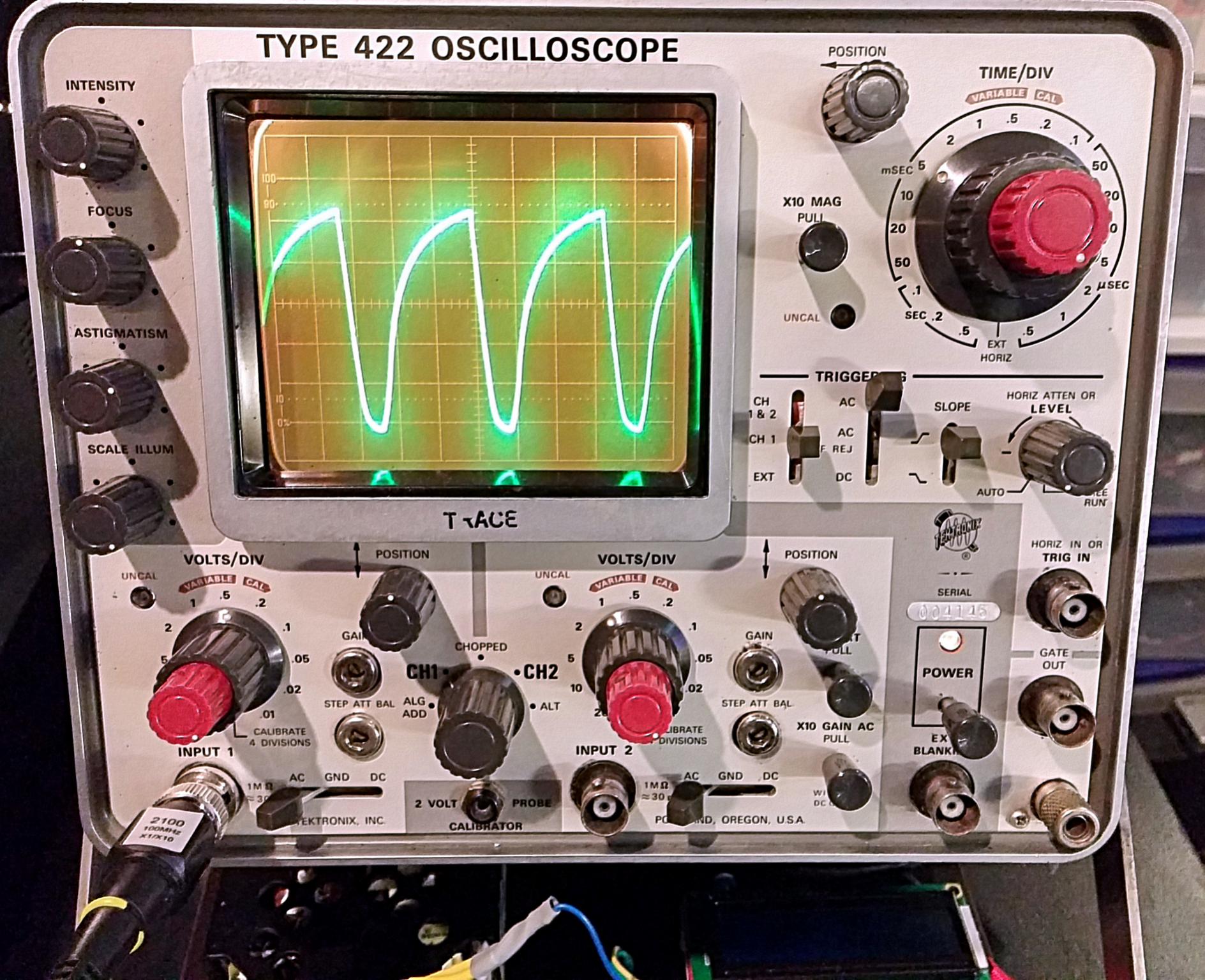

..and going back to one of your replies, should I implement some of these ideas with the oscilloscope?
You measured 600 Vac at 4 and 6 of the 5U4, if you measured this with a reference at the chassis then it was 2 x 300 Vac and that is correct. Normally you do all measurements with one lead at chassis level.
When this is correct your outputvoltage at the first elco shoud be about 350 volts DC. This depends on current consumption, Ri of transformer etc.
When your first capacitor is bad, there is a high ripple voltage there and the avarage voltage there drops.
Please measure with your oscilloscope the ac ripple voltage there. Use a probe that can do this (1:10) and show us the result.

Unfortunately, I am learning this oscilloscope, I'm am not sure what setting to use to look for ripple. Here is what I came up with, let me know what settings on the scope to use.
C906 / probe @10x to chassis.
