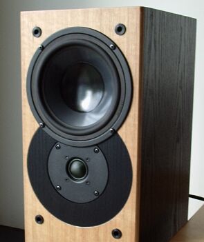

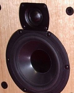

Hi Rabbitz,
Nice portrait you got there 😉
Did I understand you right!?
You flush mount the tweeter, and let the mid/woofer physically overlap, to get the units as close as possible!?
Doesn't the edge of the mid (partly?) spoil the effect of flush mounting the tweeter?
...or isn't the flush mount (in terms of less reflections/difractions) of the tweeter neccessary in your oppinion?
Hi Jennice
Like the self portrait hey. 😀
There those that state that diffractions are insignificant as they get swamped in a room anyway but IMO, that's no reason not to try and get rid of them.
It's all a matter of compromise, as most of speaker building is, where the builder's priorities are, their own personal quirks, the application. I tend to place more importance on getting the tweeter to mid/woofer centre distance to suit the wavelength of the crossover than the diffractions. If the crossover is low enough, I will make all efforts to meet this requirement as I do believe it pays off with better imaging. A few manufacturers such as Dynaudio, Kef do the same thing by overlapping drivers so I'm not totally nuts. I still like to have a tweeter rebated and even if part of it is spoiled by an overlapping driver but not all is lost as every little bit helps.
Even if the mid/woofer is rebated, there is still a step when you hit the surround and other parts of the basket. B&W with their tapered tube thingy tweeters sit on top of the cabinet so diffractions bump into that right away. A coaxial driver's tweeter doesn't have a smooth run to the outside. I don't know, but I'd guess the diffraction are more of a nuisance in the horizontal than the vertical plane.
That's one reason I liked the HDS drivers with the side cuts or as I use them the top and bottom cuts. It allows me to get the drivers closer together. Below is an extreme example where I've taken advantage of a Vifa D26NC tweeter to get the drivers even closer together to suit a higher crossover.

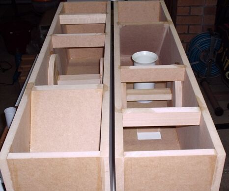

The "rough" woodwork is done. There are a few pieces that need 1mm trimmed, but that shouldn't take long. Then the actual construction work should start this weekend.
Oh, also bought a new jigsaw (bosch PST 750PE) - really nice thing. I will need to test it on a few more scrap pieces before it gets important, but so far it behaves excellent.
As for the routing / recessing the units, I was suggested to put 3mm felt (the fabric) on the baffle (outside), in stead of routing recesses. Does anyone have excperiences with this?
Jennice
Jennice

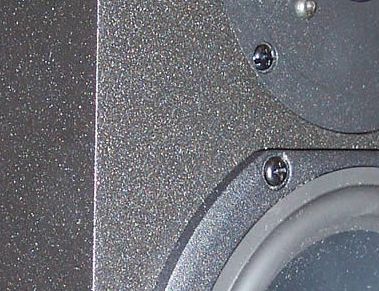

If you are not going to recess the drivers in the baffle, have a look at this clever solution that Bob Brines uses on the Peerless pipes.... very smart.
http://www.geocities.com/rbrines1/Pages/PP_Construction.html
Hi Rabbitz,
Thanks for the link. My english isn't native, so I need help on "translation"/explanation on two issues:
What's truck bed lining?
The enclosures look nice, but I can't understand what he's done around the drivers (anmd the pictures don't let me get the clue, either).
Could you be so kind and explain, please?
Jennice
Jennice
Hi again Jennice
What Bob has done is installed the drivers on the baffle without a rebate but has made a panel with the thickness to suit the driver's faceplate, cut holes for the drivers and installed it so it looks like the speakers are rebated. Could be any material, plywood, contrasting timber veneer, painted MDF etc.
I just think it's very clever and looks effective.
Here's a brightened pic and Bob might be able to post a better one.
