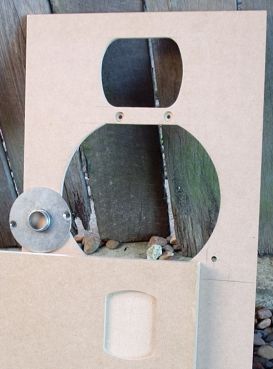

rabbitz said:What Bob has done is installed the drivers on the baffle without a rebate but has made a panel with the thickness to suit the driver's faceplate, cut holes for the drivers and installed it so it looks like the speakers are rebated. Could be any material, plywood, contrasting timber veneer, painted MDF etc.
A pretty common trick... even better if you use something like wool felt. Some commercial speakers build it into the grill covers
dave
I know wool, and I know felt, but wool felt!? *puzzled* ...and on the grill!? I thought as little as possible should be between the driver and the listener...?
Jennice said:I know wool, and I know felt, but wool felt!? *puzzled* ...and on the grill!? I thought as little as possible should be between the driver and the listener...?
wool felt... thick felt made of real wool (as opposed to craft felt most often made with polyester)
The guys who are doing it with the grills typically use moulded plastic that fits over the unrecessed driver and with the grills end up giving a no-bumps front baffle.

It's a very rough texture and not just an appearance.

Comes in a pressure pack can. The one that was used was Plasti-Kote but I don't know if it is available in Europe as Oz and the USA have heaps of utes and pickup trucks but I'm sure not so common in Europe.
The best place to try is an automotive shop that sells paint or a body repair shop.
