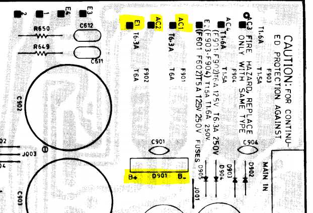

Thank you for posting the HiFi Engine service manual for me.
I guess my basic question is where do I place my meters electrodes to see if the power supply is putting out correct voltage?
as a first check - make sure you can access without chance of shorting the probes.
#1 with meter on AC - check AC1 and AC2, with your red and black probes - doesn't matter which way, then do the same for AC3 and AC4. write down the voltages.
#2 Take your black probe and clip to the speaker ground output (black)
With one hand holding the red probe, your other hand out of the way and no jewelry on. Touch the red probe (with meter set to DC) on B+ and B-.
Appears they should give you +/-94Vdc. If that checks out - next it to see if you can verify DC on the outputs.
#3 with unit off - take probes and clip to the speaker outputs (red to red, black to black), with meter on DC, turn the power on to the amplifier and look at your meter.
Shouldn't go over 1-2V and probably less than 1V. Do this test for both speakers (right and left). Trying to verify DC, before the relay protection kicks in, so you will only have about 1-2 second after power up to verify.
Report back on your findings and should give us some clues where to start further diagnosing the amplifier.

I did test AC voltage going to the board
125V
Just reminding this was without those 2 orginal capacitors I removed.
Rotel RX-950-AX wont power on. In standby only

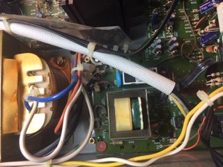

I checked ac1 and ac2 where you indicated on the diagram you so kindly included as well as ac 3 and 4. There was no current. likewise on what I assume is the recitifier B_B+ also no current. On the terminals no DC current.
The only place I see voltage is where the power cord attaches to what I am calling the power supply ie the board with two transformers (one large other small). There are 2 Wires entering the large transformer a blue and white and there is no current across them. I also noticed what I think is a brown gound wire and there is 125 from brown to blue and from brown to white.
The transformer is dead silent
With current entering the primary through Brown, white, blue but no current on ac3 /ac4 or ac1 or 2 could I have a blown transformer?
I have a question. There are 2 locations for the ac1 and the ac2 as well as 2 locations for ac3 and 4. The location you showed me on the diagram has no voltage. Just above the small transfor on the power board there is another ac1 and ac2 and this one has current. ac1 ac2 98 v.
I measured the resistance between ac1 on the power board to ac1 on main board and it was infinity. Are these two ac1 in the same circuit?
Update on this test: For my previous performance of this I tested the voltage putting my probes simulataneously on ac1 and ac2 and also simultaneously on ac3 and ac4. I reported "0" voltage. When I put one probe on ground and the other on any one of these 4 points I get approx 3-5 volts.

Highly unlikely your transformer is blown. Just to confirm, you are sure you have your meter on AC when testing these points?
The only difference in what you have done is split the AC in half, so something is wrong if you get “0”, where full voltage should be and 3-5 volts where 1/2 potential voltage should be?

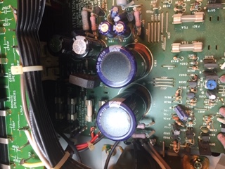

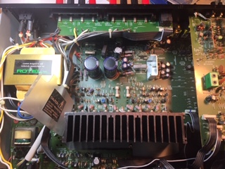

Might be easier if you took some high res pics from a few angles of the power supply board(s), so we see what you see.

against ground DC AC volts
ac1 2.5 , 5
ac2 2.5 , 5
ac3 2.5 , 5
ac4 2.5 , 5
