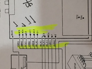

AC is between two points, so red in AC1 and black on AC2.
There must be some misunderstanding. You asked me to measure the voltage between AC1 and AC2. From my understanding of the wire diagram (uploaded) AC1 and AC2 share the same line. There is "0" resistance between them. How can I get an AC or DC between these points? IMG_0282.JPG
No. There's lots of wires here. Going somewhere else. Not electrically connected, but the draftsperson opted to *draw* them together to reduce clutter.
Have you measured? Transformer windings are often less than 1 Ohm and few ohm meters will read such low values correctly.
Draftman schematics for RX-950-ax
Thank you so much for explaining what I am seeing. That make sense to me that the "low ohm winding" along with the "technique" of the draftman to avoid clutter made me conclude all these points were in line when they are not.
Interesting though I only get 5-6 volts on these point which I believe is probably coming from the smaller transformer as a standby voltage.
I recently read an article talking about "standby boards" and how issues within them can deactivate the main transformer for protection (Sony Receiver Amplifier Will Not Start -- Checking Standby Board).
I am wondering if the two bad caps I removed have essentially through a "microprocessor somewhere" have shut off the activation power to my larger transformer.
I do see a smaller transformer on the board next to the big one, so it seems you'll have to continue looking in the standby power supply. If the microprocessor is not getting any voltage or the relay supply (often 12 V) is too feeble as a result of bad caps, the unit won't turn on. That's two voltages to verify. Only if those are nice and stable you'll have to continue looking further (e.g. a bad cap hiding in the microprocessor reset circuit).

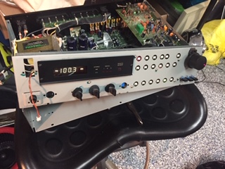

Rotel rx-950-ax Now powers on!
Excuse the pun
So "recapping my problem" My unit would not power up and caps 955 and 956 tested bad. I replaced these. These caps along with small transformer and relay serve to turn on the large transformer ie the unit.
Although a novice/amateur I get the same thrill as the pros...even doing very simple things like replacing a bad cap. I want to thank the members of the forum for their patience and wilingness to teach and even their "protectiveness" of their "DIY students health."
My self, I happen to me a first medical responder and these are very hard times so I really appreciate it when I see people helping people. So again...thank you everyone.
