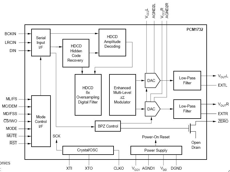

PCM1732 DAC & Swenson Mod
The PCM1732 is a single-ended voltage out DAC. You can download the datasheet here.
A few posts back, I linked to Swenson's page that describes the mod.
I'm plugging my CDP into a Marantz 2285B that has integrated pre-amp with a 33K Ohms input impedance. John recommends a 0.47uF cap if you've got a 50K input impedance and a 4uF if your at 10K impedance. He advises to pick something in between if your impedance is in between. -I have a funny feeling this is not linear, but not knowing any better, I selected a cap of 0.56uF.
If anybody can tell me whether or not 0.56uF is wrong and why (or what it should be), I'd be much obliged.
The whole reason I'm thinking of doing this mod. is to eliminate the op-amps and dc-blocking caps (and anything else) that will be adding crap to the signals coming from the DAC. -Am I wrong to do this? Perhaps this is just a bad idea for my design. -I'll give it a try and a listen, but somebody on this site surely knows...
The PCM1732 schematic is attached.

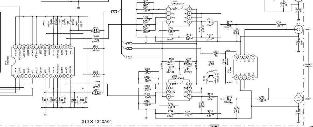

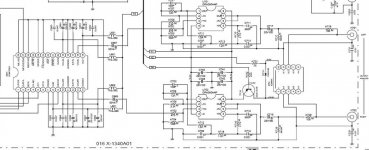

Finally, here's what Rotel have done with the DAC...
Seems like they've gone to some trouble to implement the analogue stage with filtering and such... As far as I know, they don't tend to put lots of extra stuff for no reason...so this is why I'm questioning the value in performing the Swenson mod. in this unit.
If (when) I do go ahead, I would lift the pads of C667 & C668 and run a wire from there to the RCA outs. The ground on RCAs, I would run to nearest ground (existing RCA grounds, for example?).
more comments & suggestions welcome...

BTW..........that strange B-B DAC chip looks like they do the combining inside, so your cap mod should be ok. Providing you can deal with Solen.
Jocko
Well, I tried that Cap mod (aka Swenson) last night.
-1- I used the grounds from the original RCAs
-2- I ran single strand of Cat5 from grounds to new Gold RCA -ve (gnd.)
-3- I yanked caps 667 & 668
-4- I ran a single strand (1/8) Cat5 from +ve pads where C667 & C668 were to Solen 0.56uF 630V caps.
-5- I soldered the other side of each Solen cap to the center pin of new gold RCA jacks.
-6- I ran a 300pF 500V mica cap from center pin to -ve housing on new gold RCAs.
-7- I measured AC voltage with a CD when all was done. As expected, the voltage was significantly less than with the op-amps. Interestingly, though, the DC didn't stay at 0. I saw it fluctuate from -0.3V to +1V over the limited time I took the readings.
After this I plugged the CDP into my Marantz to have a listen. -It sounded thin and for lack of a better word awful. Any sense of 3D was lost. In fact, I couldn't rip it all apart and put it back the way it was fast enough.
I suspect that something was 'not right'. Maybe the Solen was the wrong value. Maybe using the old RCA gnds was not so bright. Who knows. However, unless somebody has a really convincing suggestion, I suspect I won't be trying this again.
