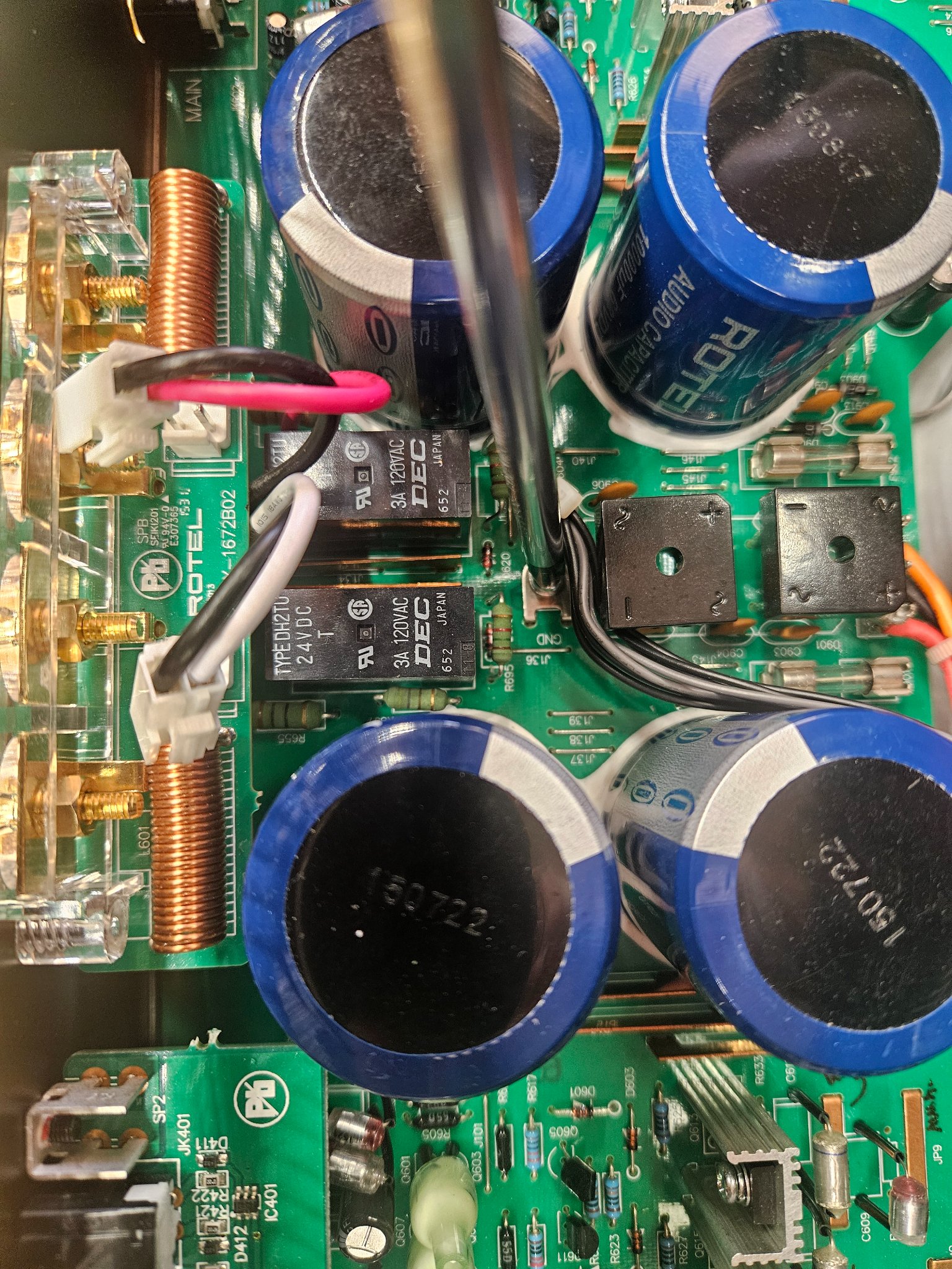

Good morning people of this community.
Ok I thought I feedback you after having troubleshooted a bit more of what I believed the problem was with.
I thought that the real problem focuses on the IC504 Chip which is directly related to Tone control and therefore reflects incident 2 (when changing Tone Bypass=Enable to Disable and vice versa). That is not it.
I Switched off speaker set A and I set from the menu Tone Bypass=Disable. I hooked up Audio from my neighbours IPOD and used IPOD earphones on the device Phones socket. Changing tone and bass worked. I could hear tone changing either adding or remove.
So its not the Tone control. I also removed C532, C531 and C541, C542 just to isolate this chip from rest of audio and try switching Both speaker sets on, in an attempt to see if that will cure the issue of having AMP protection when both sets are on or even enable / disable Tone with speaker sets on. Unfortunately that did not change anything.
Checked RY_B+, B+ 3.3V 5.0V 12V, Checked Voltages around Series Transistor regulator Q657, Power originating from Q901 and Q902 respectively calculated voltages on / around common collector transistor Q412, Checked power around circuit CP609.
All the above are correct within 0.7v, and 0.5v voltage difference with what is referred on the diagram. Also removed front panel and I saw the LM317 Voltage regulator. I calculated the voltage based on the resistor values indicated on the circuit diagram, then measured them and they were spot on.
Also RY408 and RY409+RY410 Relays Identified as Mute and Tone Relays, these work. RY407 is actually the relay that oscillates not RY408 as I referred to in previous spots. RY407 is identified as DAC relay and it seems that is controlled directly (via DGT) from the Processor, So do Mute and Tone relays.
Mute is not featured from main menu. However I also came into conclusion that the audio leak into the DC might be originating from the RY_B+ Bus (lets call it this way), or from the negative going pulse driven by the Processor via the DGT's, and to be honest all of the RY_B+ that circulate around on the relays do present some sort of Audio presence (very low). So am thinking of checking out R700 and DGT's R657 to R660 as a next step.
Audio in and audio out on OP amps IC501 and IC503 seems clean and undistorted, as these were checked with Oscilloscope not influenced by the RY oscillations anyways.
Also Vin and Vout on IC502 seems to be ok and undistorted. The -2VDC seems to exist from IC501 all the way up to IC504.
Am out of ideas and exhausted my self yesterday actually. I really don't know what else to look for except from a faulty Processor, or the DGT's driving the corresponding relays, but then again if you play with tone controls you can listen to them clicking. Any ideas are welcome and help will be appreciated

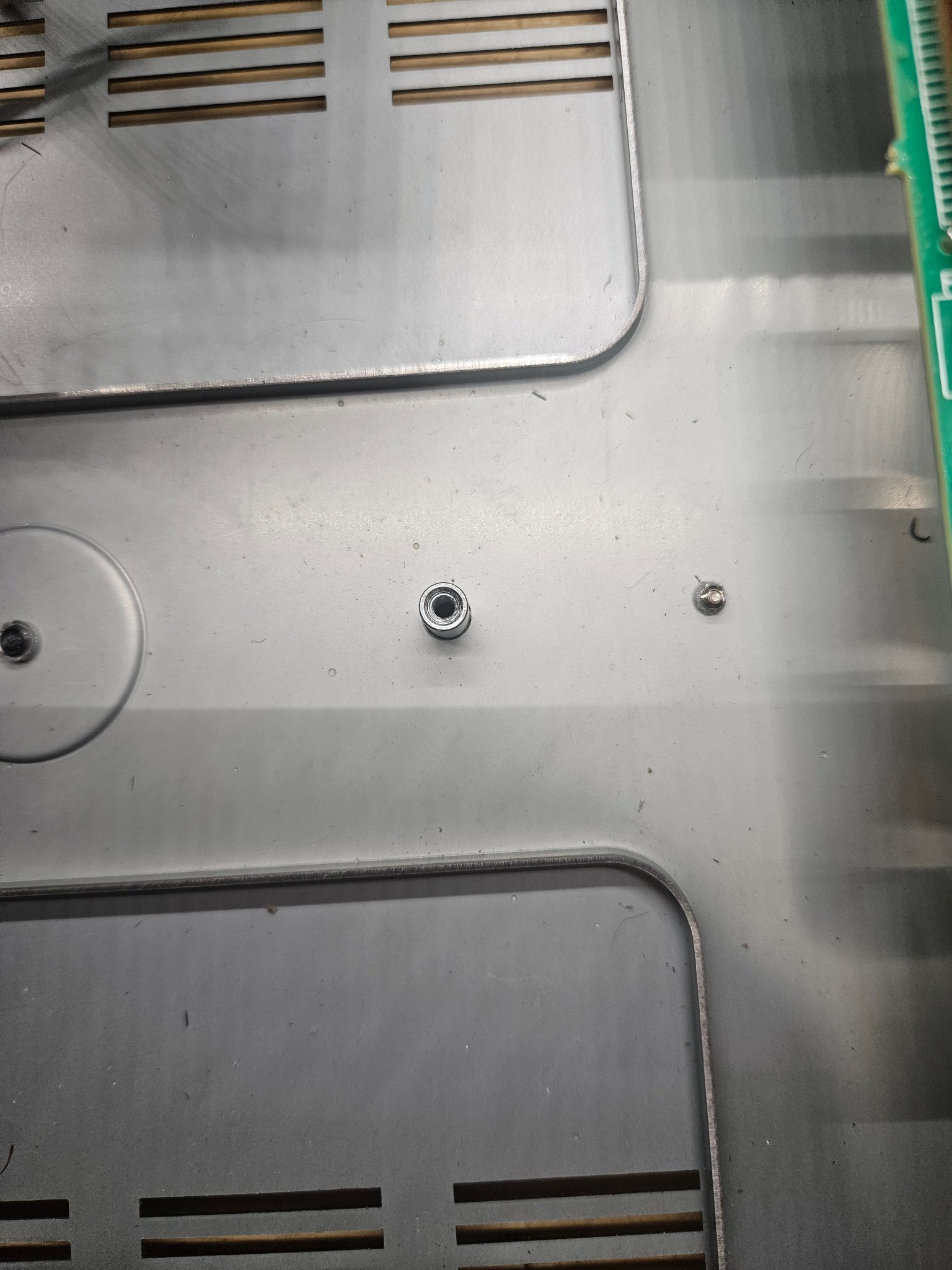

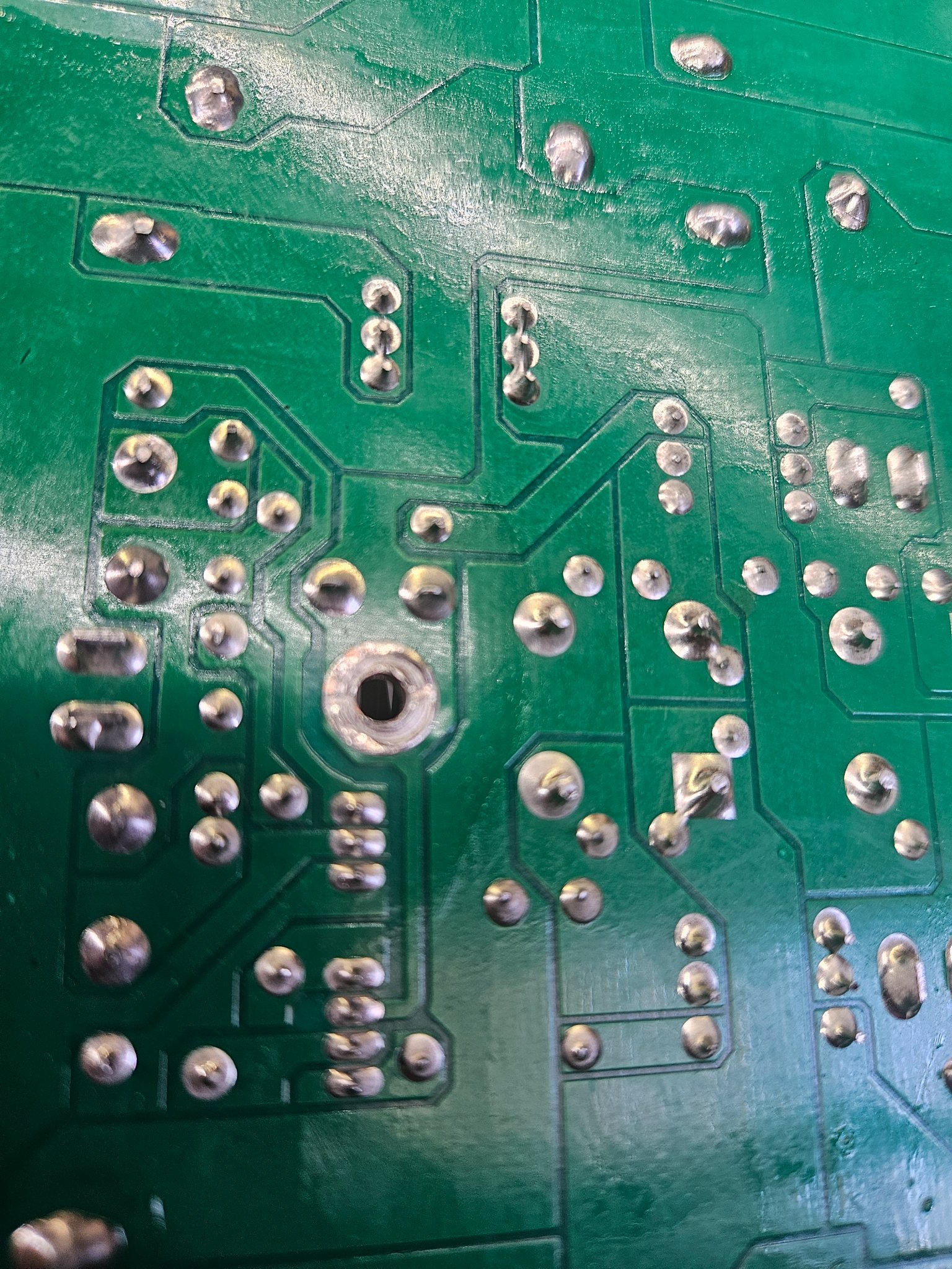

I am increasingly convinced the problem is faulty interconnection of the grounding system.
Look just to the left of IC503 in SM, page 17. There you will see two different ground symbols. SM page 16, upper right corner: note the ground symbol indicating connection to the speaker "ground" binding posts. Same page, left of bridge diode D902 is a third symbol. And bottom of page 16, a fourth symbol is used to indicate connection of bridge diodes D801 to ground. A remaining mystery is the location of the mechanical connection to the chassis metal and which ground symbol corresponds.
I believe an important joining of two ground paths occurs at the big reservoir caps, C911, C912.
All the these different symbols indicate Rotel's efforts to control how ground currents flow. On page 16 PA section, note how the shells of the RCA jacks connect to the PA circuit, and the "ground break" resistor R659. The RCA shells are the ground reference for the PA. I think this is the explanation for change in speaker out voltage observed when you connect the audio cable. I believe the ground voltage at the end of the grey audio cables is somehow at -2V re C911, C912.
I suggest taking a measurement reference connection at C911, C912 and exploring "ground" voltages relative to that node. Be alert to possible connector problems.

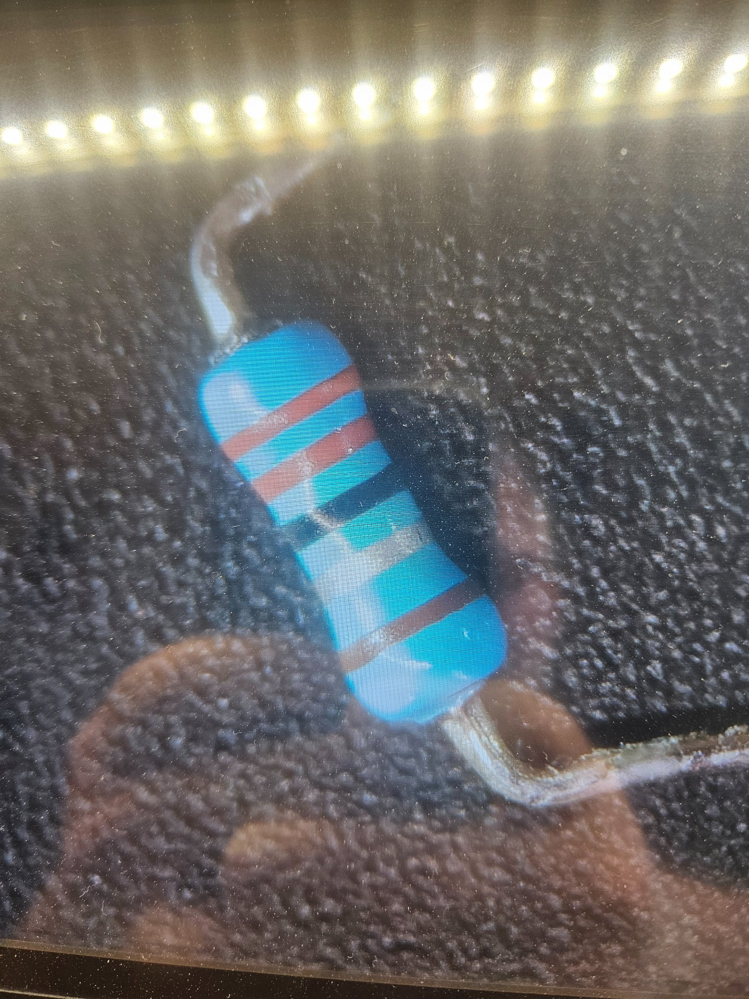

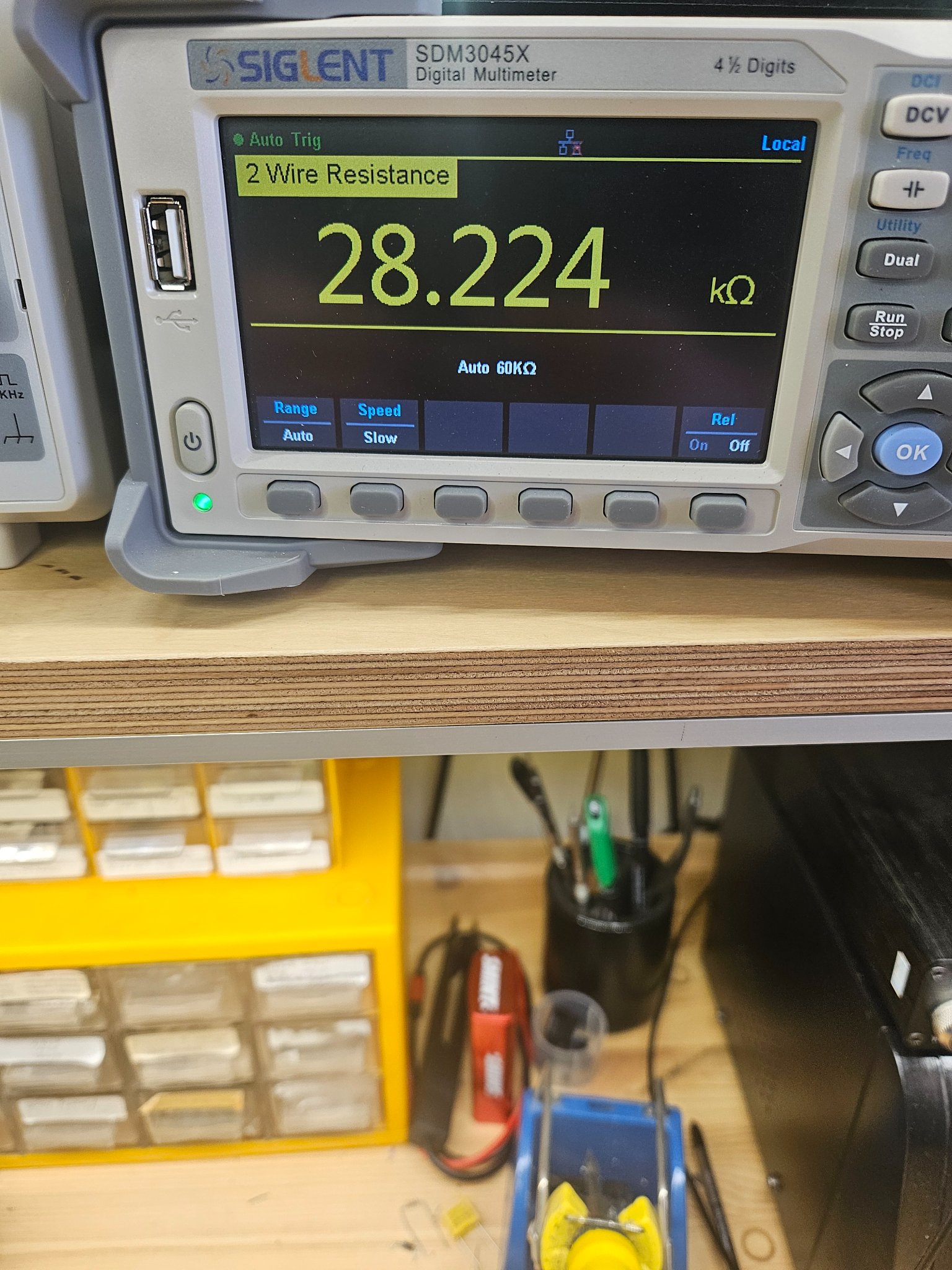

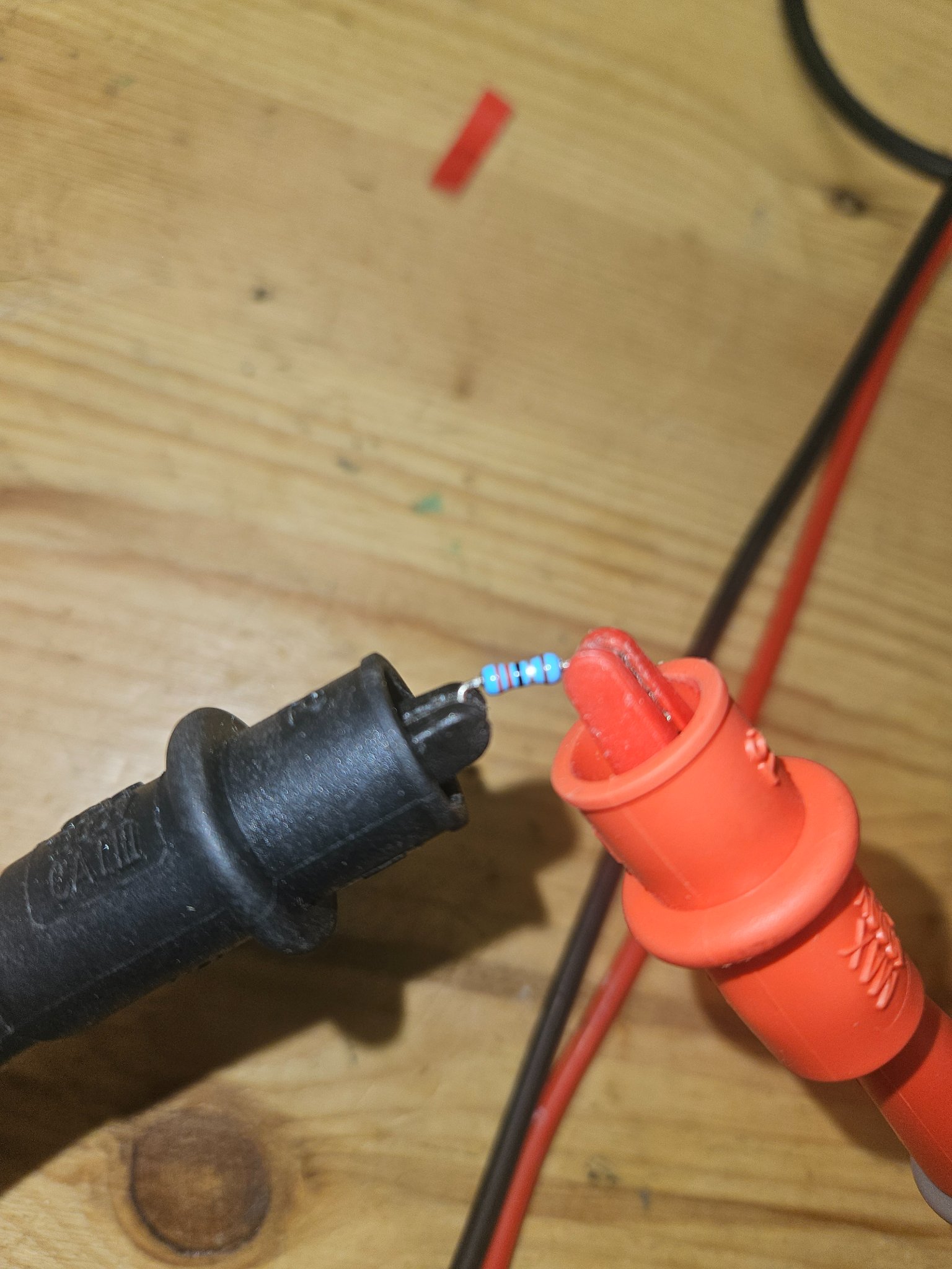

Ohh our timing must really be in sync. Thanks for responding with these two posts. Your hints from yesterday really had me grinding a lot of circuit reading and scouting on the PCB. Well If I tell you that resistors R659 and R660 measure 27K and 44K respectively would you believe this ?, I was righting to inform you about this while you were writing your last post.All the these different symbols indicate Rotel's efforts to control how ground currents flow. On page 16 PA section, note how the shells of the RCA jacks connect to the PA circuit, and the "ground break" resistor R659.
Resistors 659 and 650 are supposed to be 2.2 Ohms each. So I removed one and measures 27K. I removed the other and measures 47K. They are 5 colour band resistors, and the band colours are Red, Red, Black, Silver, Brown.
That indeed from my knowledge should be 2.2 Ohms. I double checked that with Digikey online Resistor Calculator and colours refer to 2.2 Ohms resistor. So Am immediately replacing them and feedback back to you. The mechanical Earth which is just a post and the motherboard support screw holds the board's Ground location firmly on that post. I checked that one and mechanically is ok and sound.
I also checked with DMM Digital Ground Vs Chassis Ground and that measures -2VDC. This -2VDC was becoming annoying 🙁
So wait a few minutes and I will feedback you.
Bingo....
Having replaced the two Earth Isolating Resistors R659 and R650, this cured all of the problems that were previously causing "AMP Protection". Now I can have both speaker sets on, whilst having Tone Bypass=Enable or Disable without causing further AMP Protection. So now it remains whether I can enjoy music without the infamous Relay clicking. I have placed both Grey Audio wires from the I/O Board onto the AMP Board. The -2VDC has disappeared from the speaker Posts and whilst both of these grey wire we also had "Amp Protection" if both were inserted. This issue has also disappeared.
