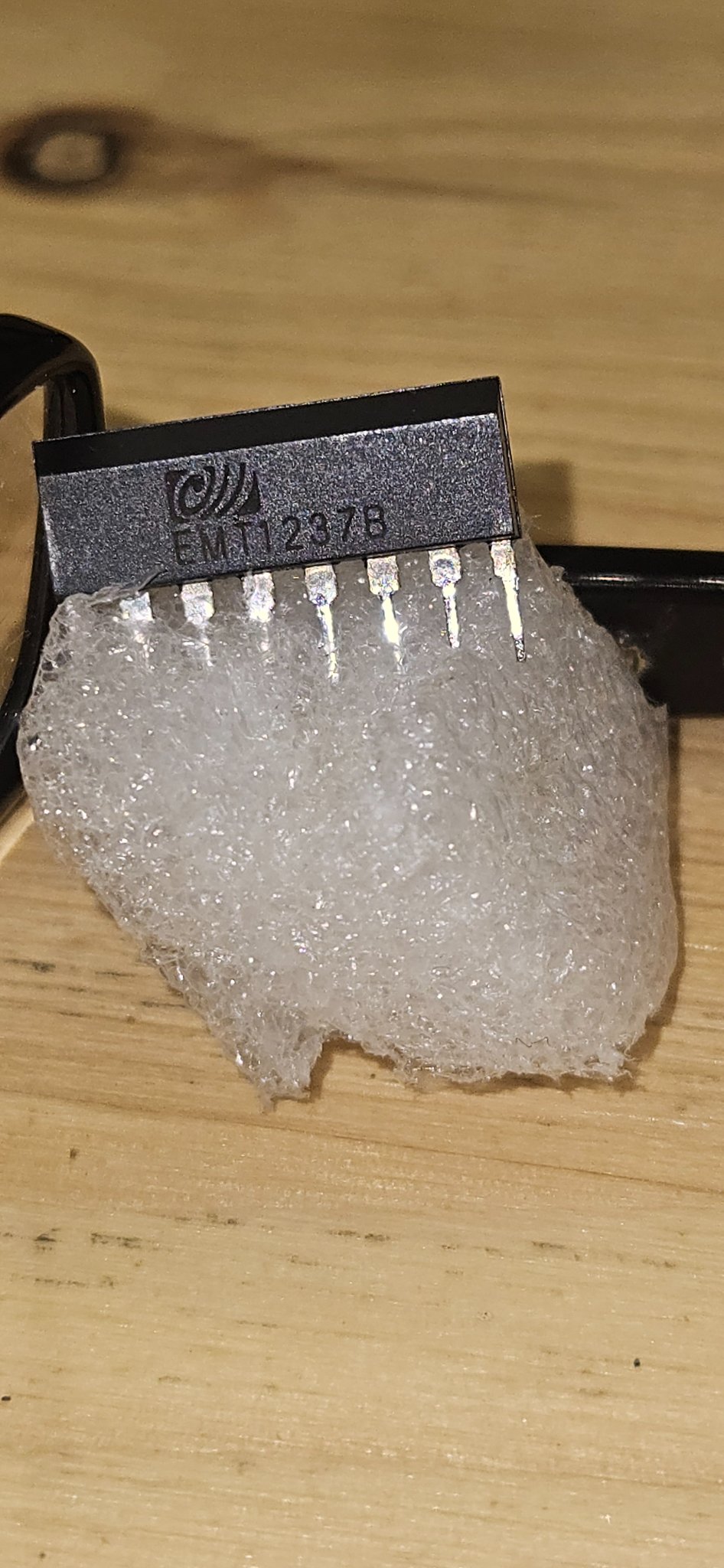

Not a lot of info on the EMT , all China links are dead end. It does not look to be pin compatible with the uPC.@ostripper: Is there a known difference between EMT1237B and uPC1237 ?
Shame it is SIPxxx , they could of sold more as a direct replacement.

The few existing links describe a 8-pin SIP. But , a different "superior" design.
The dip-8 adaptor seems to have a 8-pin SIP on it (photo). The small adaptor PCB Has EMT-xxxx
An adaptor for the described EMT1237B , which is NOT a uPC.

Scrutinize the first photo in post 14. I can imagine the pins of an 8-pin mini-dip near the pins for the 8 pin SIP socket.
I speculate that the adapter is fabricated from ordinary generic parts--- maybe an LM393. Point being, maybe it's possible to repair the module and restore functionality. Hence, the request for a close-up picture of the hidden parts on the module.

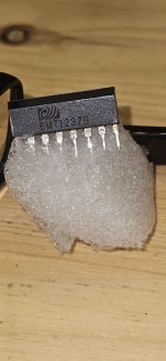

I already put the assy back on the PCB. Got a picture of the replaced IC, in case was the problemIt sure would be good to have a schematic...
Can you remove that EMT1237B "chip" and post a close-up photo of its component side?

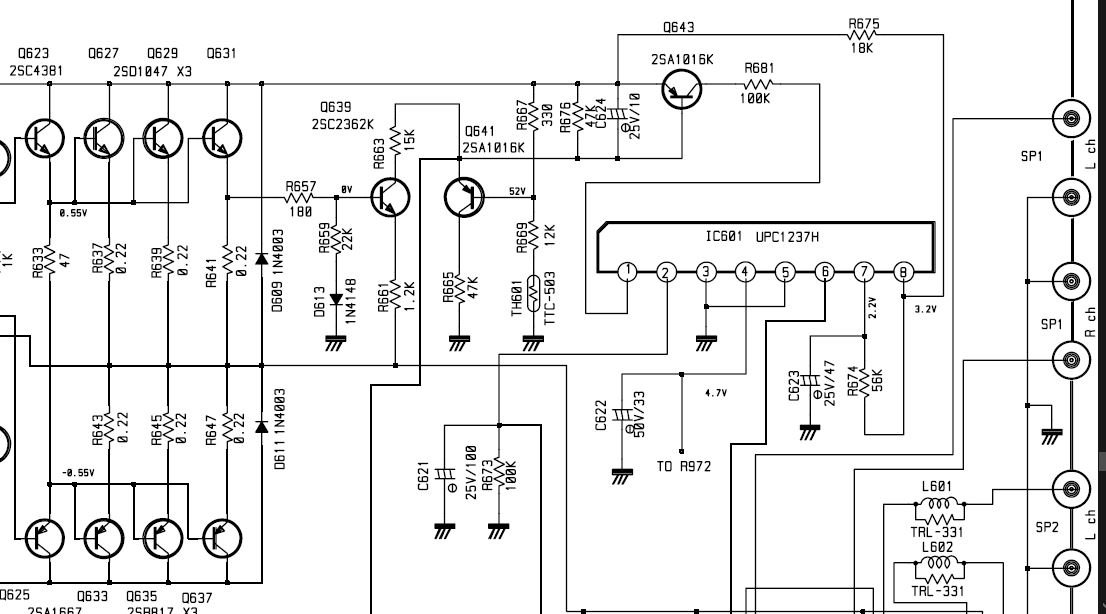

Hi mbz I found this circuit diagram of a ROTEL RA1070 utilizing a uPC1237. I cut a portion just to compare it with the RA1570.Example from a Yamaha RX-V3900, over current sensing transistor circled in red, only included to give you some idea.
I don't think I can. Its a bit impossible, however some of the voltage indicated on this circuit diagram are also measured on the actual uPC1237 on the PCB Pin 4=2.4vDC, Pin8=3.4vDC, Pin7=2.2vDC.
The schematic is encouraging. Are you able to measure voltages of the uPC1237 in your unit. Saw your pins noted above. What about pins 1 & 2 ?

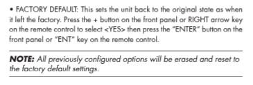

Hello. Yes I did a factory default as it is stated in the manual. Attached capture ! Unfortunately that did not work. ! But hey thanks!Did you ever try a reset of the amp?

That will most probably be the implementation in your unit.I found this circuit diagram of a ROTEL RA1070 utilizing a uPC1237.
Need Vdc at each of your pins so we can make an assessment on whether your IC is a cloned uPC1237. Pin 1 and 2 are of most interest. A good GND pin is also needed.
