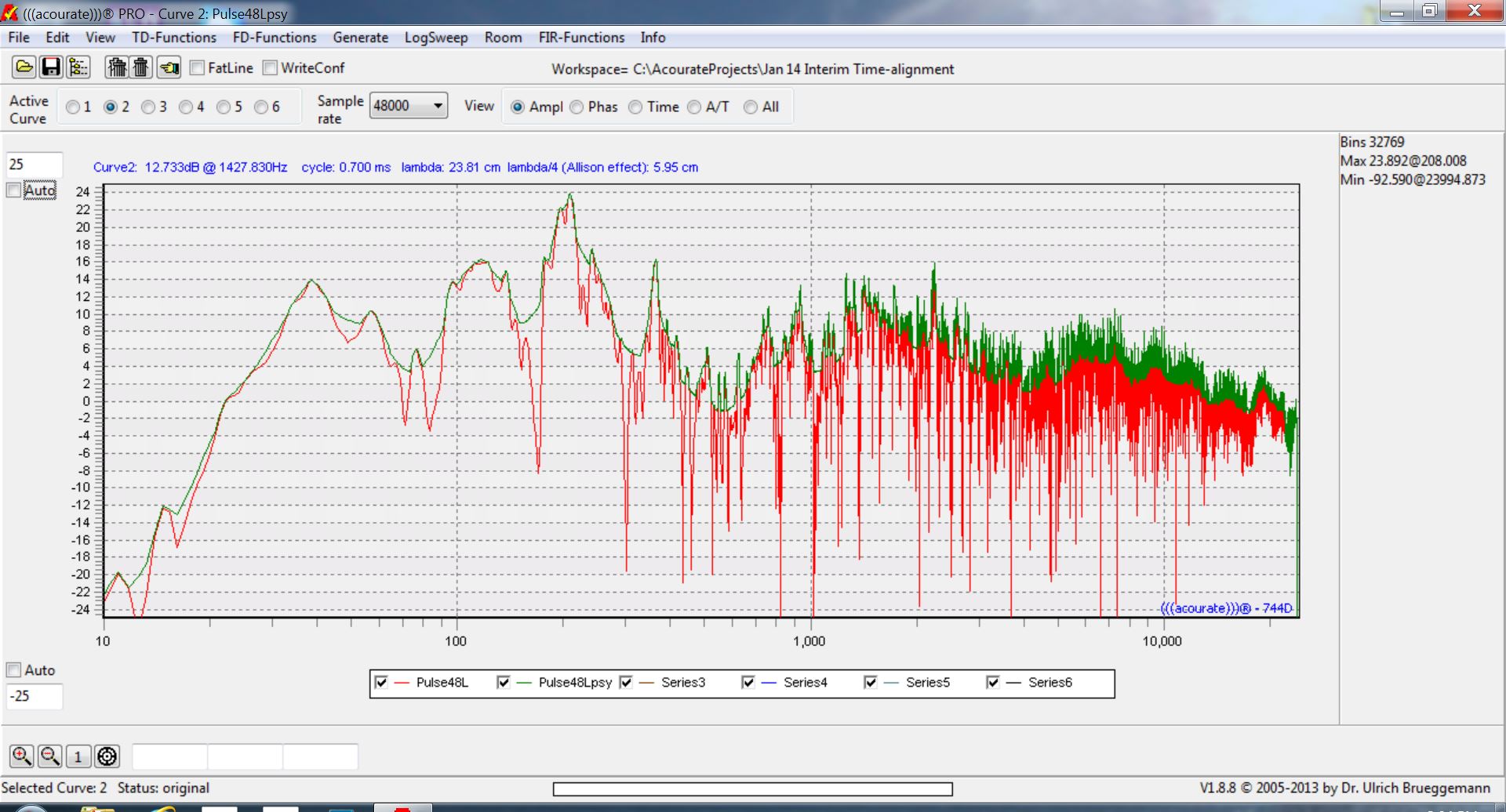

The so called house curves mentioned are designed to provide the listener with a *perceptually* flat frequency response at the listening position independent of room and speakers. Again, understanding pyschoacosutics from JJ's articles helps understanding why this is.
For example, one person I know shares the same target frequency response as I, but our rooms and speakers are completely different. So when I remark on a tune and say this one is mixed/mastered a bit bright, the other person has the same consensus, even though the other person has completely different speakers and listening environment.

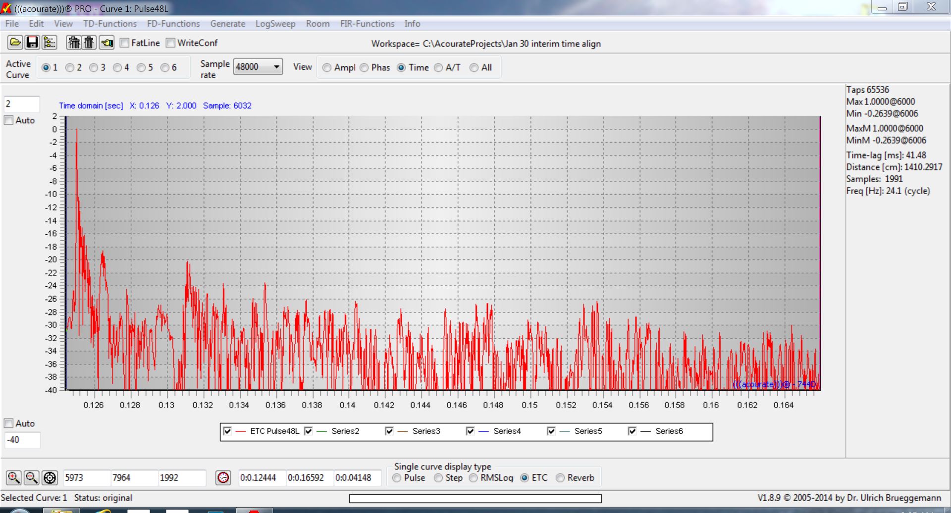

The assumption is that the listening room already has been treated appropriately to take care of first reflections points (floor ceiling, side walls, etc.) and that enough bass trapping, diffusion/absorption has been applied for a nice even decay over all frequencies.
The rule of thumb is that early room reflections should be -20 dB or lower than the main pulse for this first 0 to 40 ms of sound travel in the room. See attached ETC of my room that just meets this requirement.

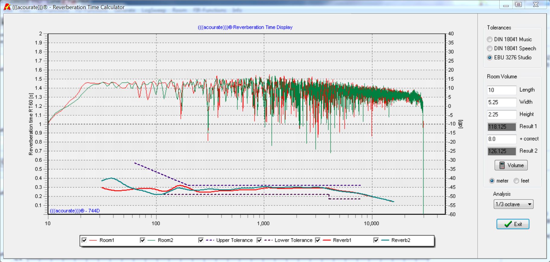

Attached is the RT60 of my room that meets the EBU 3276 guidelines (also attached). While the EBU 3276 tech guidelines are a bit old, it really is a good read and also has another house curve 🙂 very similar to what we are discussing hear. There is a reason for that.
