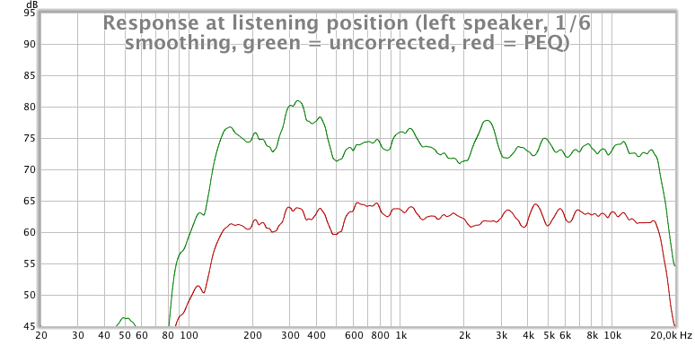

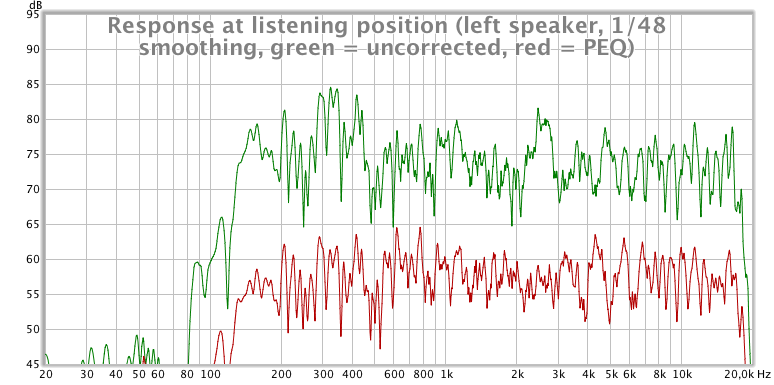

Currently my approach is to use a single measurement at the main listening position, apply a frequency dependent window in Acourate and use REW's EQ tool to fit PEQ filters. That tool is magnitude only and doesn't know where mixed-phase regions are hence I only allow cuts but no boosts.
Results are promising. Imaging is improved.

Looks like definite improvement.
What does phase look like before and after? And IR?
Also looks like taming of peaks at about 1.2kHz and 2.4kHz have unmasked what is likely diffraction or cavity resonances of waveguide in 3kHz-7kHz region.
How do these peaks shift with small movement (2-5") off axis or small changes along listening axis?
Spikes in REW group delay plot often reveal regions where EQ often leads to unpredicted and undesirable results.
How does correction with Acourate measure and sound?

Interesting, but I'm curious what went wrong between 3Khz and 7Khz which is clearly worse after EQ than before ? (For example where did the peak at 4.3Khz come from when there was a dip in the original response and you say you have it configured to only correct peaks not dips ?)
What does the 1 metre reflection free windowed response of the speaker look like before and after correction is applied ? (EG what is the effect on the direct field response) Is the peak at 2.5Khz present in the speaker response or is that a room artefact ? If it's purely a room artefact I would be wary of making such a big correction so high in frequency based on the room response instead of the speakers own axial response.

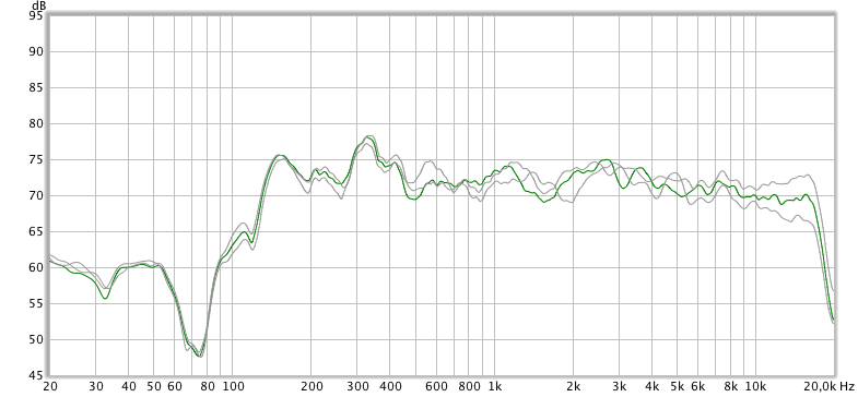

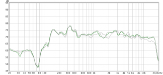

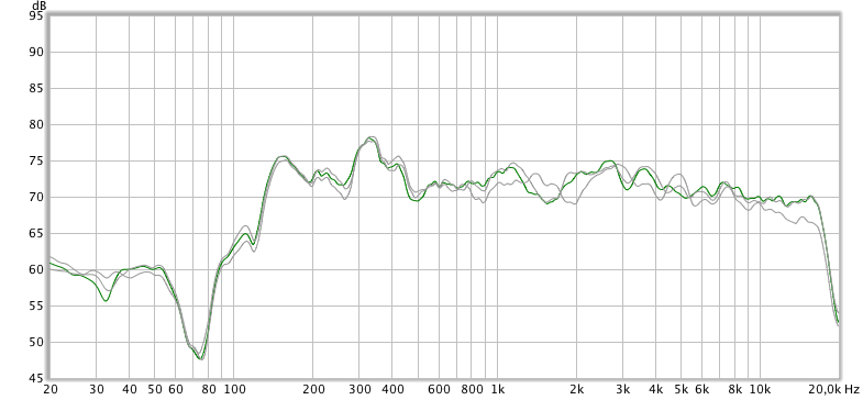

The measurements show in-room data at the listening position about 2m away from the speaker. Gate is about 500ms.
I doubt it's waveguide resonances but reflections from the couch and/or the sub (cavity) right behind the listening position.
10cm front/back (1/6, 500ms):
10cm left/right (1/6, 500ms):

The mic was repositioned between measurements. That might explain some of the discrepancies. Others might just be room artifacts - see my post to Andrew.
Generally the question is how such reflections affect what we hear. Do they become part of the direct sound? How to include them correctly? They vary considerably with position. They probably look different with a head and a torso in place.
