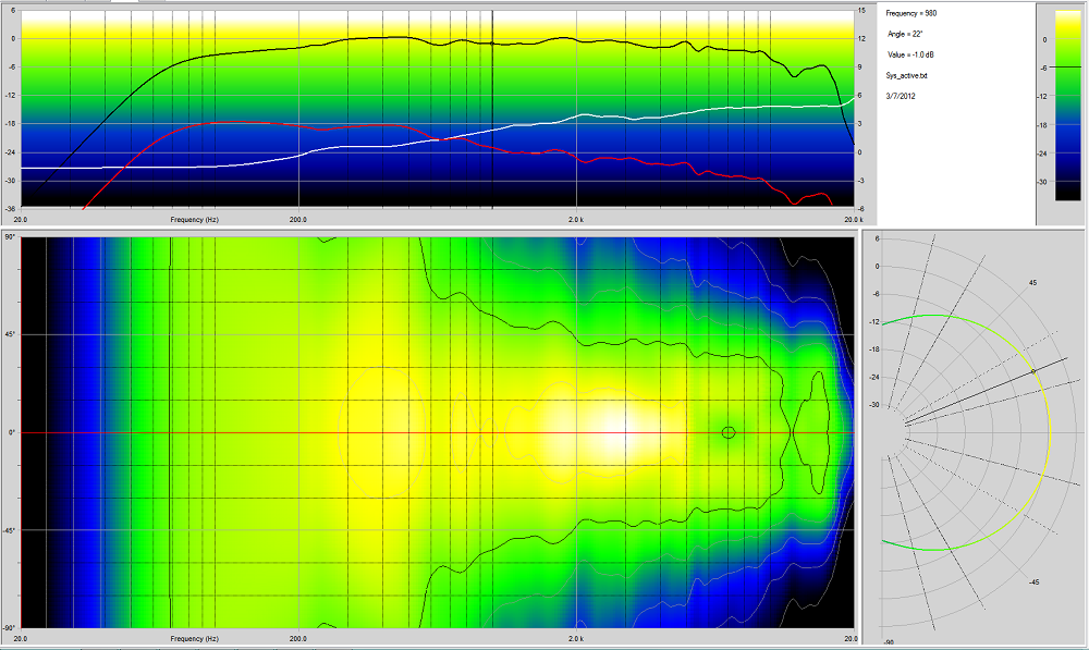

Maybe it's not flat. Looks like that may be Markus' Nathans.If your speakers on axis response is flat in the treble the treble response should look flatter and flatter as the window shortens without the droop you see in a typical room power response.
A 7.5dB fall between 2Khz and 10Khz on axis ?Maybe it's not flat. Looks like that may be Markus' Nathans.
I a firm believer in using EQ to create the ideal response form me speakers, since my first system purchased while in the navy, Yamaha 16 band EQ with RTA and mike! It took my Klipsh speakers and adcom player to new heights!
There's something wrong with your measurements or methodology Markus.
That might well be but I went over the process several times and can't find any errors.
Regardless of window length your high frequency response has basically the same fall off slope. If your speakers on axis response is flat in the treble the treble response should look flatter and flatter as the window shortens without the droop you see in a typical room power response. Your graphs look more like post FFT smoothing than windowing of the impulse.
We're looking at an in-room response taken at the main listening position. Speaker is a Geddes Nathan 10.
Also although a sliding window has been proposed to better model human hearing I don't think it's a one for one linear relationship that you can model by making the window length a fixed number of cycles.
More like steady state at low frequencies, direct field at high frequencies and a transition region of 2-3 octaves in the midrange.
I agree but at one point we have to get past educated guessing and find practical answers. That's what this thread is about.

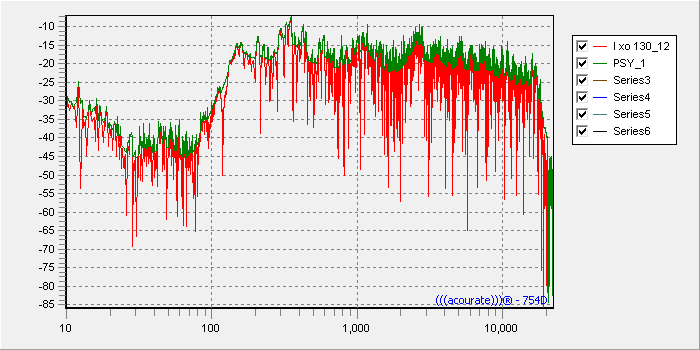

I've been talking to Uli about this and Acourate indeed applies psychoacoustic filtering first followed by frequency dependent windowing.
Markus,
your diagrams look like you have changed/reduced the FFT sample rate. That would be like 1/x octave smoothing, but probably not the same.
No, not that I'm aware of. I've applied different frequency dependent window values in Acourate. For example a width value of 1 corresponds to the following window sizes:
100Hz = 10ms
1kHz = 1ms
10kHz = 0.1ms
100Hz = 10ms
1kHz = 1ms
10kHz = 0.1ms
I see, he counts/gates periods instead of time. Three periods might be enough for the brain to identify any frequency.

I've been talking to Uli about this and Acourate indeed applies psychoacoustic filtering.
What does he do to the signal to accomplish this?
He doesn't disclose that information. The result looks like this:
red = magnitude response with large window
green = Acourate "Psychoacoustic"

Even so, it still doesn't look right, unless the speakers have a very droopy axial high frequency response and a very flat DI. What does the windowed axial response of the speaker look like at 1-1.5 metres ?That might well be but I went over the process several times and can't find any errors.
I've taken the same type of measurements before at the listening position with variable window times on my speakers and although the high frequency response measured with a short window far away is not nearly as accurate as a 1-1.5 metre measurement (window time to first reflection is too short for good frequency resolution) the trend was clear.We're looking at an in-room response taken at the main listening position. Speaker is a Geddes Nathan 10.
At the listening position with a very long window the high frequency response slope is pretty close to the room/speaker power response, (eg sloping down about 5-10dB from 2Khz to 15Khz, can't remember exact figures) while the short window response is fairly close to the free field axial response of the speaker, especially above about 5Khz - eg more or less flat +/- 1dB or so.
My concern is there is NO apparent change in the slope of the high frequency response with changes in window time it just looks like progressively more smoothing was applied. Do you have some more conventional speakers you could measure as a comparison ?
