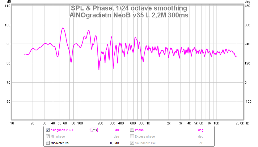

FFT makes time domain analysis easy. @barleywater shoved only gated measurements of some undefined IR gating. This kind of measurents are ok for speaker analysis. But when we evaluate and analyze speakers in a room, decay response analysis is important. There are many ways to visualize it, waterfall, spectum, wavelet etc. <6ms is most important but ears pick up much longer reverberations.
Direct and delayed sound should be in harmony. Room's reflective spectrum and RT time should be in harmony. This is very difficult. Below Schroeder modes are a different story.

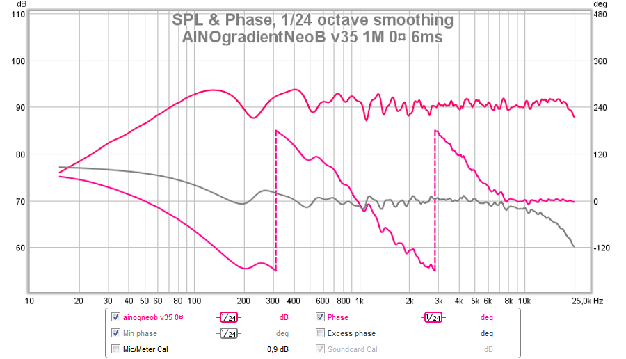

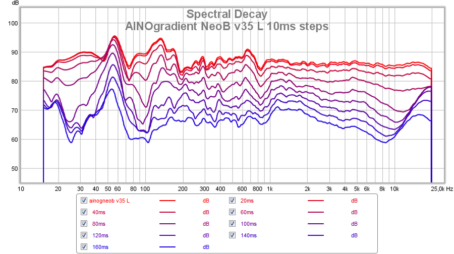

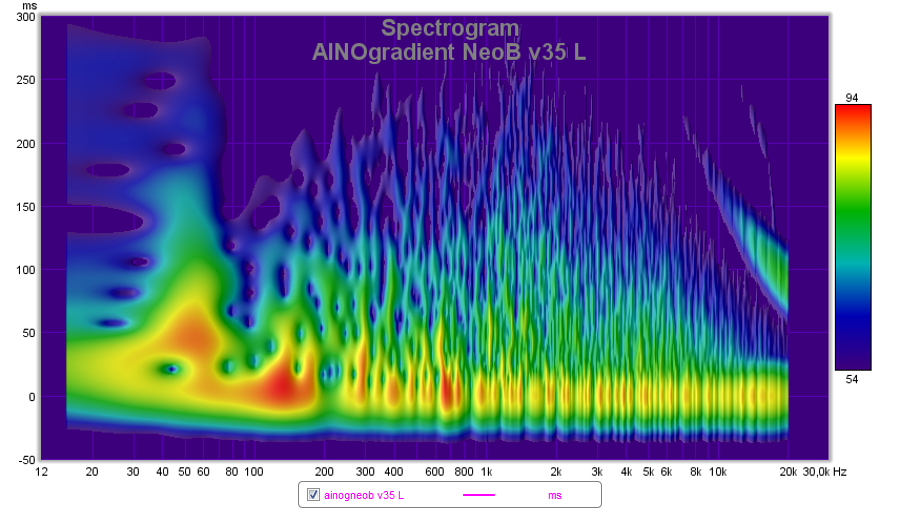

This is my diy dipole speaker at 1m 6ms gating, 2,2m 300ms gating, 2,2m short decay and long decay and wavelet transform. All done with REW.
Interpreting of the data is important. And then, what to do, how to do?

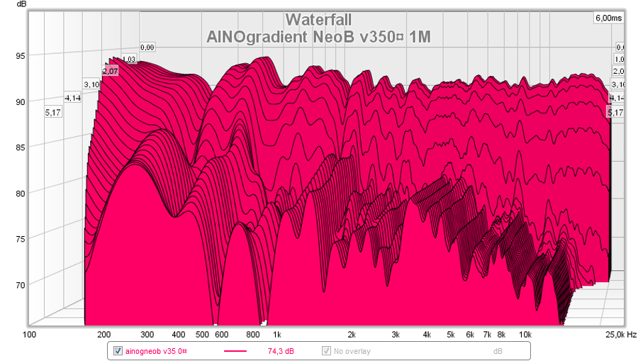

Sory I skipped this CSD, 0-6ms decay
What's creating the 680 Hz ridge?
It is a reflection (sharp up/down). Does not appear on the R channel/speaker. I have not figured out exactly what causes it, layout is pretty symmetric.
We should always take several measurement with some changes - to learn what change has which effect. It is unbelievable how small changes can be seen in time domain! Ambient noise is difficult - play loud at least 90db!

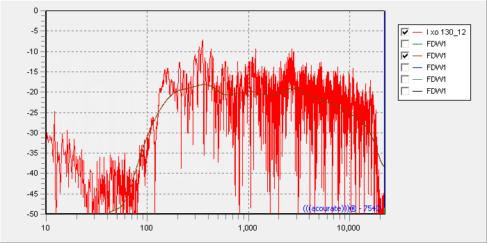

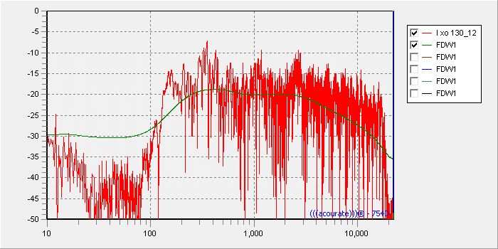

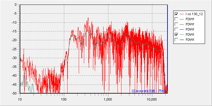

Attached is the dialog box that is applying the variable frequency domain windowing to calculate the psychoacoustic frequency response. Another dialog box also uses FDW to correct phase response, but that is another topic for another time.
The result of which can be seen in the chart. The red trace is the non-smoothed or raw frequency response. The green trace is the psychoacoustic frequency response. Note the difference in both the low frequencies AND the high frequencies.
It is the green (psychoacoustic) response that is used to calculate the FIR filter. Note how this is different than virtually any other room measurement/correction software, except the ones using FDW. The end result also sounds very different. And to my ears, superior to anything else I have heard by a large margin.
What I don't understand is why Acourate applies psychoacoustic filtering ("filling" dips) before applying a sliding window. I'd think that it should be the other way around.

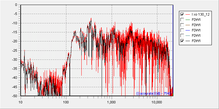

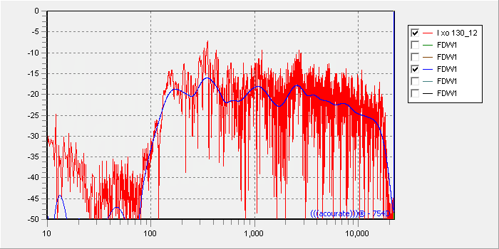

I've attached in-room magnitude responses of my left speaker with different frequency dependent windowing applied. The red trace shows the response with a fixed window.
1 cycle:
2 cylcles:
4 cylces:
8 cycles:
64 cycles:
Does any of these curves represent what we hear? Maybe in terms of tonality?
