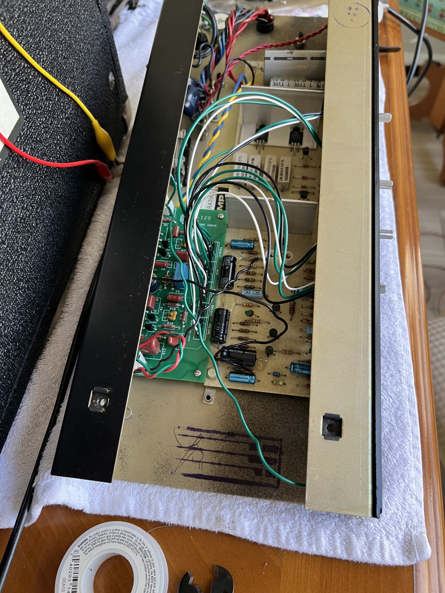

OK, I see you did reverse them. Try powering the Preamp with two 9V batteries in series to get 18V.

Switched to series 9v… and success! Mostly! Is there supposed to be this much background noise? Took another video. Starts off with me muting the strings, then letting go and obviously the buzz/hum gets worse.

I may order some trusted FETs from ebay to swap and see if the buzz improves.

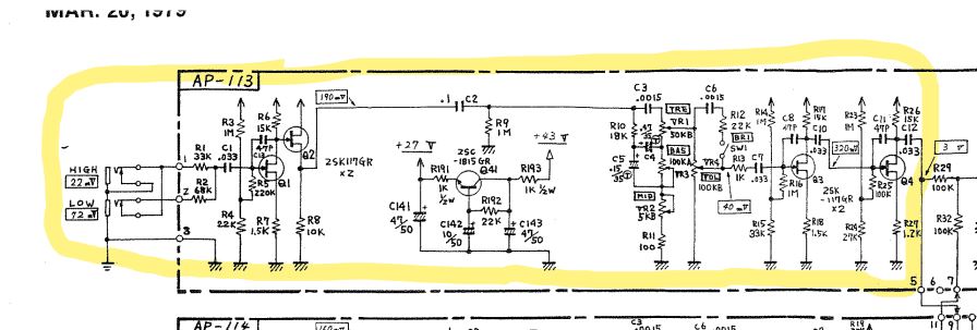

The pre has a lot of gain too.
You can take a resistor at the pre input across the Signal to ground (right at the jack). Start out with 470k and raise closer to 47k and it should quiet down and lose a little gain - pick one that sounds best...
Also, see original schematic. With Hi input has 33k in series, but with low input, 33k in series with 68k to ground for voltage divider to drop signal level. You may want to play with a resistor to ground there. I just put a resistor to ground right at jack and worked fine.

Perfect! If it sounds great, I would just keep the JFETs you have installed...its all about what sounds best...
I actually compared the 2SK-117 to the 2SK-170 and definitely prefer the 2SK-170 JFET better...2SK-117 sounded noisier and not as dynamic...I guess these could be better - fake 2SK-117 too...
