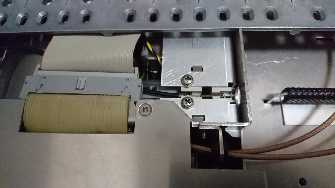

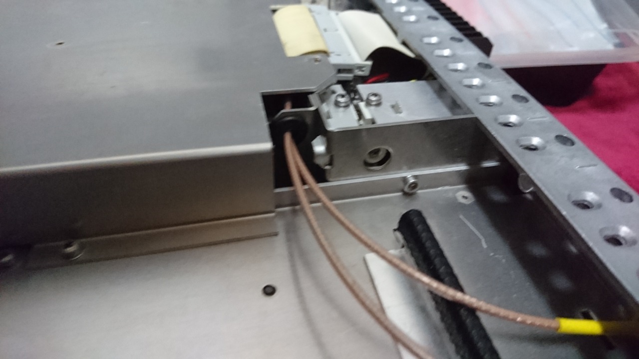

Hello UPD owners,
Some months ago I managed to get a broken UPD. I could fix it, but I have problems with the power switch, do not know how it is fixed in the case, it may be that something is missing, see the picture.
If someone could take off the bottom cover and send me a photo.
Thank you for your help!

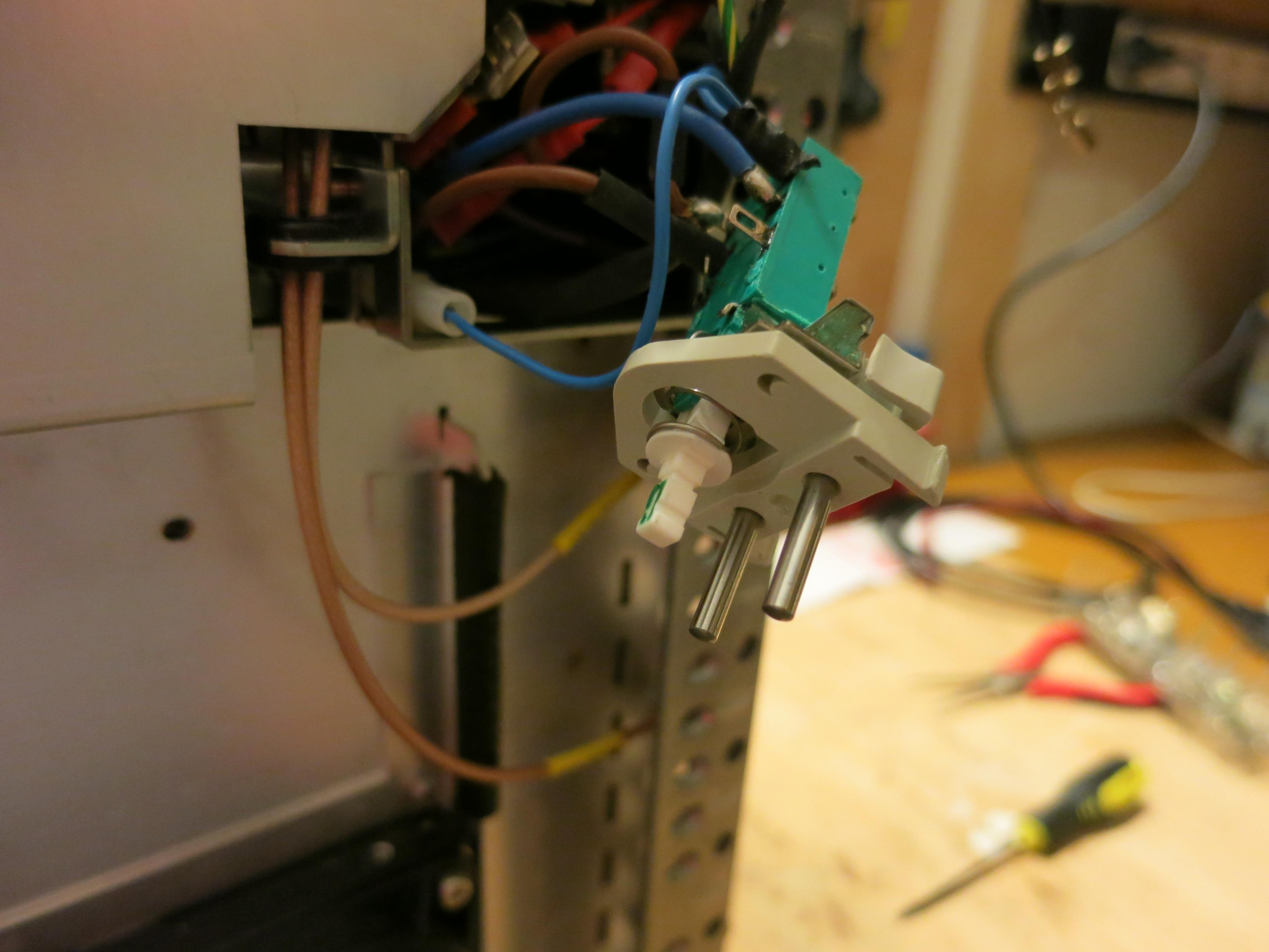

I do not own a UPD, but the Power switch here is just sticked into the Frontpanel. you see two "CLAWS" this one will have a counterpart either on the chassis or in the front panel.. I think more in the CHASSIS than in the Front Panel,. Check out the three holes in the front panel where and opposite of them you will find the slots to fix the PSU Switch.Hello UPD owners,
Hope this helps
Regards
Chris

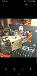

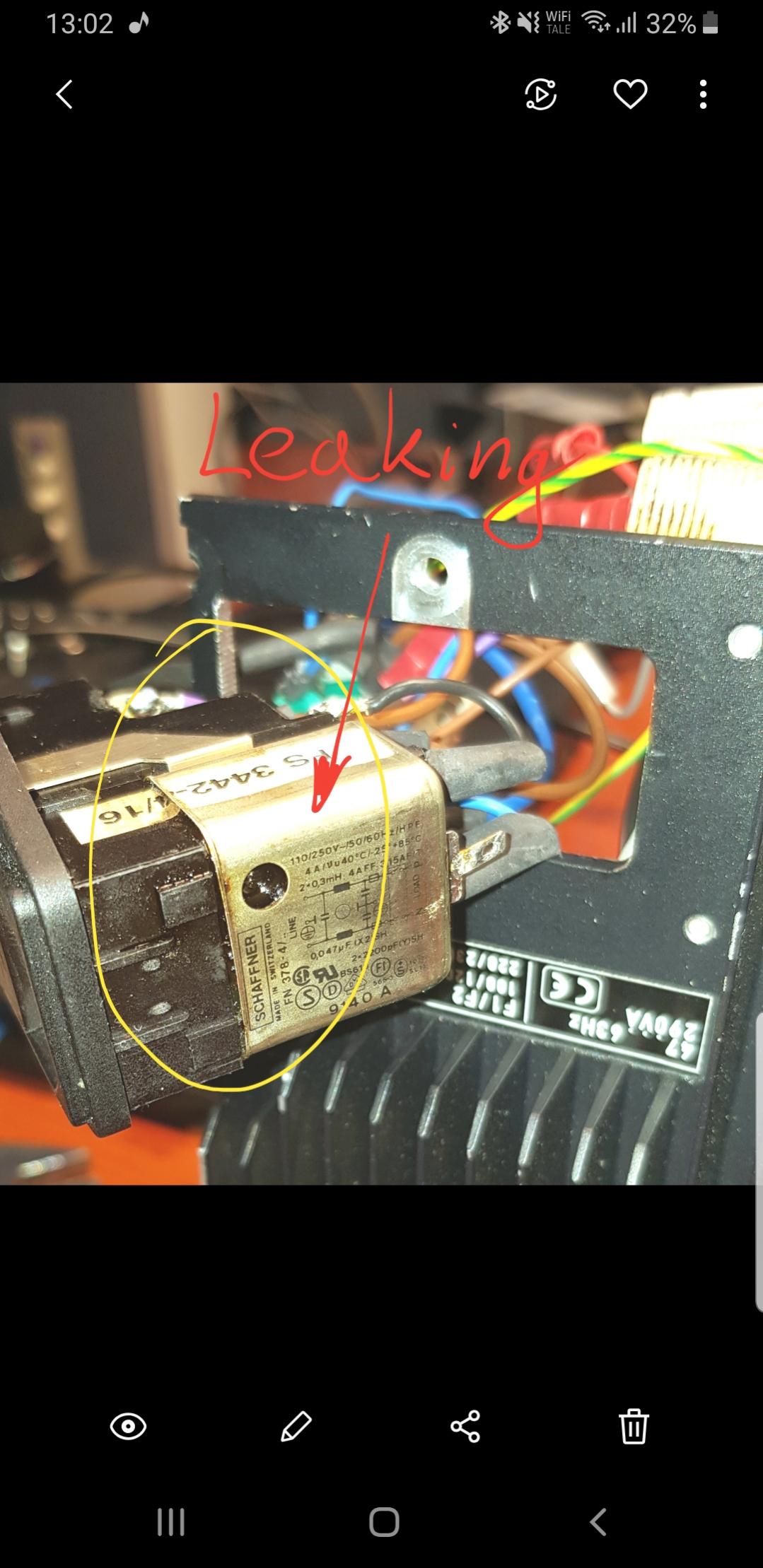

Im a proud owner of upd now🙂. The device is working but after 20min started to smell magic smoke. OOOHH No.
After opening device the location of smell come from Power supply.
Furder inspection showed that electrolyte come from EMI filter.

Have you put the numbers on the Schaffner filter into Google? We found a replacement switch for our UPV that way.

Ja ja no problem: FN378-4/21

Those line filters are known for failing like that. The issue comes up often on EEVblog forum.

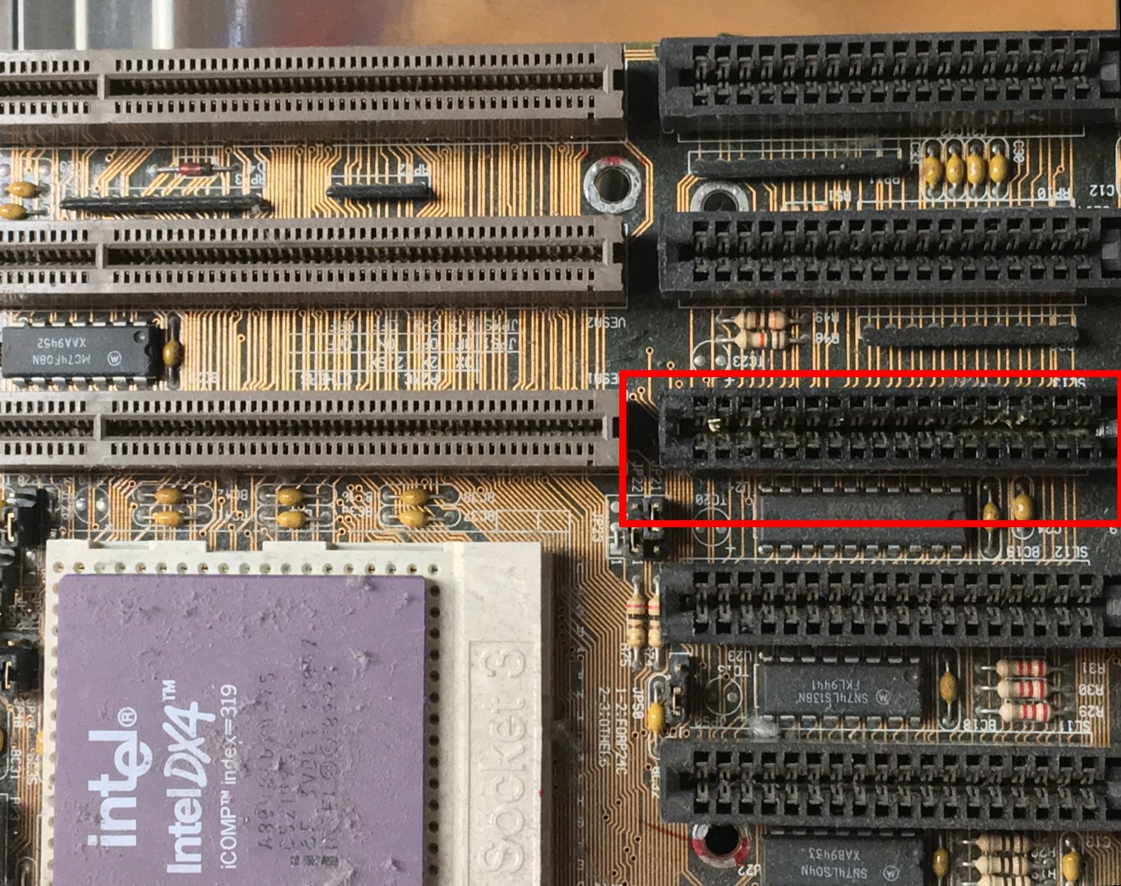

Pretty neat this thing is. I wasn't quite sure that I could get the sticky crap out
of the female contact area of the motherboard, Slot 3. Since slot 4 isn't used,
I figured I would desolder it and place it in Slot 3.
I'm glad I desoldered Slot 4 first because after my last post,
that is what I've been working on. it doesn't want to come out.
I think I'll work to get the sticky crap out of slot 3. It's nasty
adhesive and maybe some kind of derating stuff. It was placed
on a diaode pair and ran down the board also, into the female
connector.
It is what it is.

I am not sure the gunk you wrote, but you can just put the video card on slot4, isn't it?

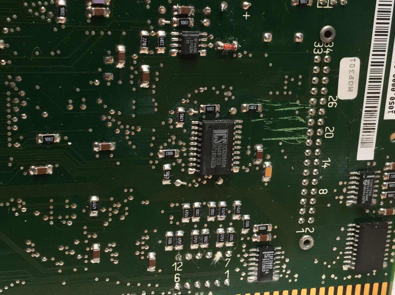

I also cleaned up the area damaged by the 035 battery--the main mother board
socket and the smaller four pin socket perpendicular to the main socket by
removing them. Following that I cleaned out the green stuff, then gently
reflowed solder over the two damaged traces.
Measuring the traces with HP 34401A revealed same resistances as undamaged
traces throughout the repaired traces (from before repair start [the pulled mutha' board
connection], two places within the repaired trace, and at the end of the repaired trace)
all measured the same resistances.

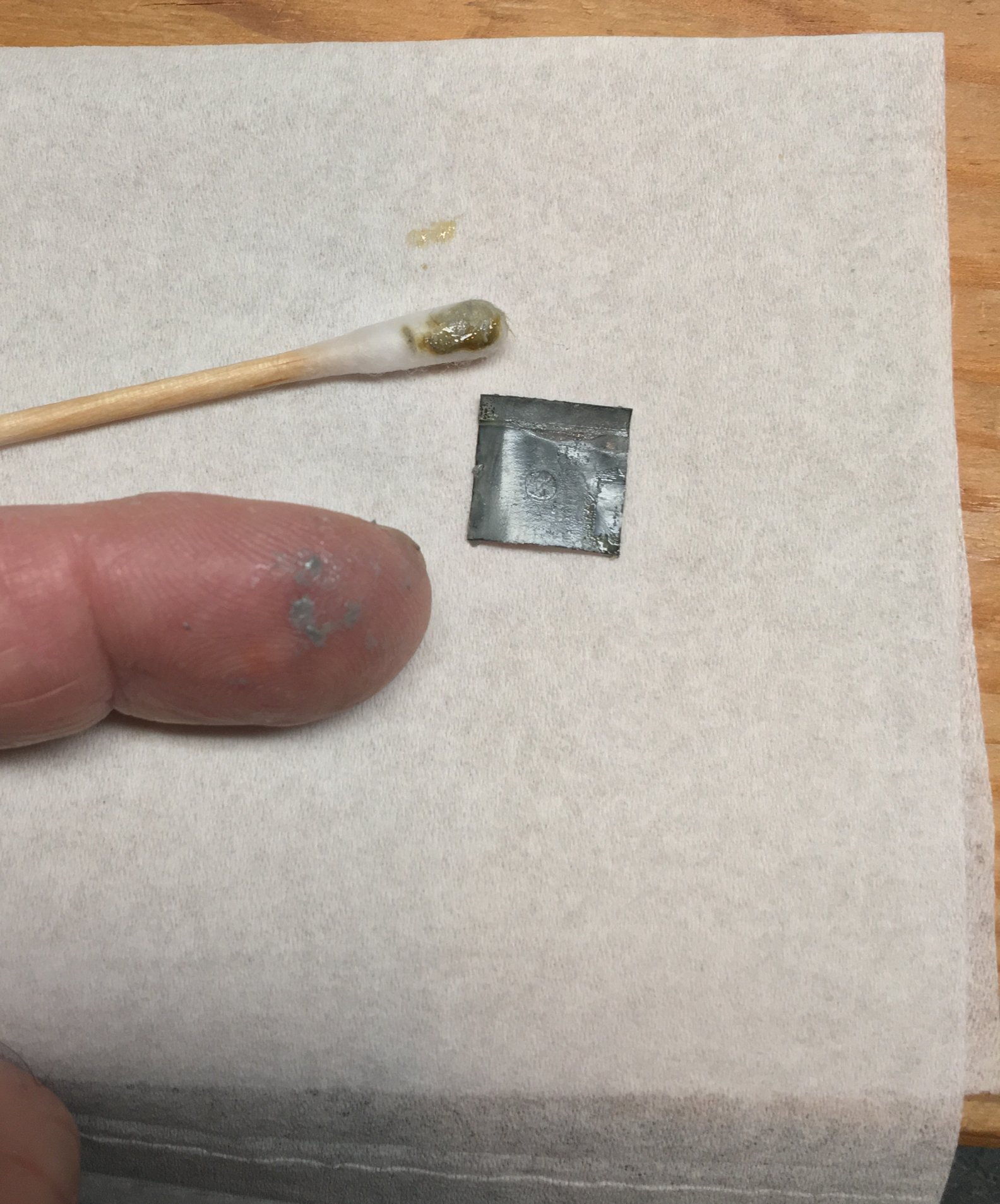

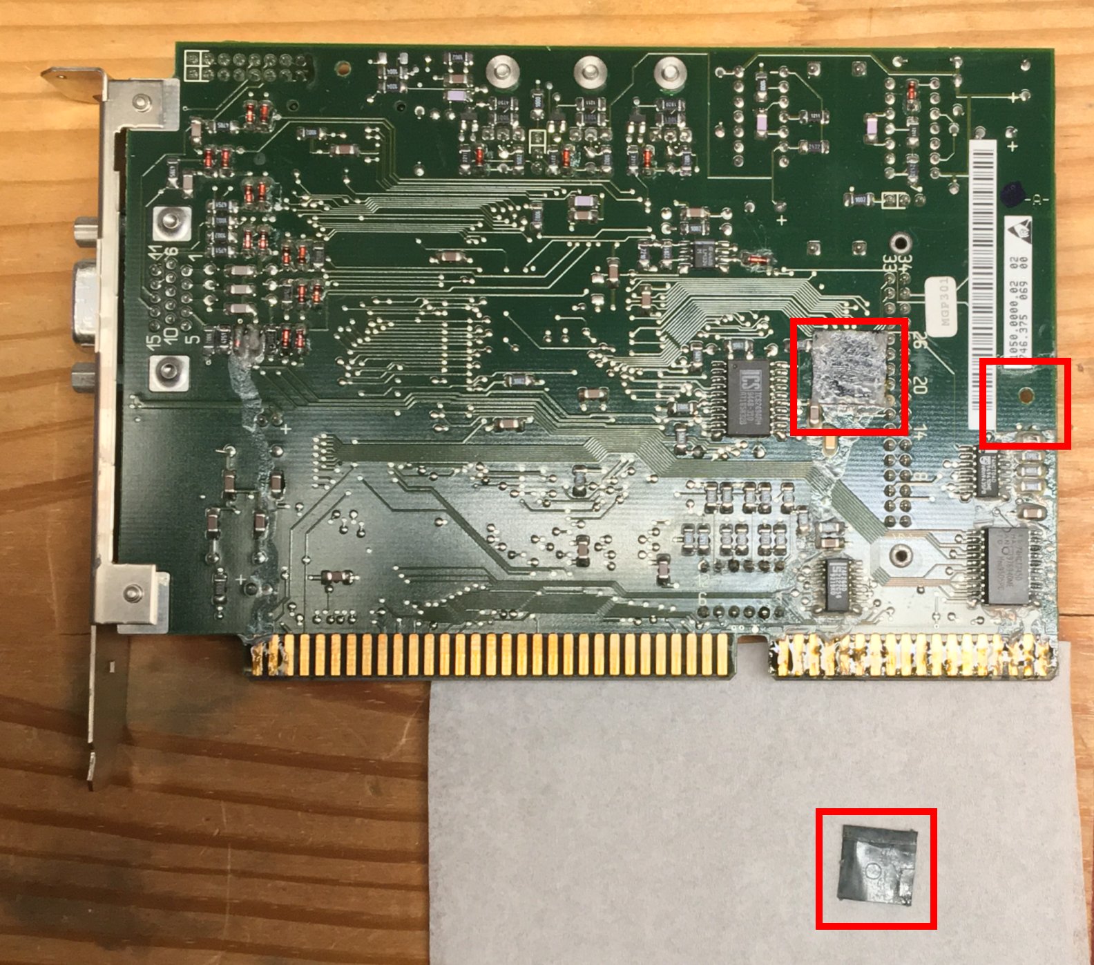

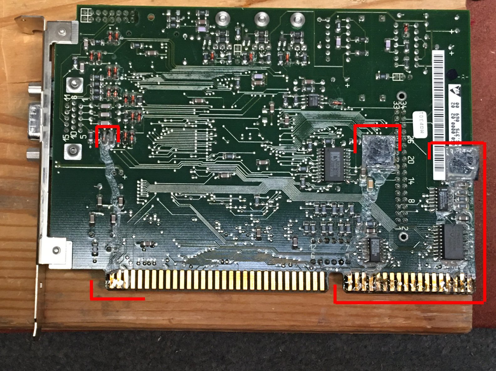

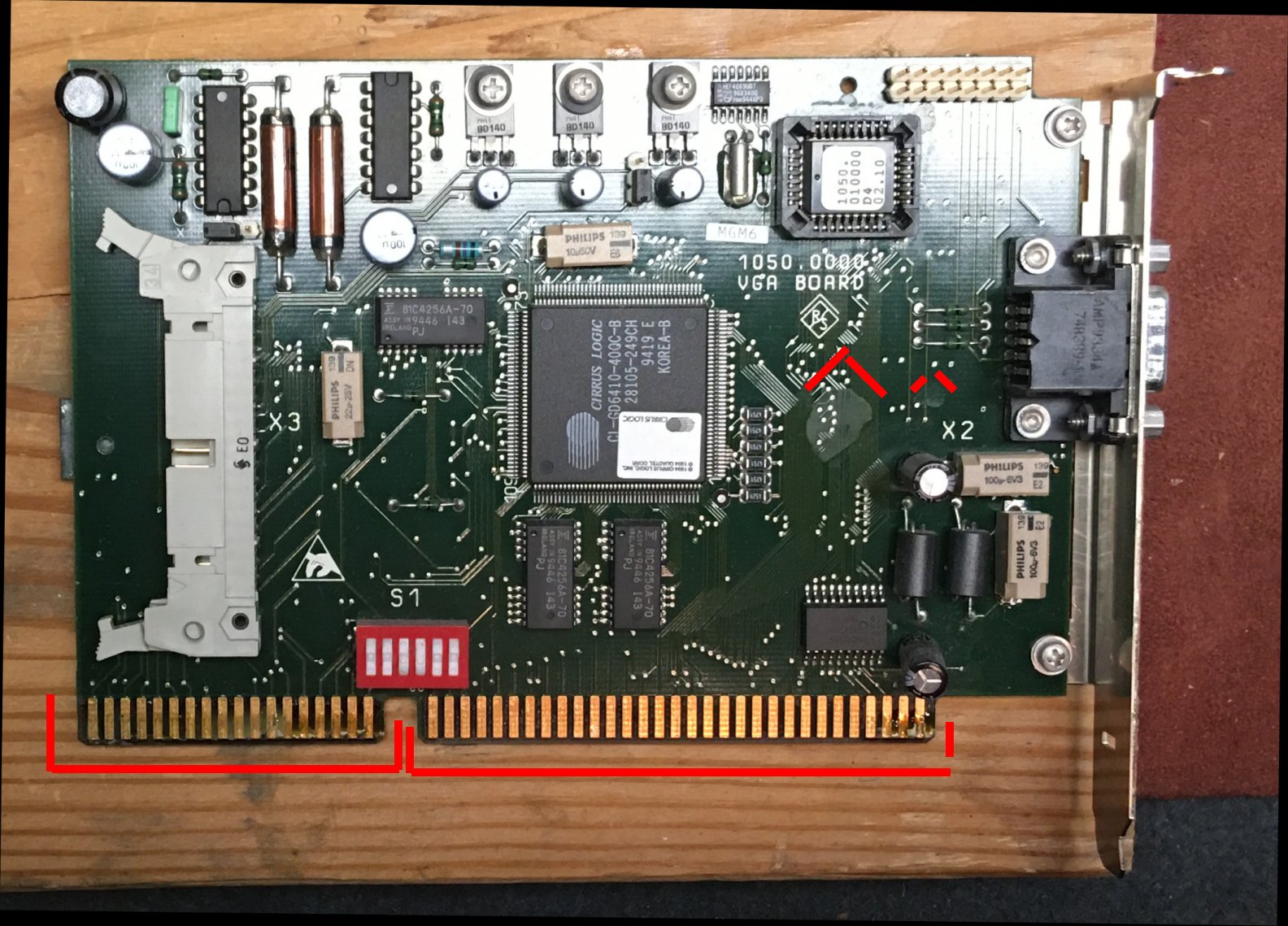

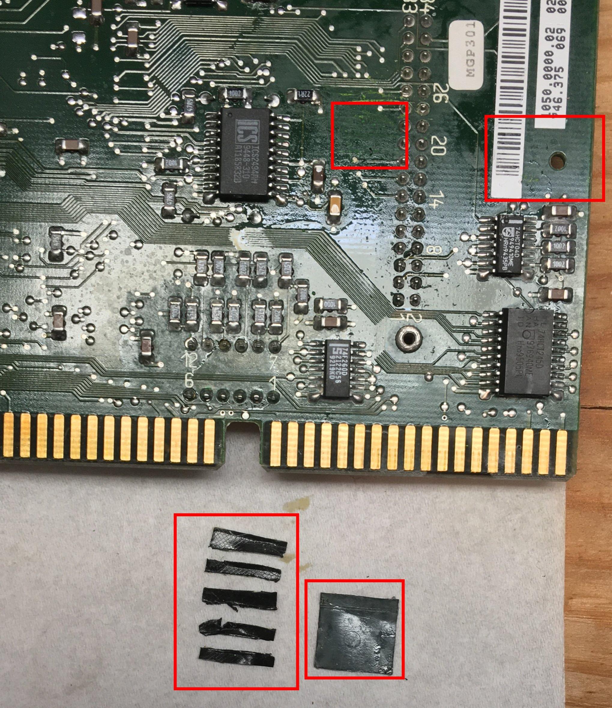

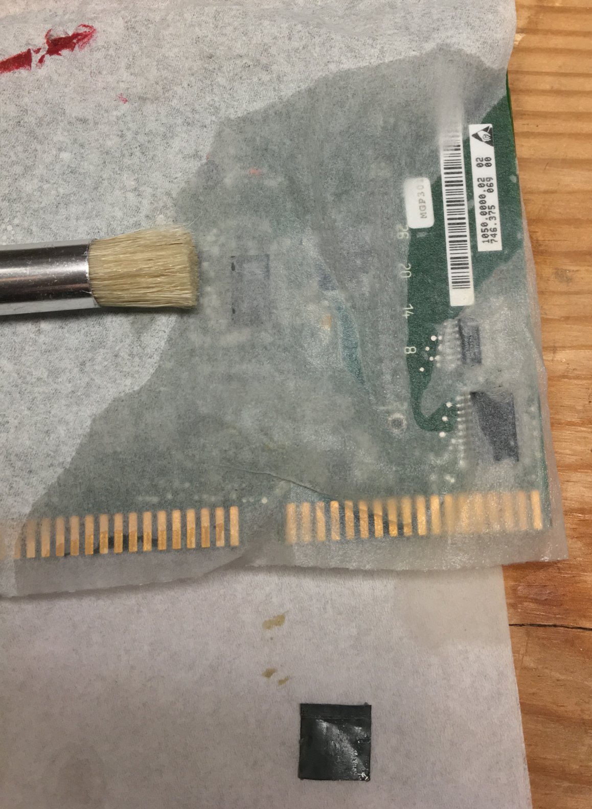

UPDate:
Here is the next batch of pics. It shows the Slot 3 VGA board
and the Grey Sludge on it. Then various pics removing and
cleaning the board with ISO, Bristle brush and KimWipes.
There is also MG "Q-tips" which I don't like that much.
I ran out of what I like (Bamboo Gun Swab "Q-tips)
because they are stronger and lint free..
This grey sludge looks similar to arctic silver derating
grease. Why else the two black tabs coated with it and
why else the two diodes coated with it?
The stuff that ran down seems to be a combination
of the arctic silver and adhesive used to keep the black tabs in place.
Solder paste that was applied after production
run and someone forgot to remove it?
What say you?
