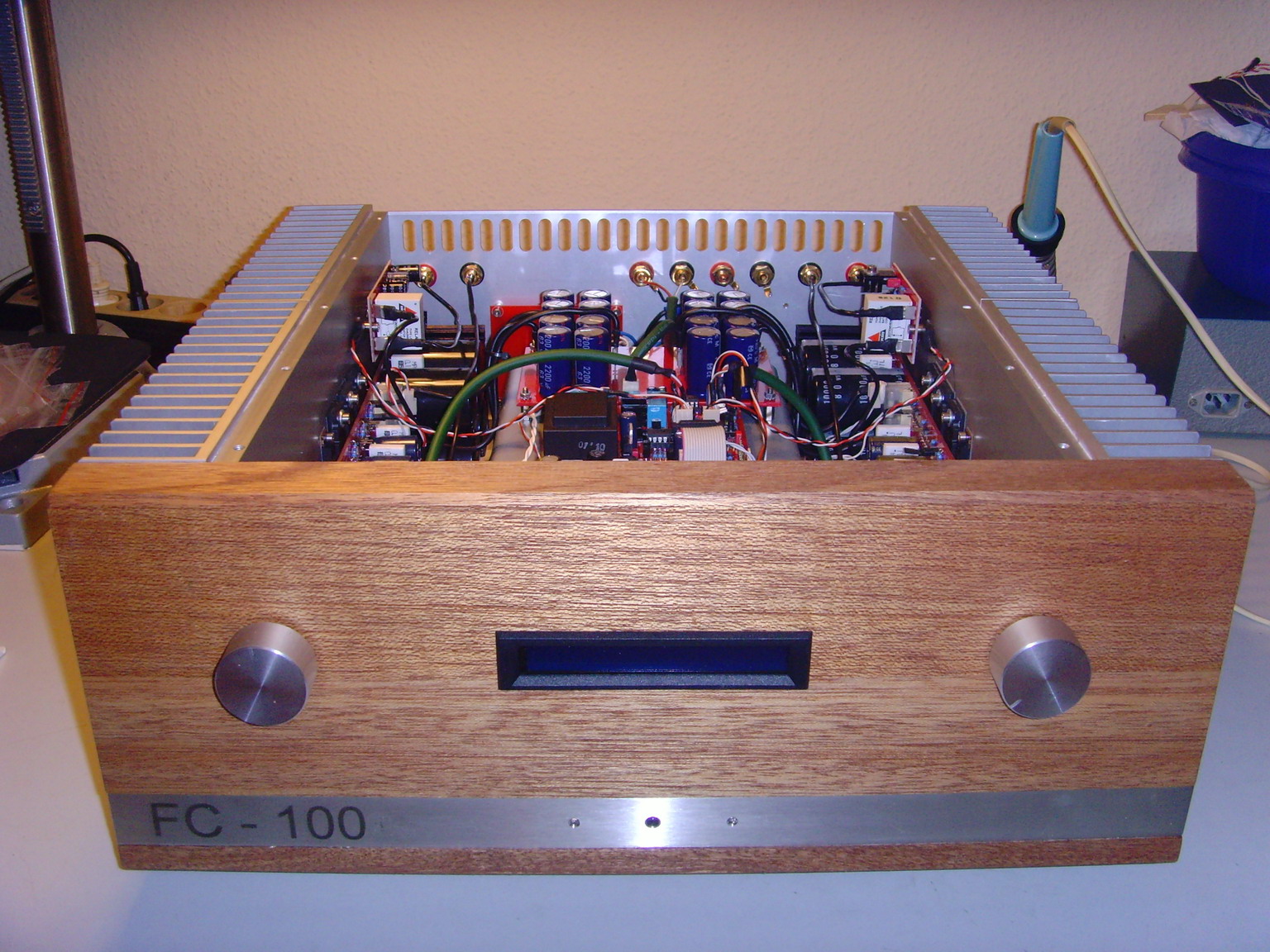

Paul, if you like, I will assist you with the build of a nice case for your FC-100.
The FC-100 is worth giving the nicest-looking case to it!
It is the very best DIY-amplifier that I have ever listened to!
This is how I did it (see attached image).
I you like my case's "general" design: you need a couple of small ALU-brackets, three 2mm thick ALU-plates (top, bottom and rear) and a wooden front plate.
Since I have integrated my passive PRE into the FC-100's case "on the second floor" (making it an Integrated Amplifier), I needed to install a LCD into the wooden plate.
I should have done the insertion of the LCD into the wooden front in a better way, I know. The black plastic frame really looks nasty!
Best regards - Rudi
P.S. The "silver" knobs and intarsia do "not look good" either. I would have done the front in another way today!

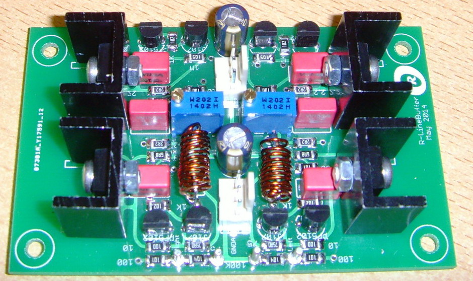

Does anybody known of a suitable point to add a line level sub woofer output without any sonic impact? I know this would normally be done in the preamplifier but I am using Rudi"s passive VCpre and don't want to load it up. Maybe The NFB point could be used?
Paul, if you are afraid of "overloading" the LDRs of the VCPre, I will send you a line-buffer PCB, my modified version of Calvin's buffer, a very, very splendid buffer - for nothing 🙂 !

Many thanks for that offer. I am sure it is a great buffer. But I am trying to keep the signal chain as short and simple as possible.
At the moment its just DAC/CD -> VCPRE -> FC100 and it sounds sublime.

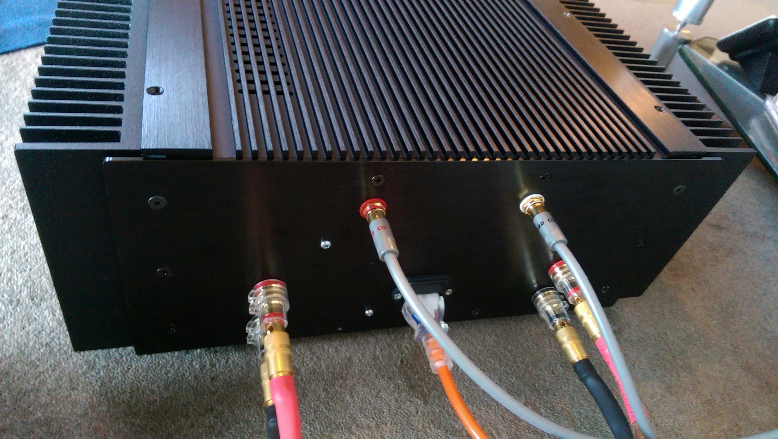

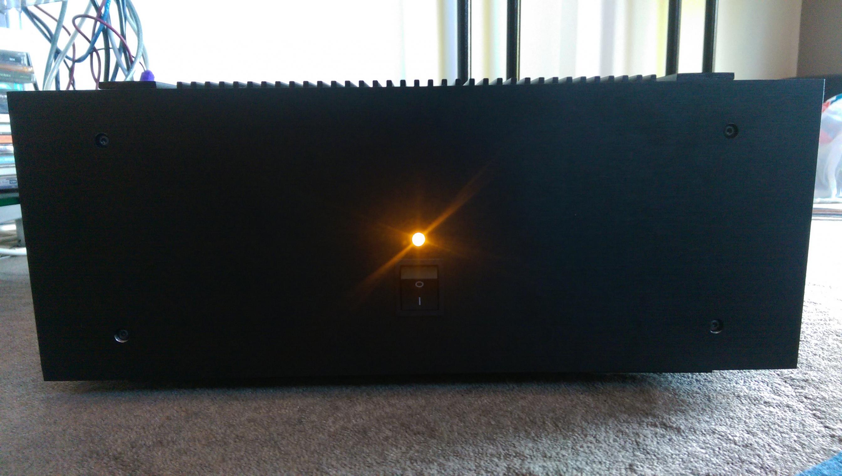

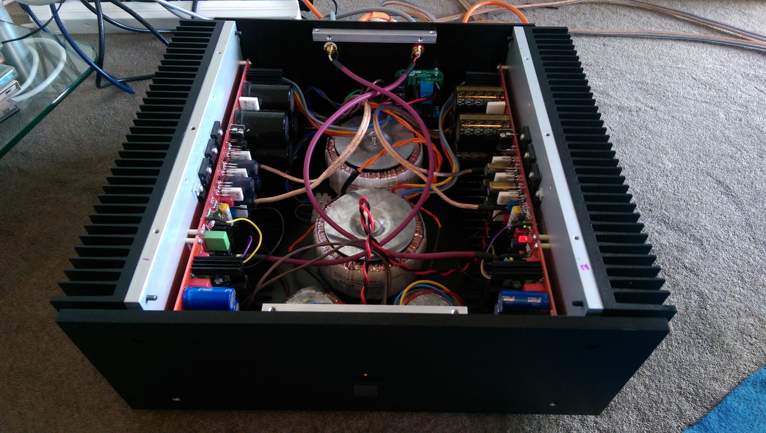

Beautiful case work! Where did you source the top plate?
Regarding the internal wiring, I would move the input lines away from the transformers as far as possible.
Thanks Pooge! It is an ebay case. Quite expensive but the FC-100 deserves it I think. I had to "supersize" it a bit with bushes as I am using Conrad heatsinks and mounting plates. I do hope to tidy up the internal wiring when I get a chance. It is hard to stop listening though!
See : New 2014 Full Aluminum Class A Amplifier Chassis Preamp Enclosure 400 150 373mm | eBay
