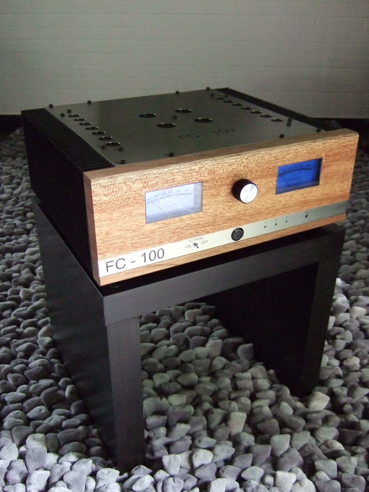

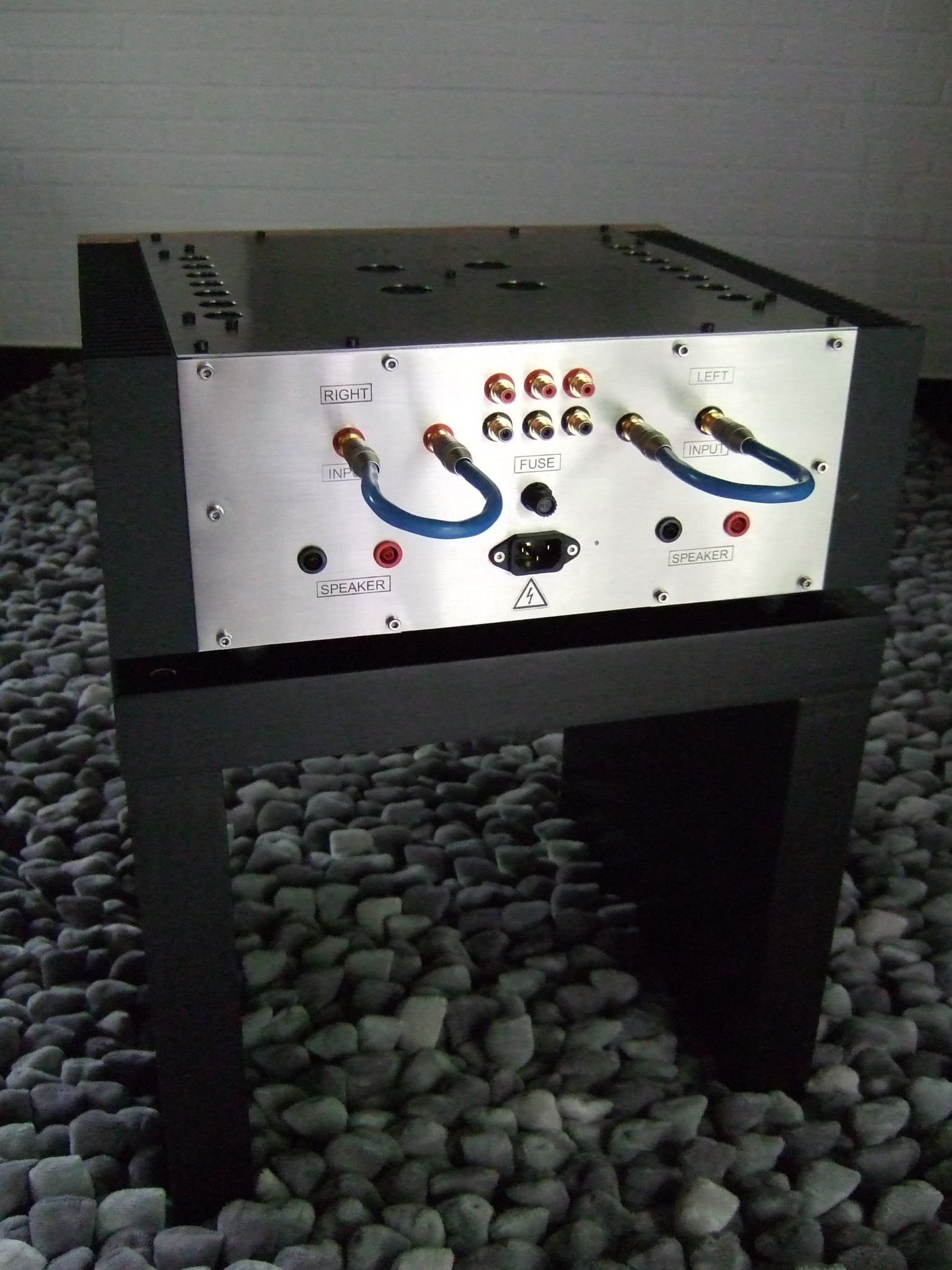

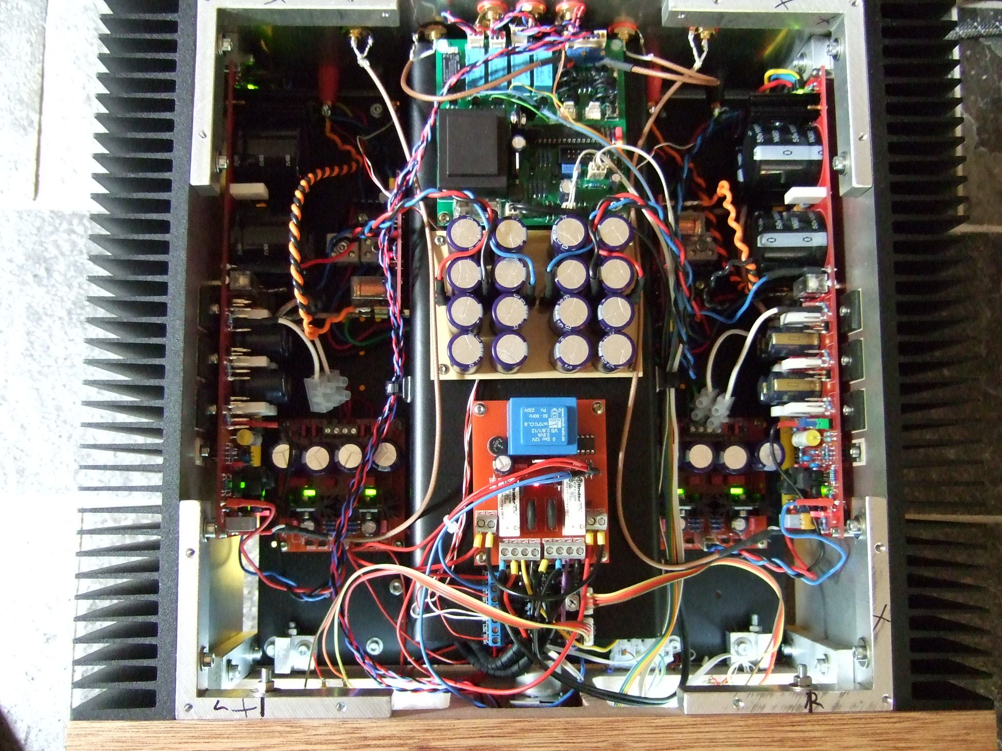

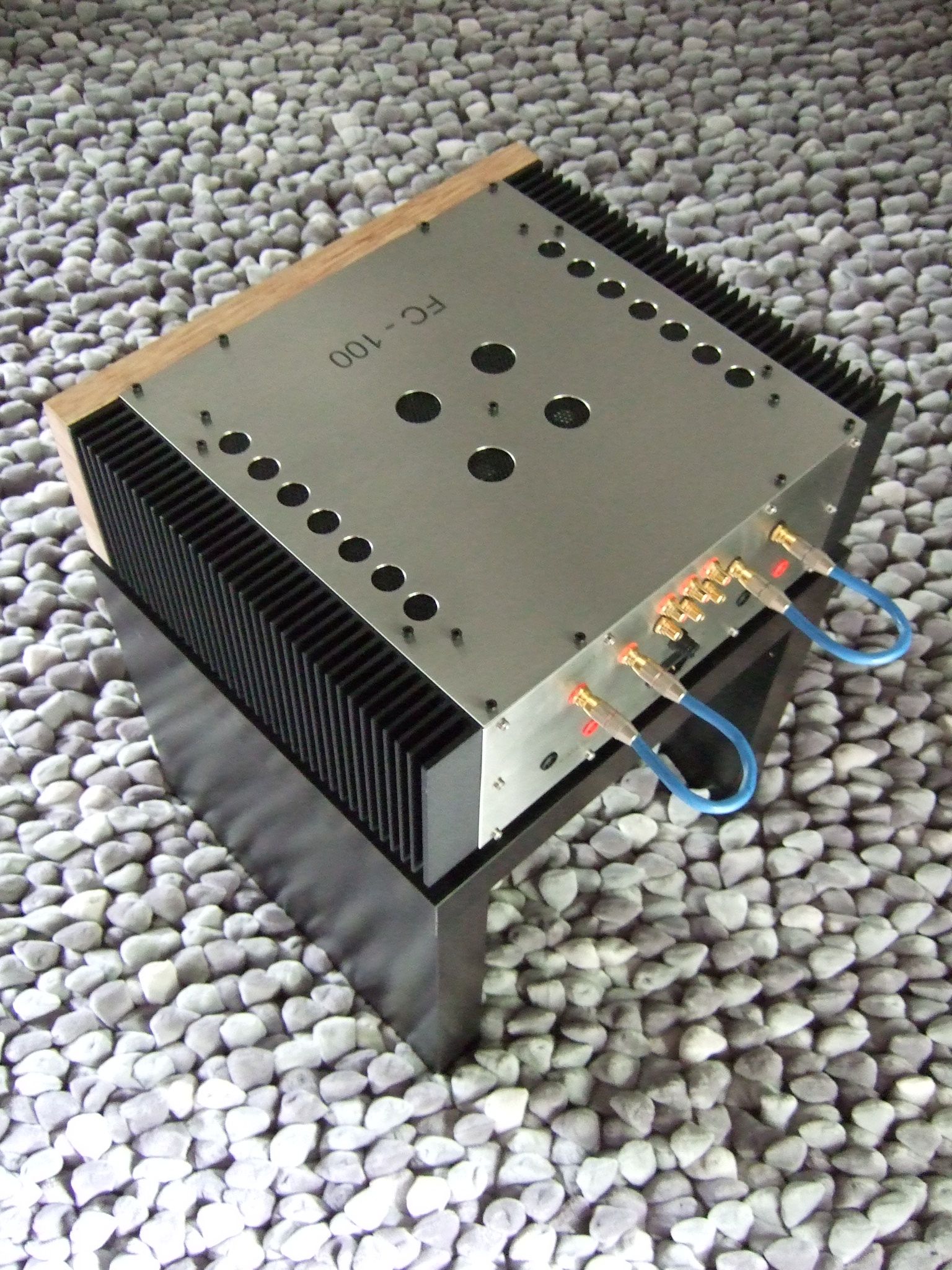

Hello,
Here are some pictures of my finished amp.
The Lightspeed Attenuator is integrated as well but I have the option to separate it.
So it´s easy to try things like an amp or pre-amp.
Thanks to Rudi for his support!
Regards
Andreas

Congratulations on a fine finished project.
Looks gorgeous.
Can you tell what is your case size inside?
I'm facing some heat dissipation problems and i try to how to see how are doing others 🙂
Looks gorgeous.

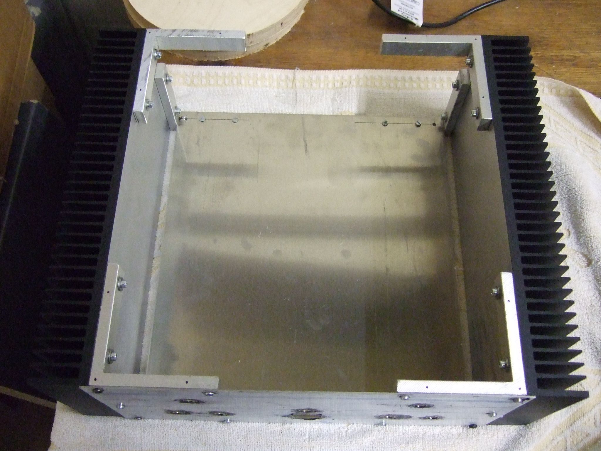

@atupi
On the picture you can see how it works.
I took 2 Conrad heatsinks (350x150x60mm), 8 Aluminum angles and a plate of 3mm Aluminum.
The plate doesen´t reach the heatsinks there is a 10mm slut.
With the holes in the top plate there is enough air circulation.
At first the amp has to play some hours.
Later I will write something about the sound in comparsion to an Aleph J and Symasym (at this moment ...).
Regards
Andreas

I've recognized Rudi's ideas 😉

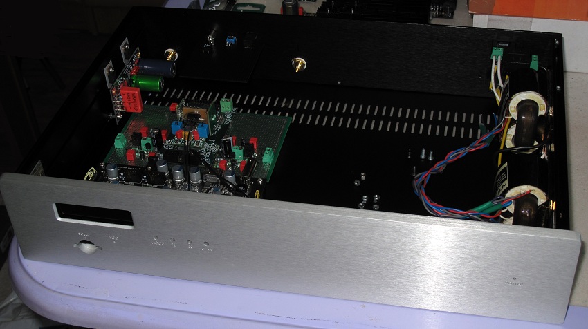

Smart move with that 10mm clearance. I will post some pictures in few days when i will have everything installed inside.
What about grounding scheme? I know there are different approaches, my case is not connected to the FC-100 right know, what would be the best solution ?

Adrian: Andreas is a DIY-friend of mine and to build the case like this and leave a 10mm space in the bottom plate for better air circulation is his idea.
I approve his idea very much.
Best regards - Rudi_Ratlos
Make an AC ground to common, not DC. Connect the common to the case via a film cap - 1uf or so.

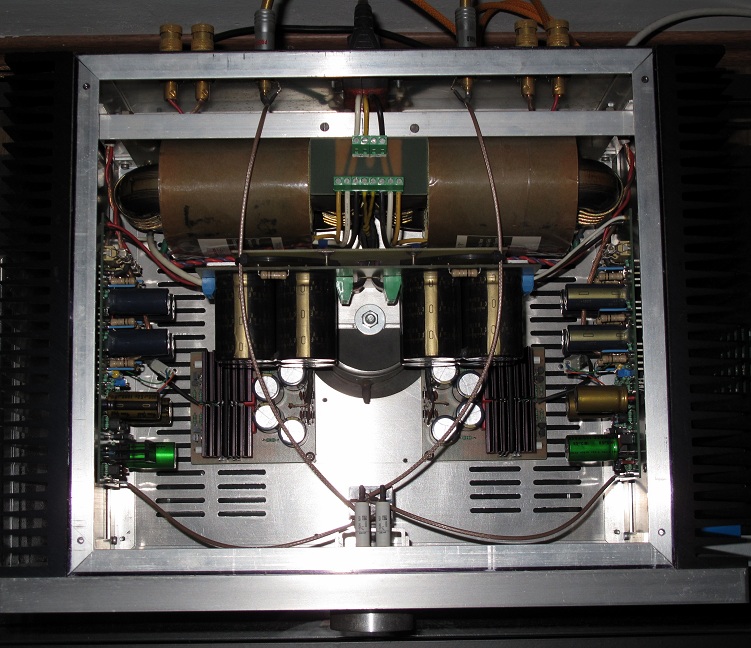

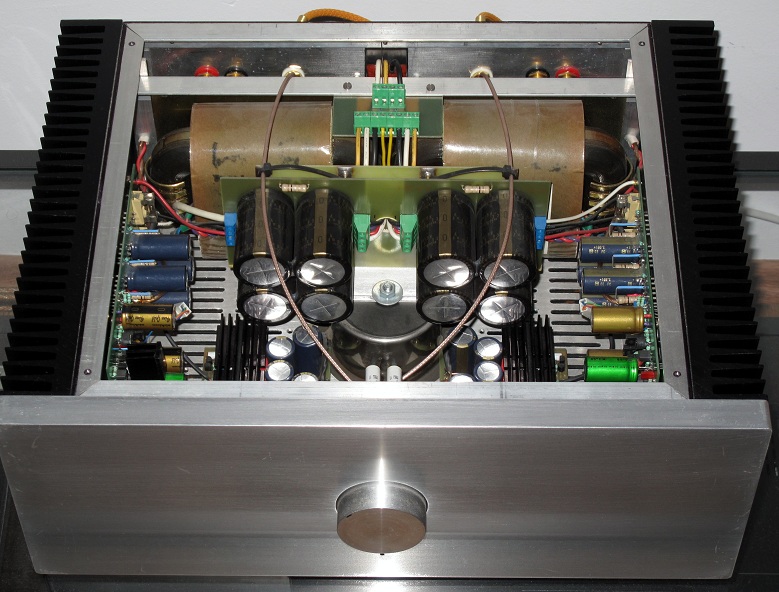

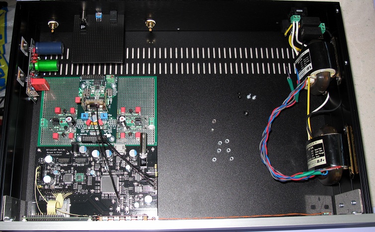

Guys,
Your builds looks gorgeous.
This is mine, more than 5 years old now.
The pictures that doesn't represent RMI-FC100 are from my work in progress project 😀
Mihai is a R-core fan 😉
It does sound much better than toroidal transformers in any audio application.
Mihai:
From where do you get your r-core transformers?
thx,
mlloyd1
From Paris
