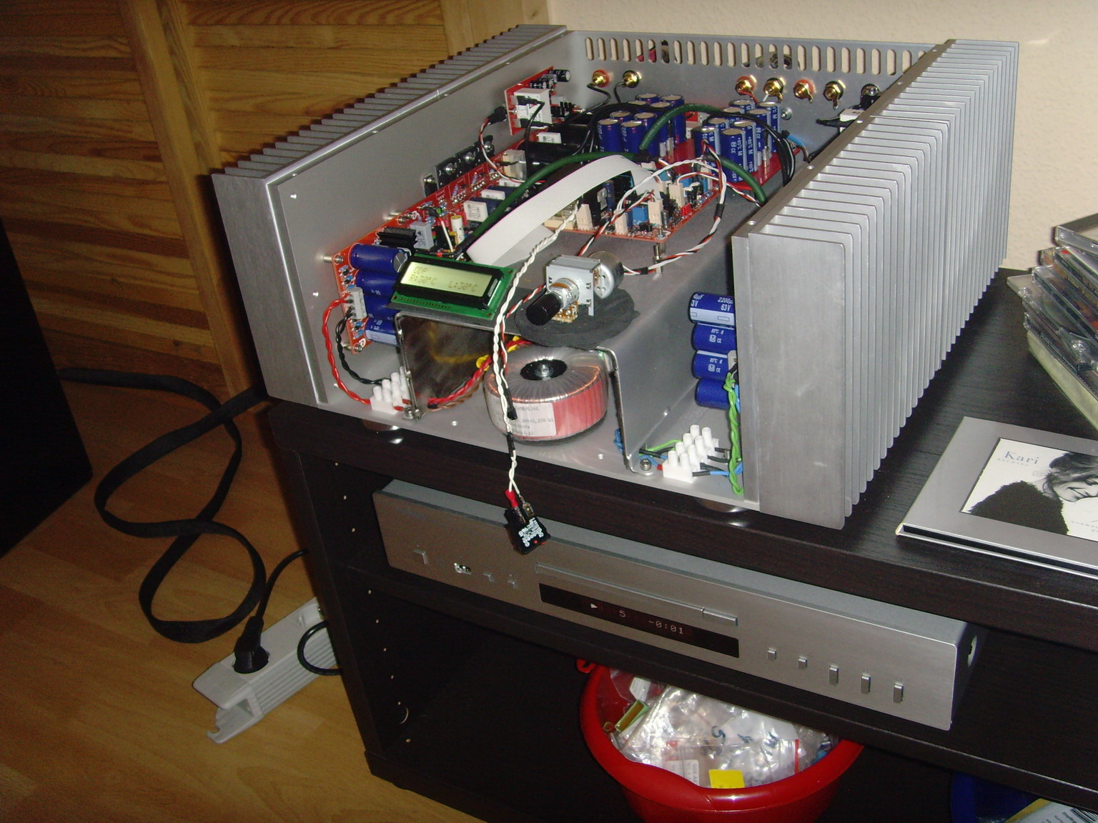

Few questions abut assembling FC-100 into the case.
As long as i have 4A fuses onboard do i still need a fuse for the primary of the transformers?
Do you think a multifilar cable of 1.5mm diameter to connect secondaries of transformers to the pcb's will do the job well?
I've attached also a picture with my plan of positioning the components. The two power toroids are in the middle under the shunts pcb into a stainless steel case (Thanks to Rudi's idea) and also saved some space.

Adrian, your build looks good in my eyes, but: please do not waste space! Maybe you will need some space for additional PCBs in the future!

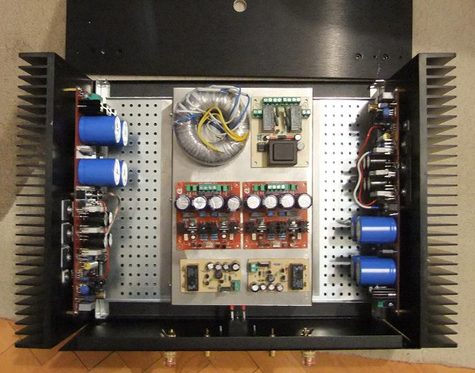

This is how I did it (see attached image).

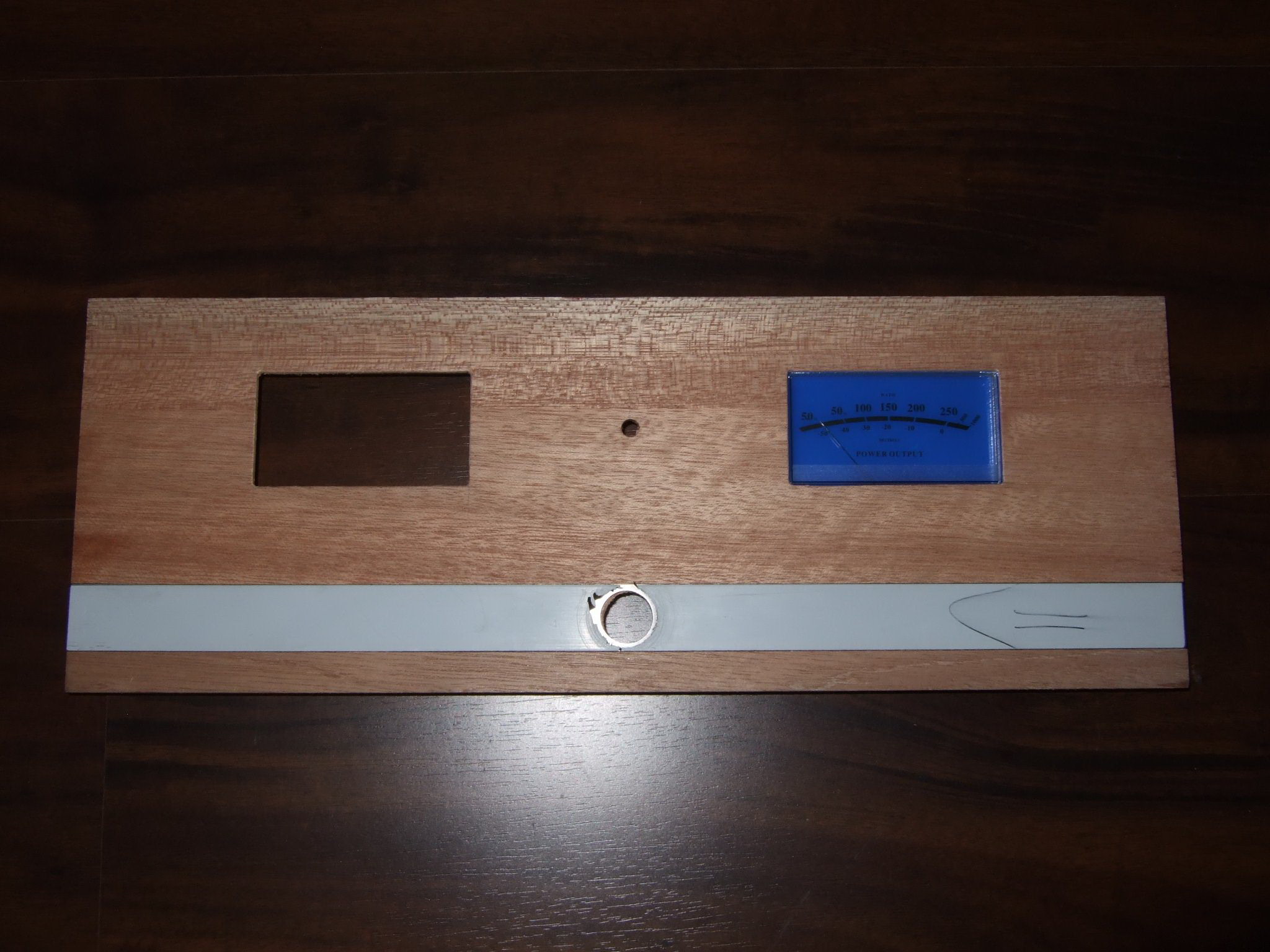

A good DIY-friend of mine is offering me one of two solutions for the front panel. The type of wood is called "Meranti".
I can choose between the "McIntosh Look" and the "LCD Look", but I still cannot decide.

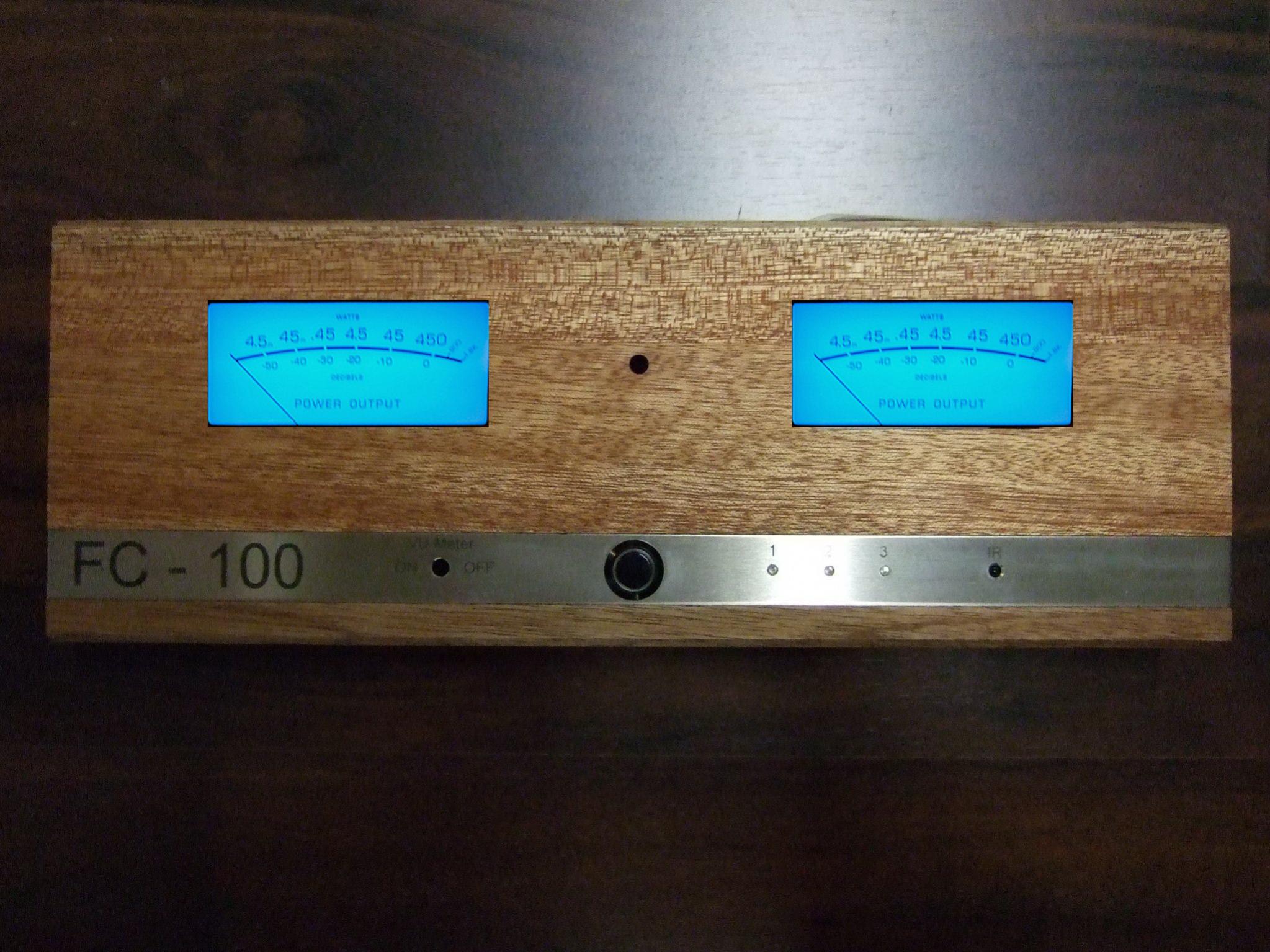

I am very unhappy to see your troubles, Adrian.
In the meantime I go on and do some "wood-work" on the front-panel of my FC-100 - case.
Best regards - Rudi
