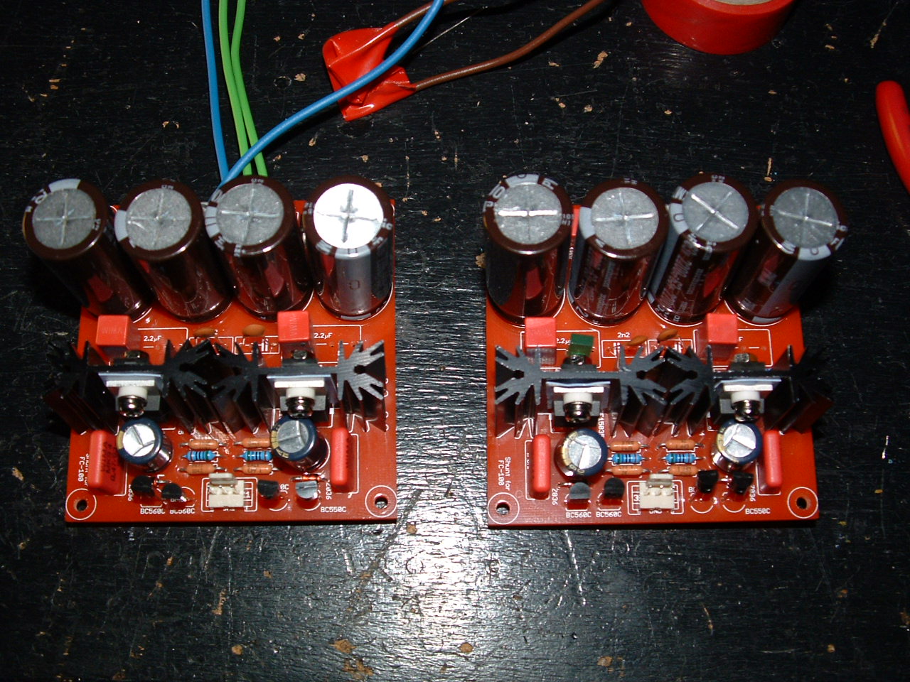

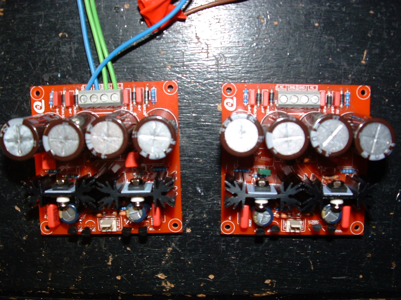

Now i have the shunt transformer i decided to test both shunts that i made months ago ,negative works 37.8 but positive nothing zero volts then smell smoke switch off ,looks like r33 resistor burnt and led looks dead ,this happened to both shunts🙁 i have check and checked .can someone please advise
Rudi received resistors thank you
I took my time,,,,the led and r33 removed thanks john

The Rudi shunt regulator boards are OK.
It must be an assembly error.
Well almost OK,
either omit the film caps across the diodes or substitute a cap + resistor in series for each cap location.
Don't invite oscillation of the supply due to stupidly inserting a cap with an unknown inductance !

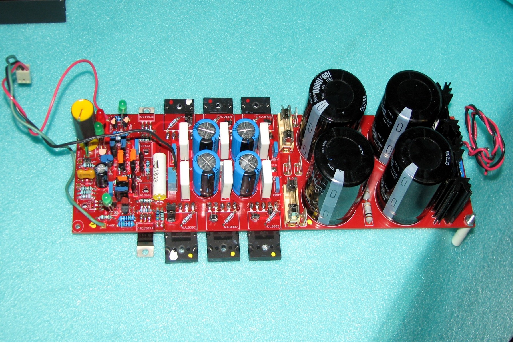

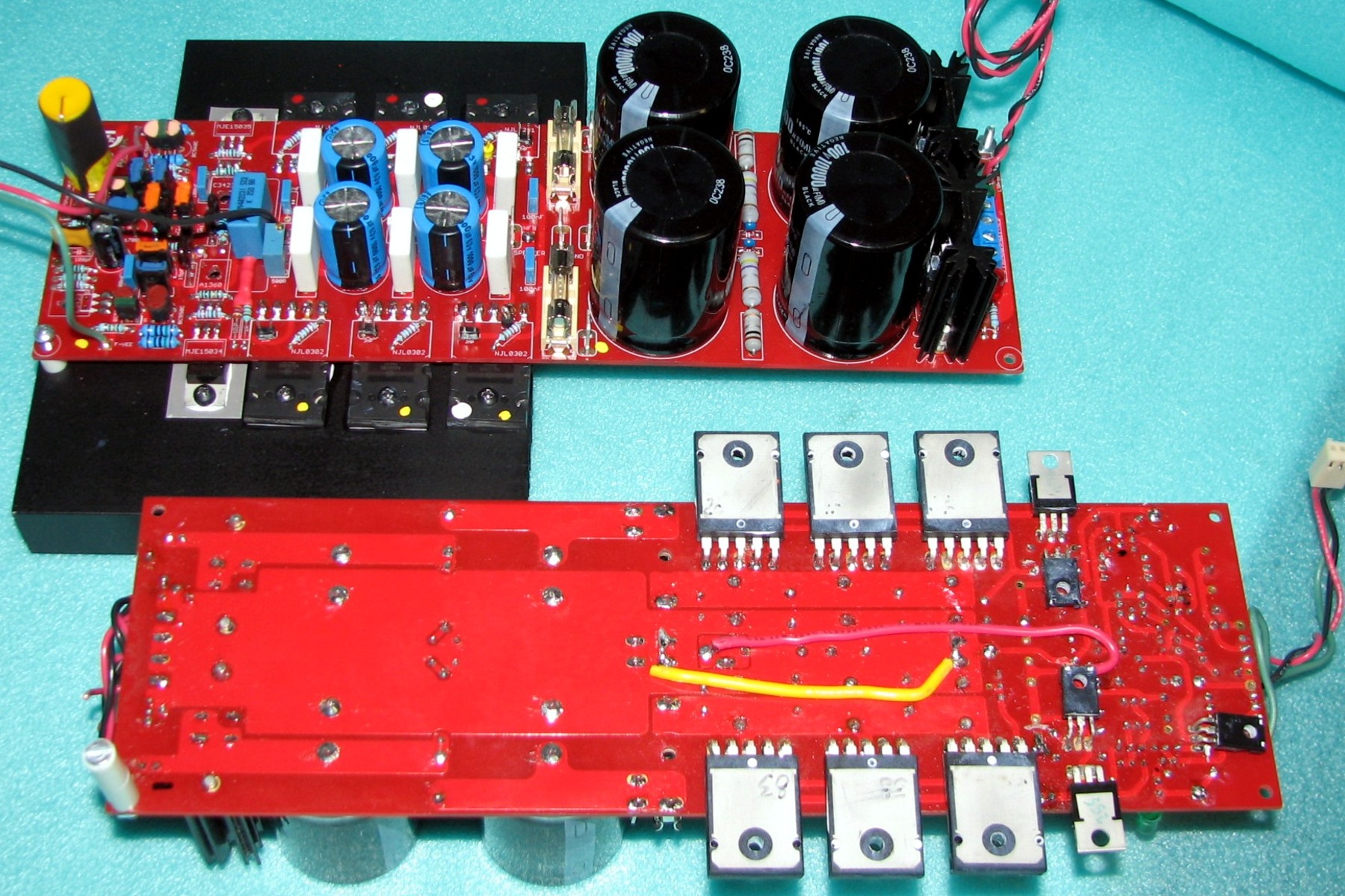

Rudi, here are a few pics of my FC100 build. First pic is board with temp heat sink for testing with corrections as per revised build manual and your email. Second pic is of the 2nd PCB undergoing diagnostics...
Unfortunately, I am having problems with both boards so hopefully a common error. At this stage I have only replaced the LED to insure they were inserted with correct polarity as non of them light during testing. The back end and front end PSU's are fine.
All transistors were tested and matched prior to assembly. So far, the only "clue" I have is that when I power up the back end slowly to 35VDC using a variac, the bulb tester lights up dims and goes out but no LED's on front end, nothing heats up and no smoke. Can't adjust the bias. If I power up to 35VDC right away the bulb tester stays on and the 15034 heats up???
If anyone as ideas before I start pulling things apart, I'd love to hear them. Sorry to have to post this in the GB tread!

Jean, I had the same "results" as you have, when I switched on my prototype for the 1.st time.
I advise you to do the 1.st power-on in 2 steps:
1) Remove the fuses of the on-board fuseholders, remove the backend-transformer and only connect the small 34VAC transformer via the bulb-tester.
Then power-on! Do all the LEDs in the frontend shine? If you have an oscilloscope, you can even apply a sine signal to the input and see the output
at the bases of the pre-drivers.
2) Remove the 34VAC-transformer from the bulb-tester, but leave it connected to the frontend!
Insert the fuses into the fuseholders and connect the backend-transformer via the bulb-tester.
Insert jumpers on 2 (!) ThermalTrak - bypass connectors, be sure that the potentiometer is preset to 0 Ohm, and do a short on the input.
Then power-on.
The DMM, which is connected across 2 emitter-resistors (between MP1 and MP2) shoud say: 0mV and the light of the bulb-tester
should shine (a little bit).
Are you able to increase the voltage drop across the 2 emitter resistors?
