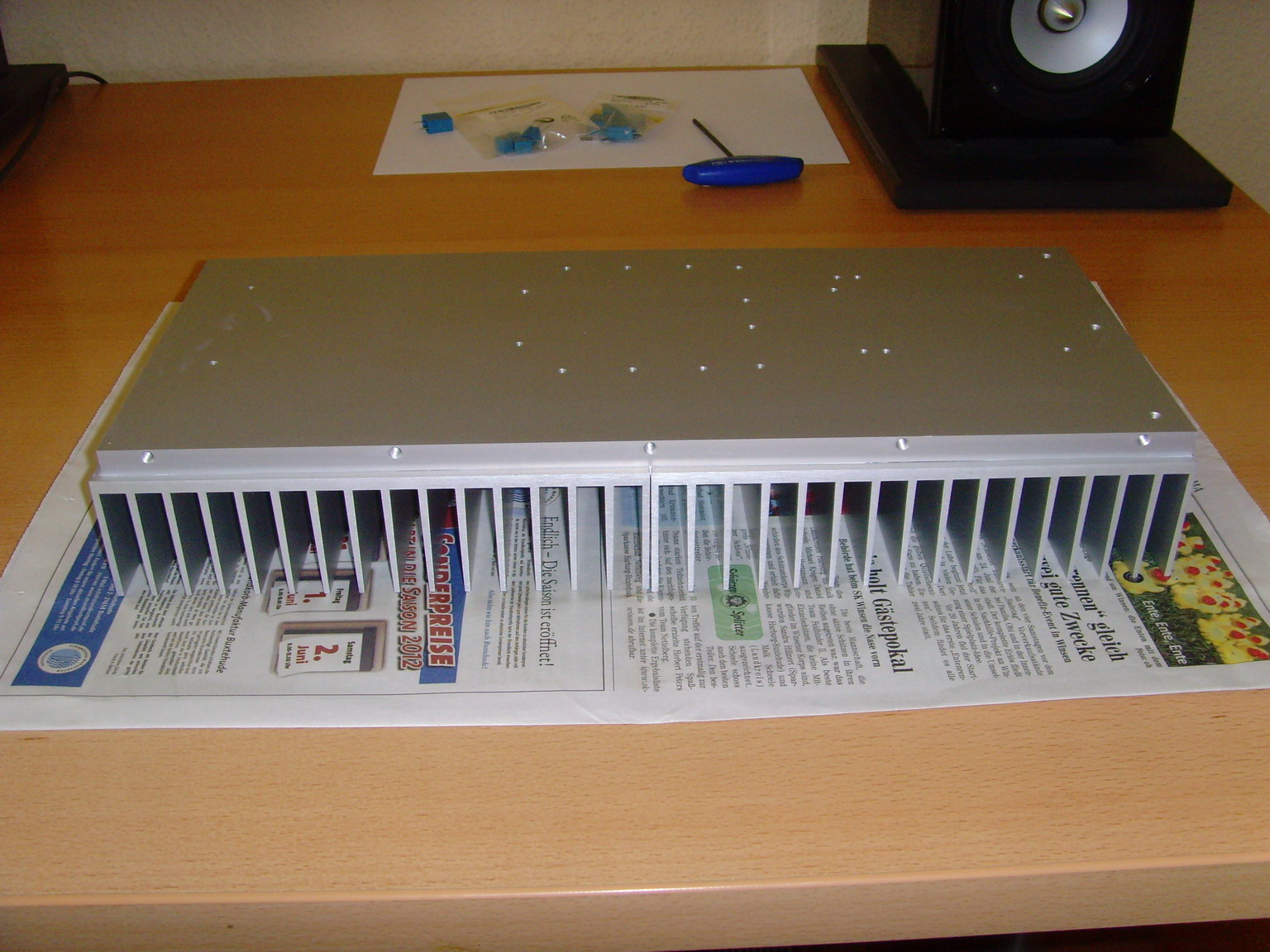

Gentlemen, I am currently performing a group-buy for the FC-100 in the German ANALOG-forum, and I am discussing with the German DIYers,
how a sufficient, low-cost DIY-case for the FC-100 can be built.
We are currently settling on this solution:
http://www.abload.de/img/image11ksar.png
Buy two ALU-plates, serving as side-panels, dimension: about 380x140mm, 8-10mm thick.
Connect heatsinks, whatever is available and adequate, for example this one, cut in the middle, resulting in 200x125x40mm:
http://www.abload.de/img/kk24sjw.jpg
to the "hot-spot" (where the NJL-transistors are mounted) on the outer side of an ALU-side panel and the FC-100 PCB to its inner side.
I think that this solution will do it - and is low-cost as well.
Best regards - Rudi_Ratlos

use a thinner side panel, 2mm to 3mm would be sufficient.
Bolt the heatsinks to this side panel.
Mark out where the output devices will sit.
Remove the side panels and cut holes right through, so that the devices can be mounted in direct contact with the sink. Where the side panels bolt to the sinks will give a bit of extra dissipation to the sink and thus the devices will run a bit cooler.
Adding a plate between the devices and the sink does not always result in better cooling.
I think most arrangements with an intermediate plate will actually be worse than without the plate.

Andrew: I made the experience that the cooling solution that I suggest, does its job very, very well!
Have a look at my construction (attached picture).
I am playing music very loud, for hours, and the 10mm thick ALU-plate does not even get "hand-warm", as well as the attached heatsinks do not!
I applied a layer of thermal grease between ALU-plate and heatsinks and screwed them very tightly together using 12 bolts (per heatsink).
I therefore believe that my construction even is "thermal overkill".
A 6mm thick ALU-plate with heatsinks attached to the hot-spot (where the NJLs are mounted) will do it as well.

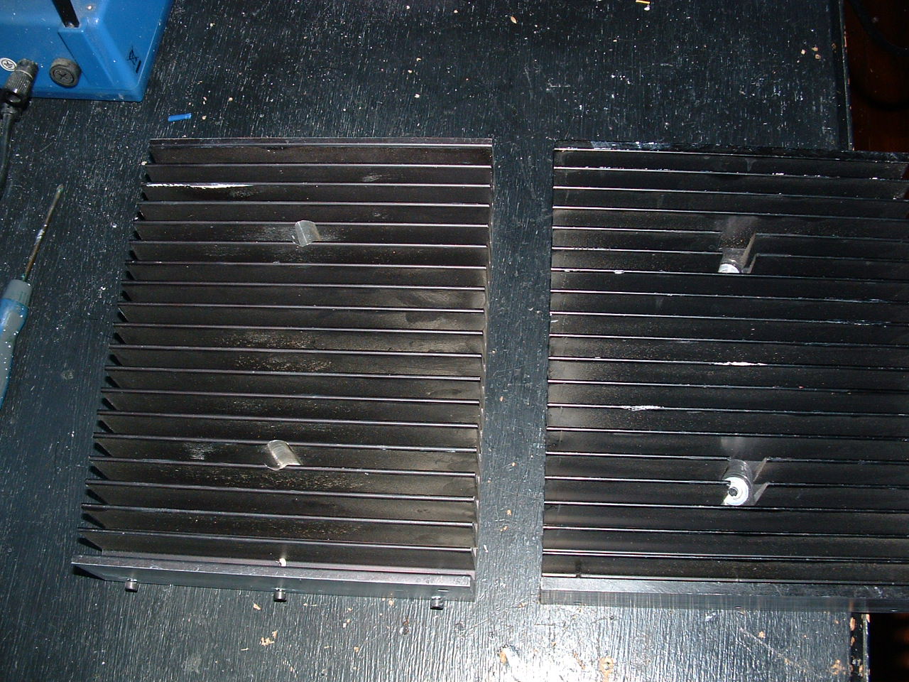

Sure it work well. I have always did that on my previous projects.
I am now building a new FC-100, and have ordered a case on eBay, and i think it will be on the limit for the heat sink... Wait and see
They look similar to mine.
I have a pair of 250 high by 200 wide by 40mm thick. 20off 30mm fins on a 10mm backplate.
At the full 185mA and supplies at +-42Vdc (quite a bit higher than using a 25Vac transformer) the sinks are too hot to hold longer than about 5 seconds at the cooler edges.
The lower voltage of the standard build and the 160mm high will probably end up at about the same temperature.
The 3pair output stage is very robust and can be very hot and yet still stay within an acceptable, good reliability SOAR.
Don't be too afraid of a sink that is just a bit too hot to hold.
Too hot to touch is a bit hotter.

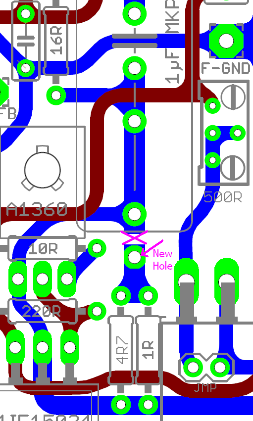

Gentlemen, I have sent you an EMail an hour ago telling you about the mishap (error) in my FC-100 PCB layout.
I have posted a bug-fix ("free-air solder-style") in my EMail.
Another, more professional bug-fix would look like the one in the attached image.
Cut the trace at the position labelled with the pink "x". Drill a new 1mm-hole into the PCB (this PCB is not the MonaLisa !)
directly underneath the cut and solder the lower lead of the MKP1839/1µF into this hole.
There may be even "better bug-fixes" (?).
I once more regret for causing you any inconvenience.
Best regards - Rudi
P.S. Affected by this "mishap" are those of you, who regularly drive the FC-100 into clipping.
