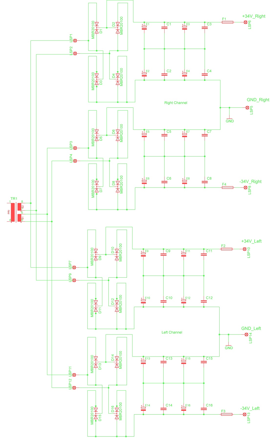

So when we have one trafo is it better to use the center tap?
I use the pseudo psu (as shown on the attached picture) for testing at the moment and can not hear any hum. I've seen a psu by Mr Nelson Pass and if my memory serves he connected the ground after the rectifiers and not at the center tap(he used two trafos).
Ok let's leave alone this way to hook up the psu. What's your finding between one shared trafo and dual mono config? (according to ground issues and channel separation)
In a dual mono amplifier, I used to connect every main starground to the case through 1...2uF foil capacitor.
When I said to connect the ground to the heatsink I mean to connect it at AC, not DC! Therefore, both amplifiers will have a common signal DC ground connected together at the signal source, once the signal source is connected

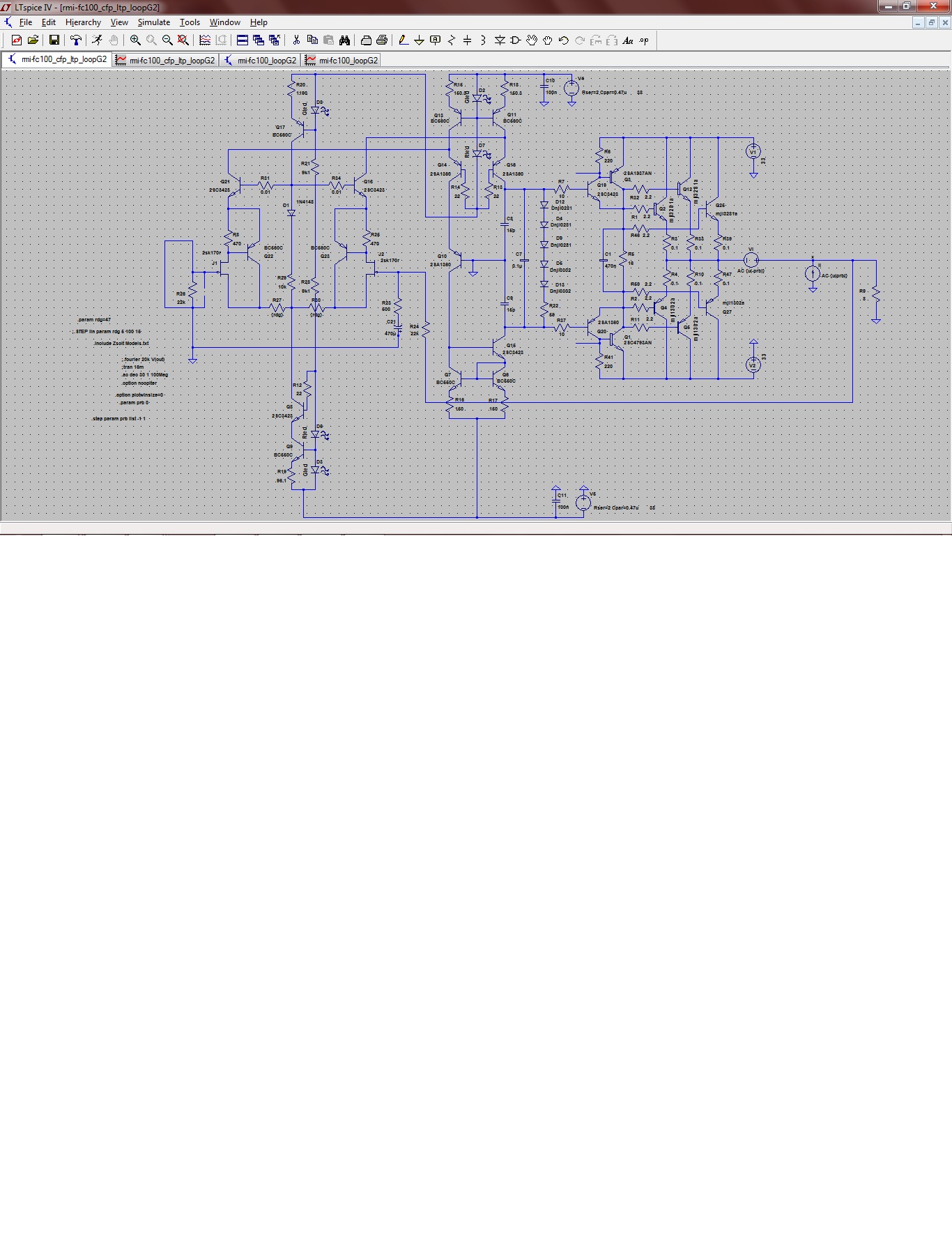

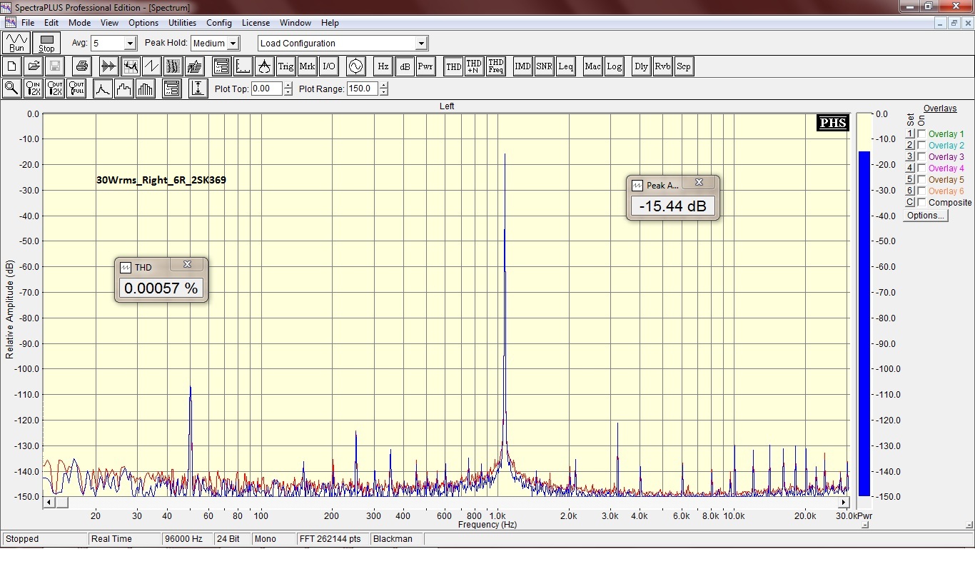

I was playing with the LTP. I compared 2SK369BL and 2SK170BL
Idss of 2sk170BL 9,31mA/9,31mA other pair 9,34mA/9,34mA
Idss of 2sk369BL 9,40mA/9,43mA other pair 9,45mA/9,49mA

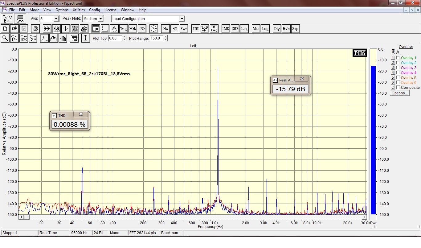

Result of Right channel about 30Wrms 6R resistive load.
Please do not take the high order harmonics into account since those are comming from my sinus generator.
THD1 LTP 2SK170BL:
THD1 LTP 2SK369BL:
Using 2SK369 in the LTP i can feel more air the vocals are much more defined i can hear the smallest breath.
Hmm... the 2sk369 has more Ciss but more Yfs, maybe the transconductance rules here

THD1 LTP 2SK170BL:
THD1 LTP 2SK369BL:

I think k369 pairs are much better matched than k170, not only at Idss 🙂
This is the reason behind reduced H2 distortion and much more defined sound (grainy perhaps?)
Idss and Vgs matching is worse. The Yfs matching i do not know.
I do not hear more granier than with 170s but i need more listening tests.

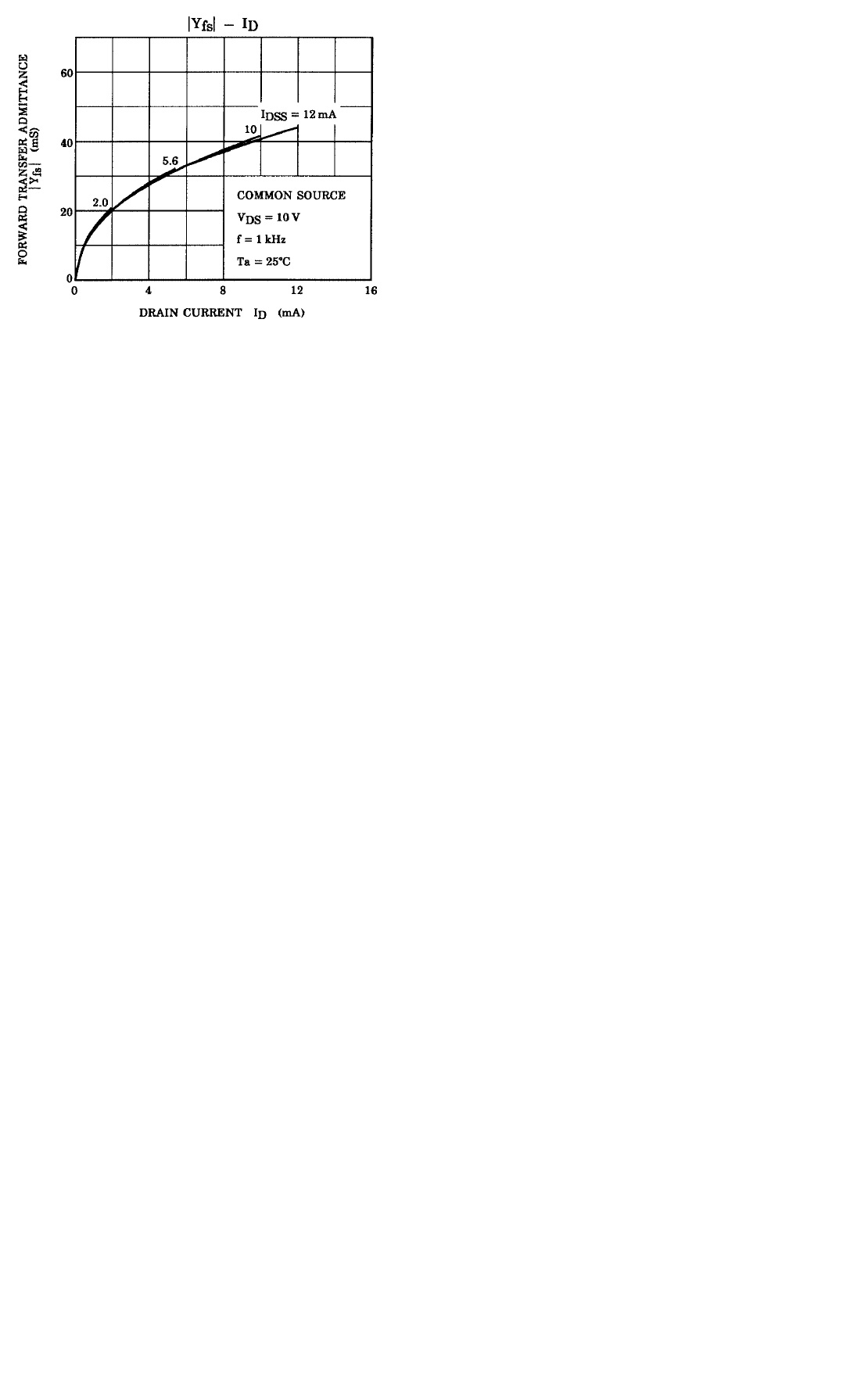

389 is the pair of 170s
369 is much the same as a very high current 170.
Yes, the specified transconductance looks higher. I interpreted the datasheet as showing that a similar Idss 170 & 369 perform much the same.
How well are the 369pair matched?
How well are the 170pair matched?
I am guessing that what you are hearing is a difference in pair matching.
The Idss matching is shown in my previous post.
The Vgs matching of the 2SK369 pairs is not as good as for the 2SK170 pairs.
I have three times bigger DC offset with the 369's.
I do not know the GM match of any of the pairs.
Here is the gm plot for the 2SK170.
For the 2SK369
I perhaps misunderstood the plots but as i see if the part has the same Idss and running at the same Id the 2SK369 has higher GM. Maybe this for nothing in this case. I'm asking your POV.

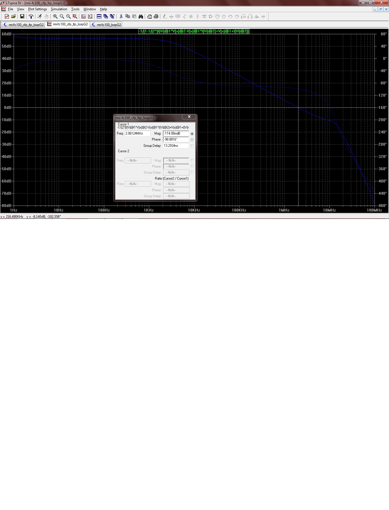

It would be better to simulate the amp with 2sk369 too and compare.

You have stated the selection of Idss. That is no where near matching devices.
I only can match for Idss and Vgs at a given Id. This gives me 0,1-0,3mV offset in case of 2sk170. The 2sk369 was matced even worse accordind to Idss and Vgs. I do not have a curve tracer to go for gm.
I was curious about my finding that when i swap for the 2SK369 i can hear cleaner vocals. I measured the thd (with my limited tools) and found lower thd with 2SK369.
My question was that i can have the lower thd because of the higher gm or because of the better gm matched (accidentally) of the 2sk369s.
Better GM matched.
H3 sound more "resolute" than H2 😉 ... If you like it it's all that it counts
