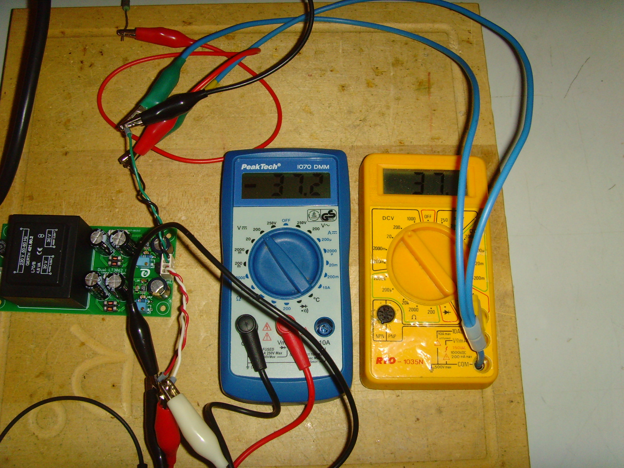

@ZDR:
I do not remember that I have shared my FC-100 frontend-PSU - shown below and being based on the LT3062 CPU - with Pinnocchio.
The reason, why I did not share: my eyes are growing old and I am not able to solder a LT3062 IC.
I believe that most of you are not able to solder either.
But: I have a young German DIY-friend, who has the eyes of an eagle and who soldered 2 of the LT3062 PCBs - one of them is shown below.
The LT3062 works perfectly for small current / "high voltage" frontend PSUs.
Best regards - Rudi_Ratlos

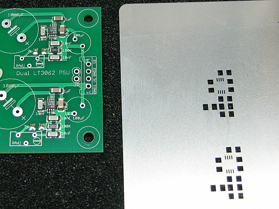

In case you want to prove / demonstrate your soldering skills, I will send you the PCB shown below.
The PCB contains a QFN-20 case (TPS7A4700 adjustable LDO voltage regulator, up to 20V, very low noise, can be jumpered as +/- voltage PSU)
and the MSOP-8 LT3062 adjustable (up to 40V) LDO voltage Regulator (which can be jumpered as +/- voltage PSU as well).
But I have one request / requirement: please solder one PCB for my own needs.
Best regards - Rudi

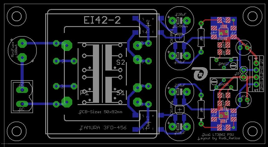

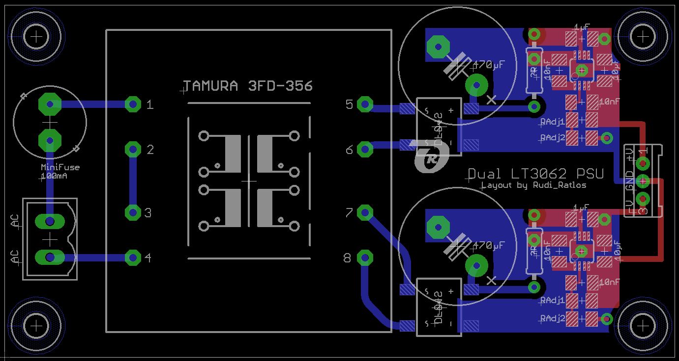

Rudi, I just noticed that LT3062 has rated Vin at +45V and absolute max Vin at +50V. Unloaded 30VAC transformer with filter cap will inject 53V. How did you solve this?
Hi, I have used the Tamura 3FD-356 print-transformer.
It outputs 2 x 45mA @ 28VAC. I have not had any problems with it.
Will you be able to insert a 40V Z-Diode behind your rectifier/reservoir cap?
I wish you the very best with your FC-100 build.
So far: it looks very promising - Rudi

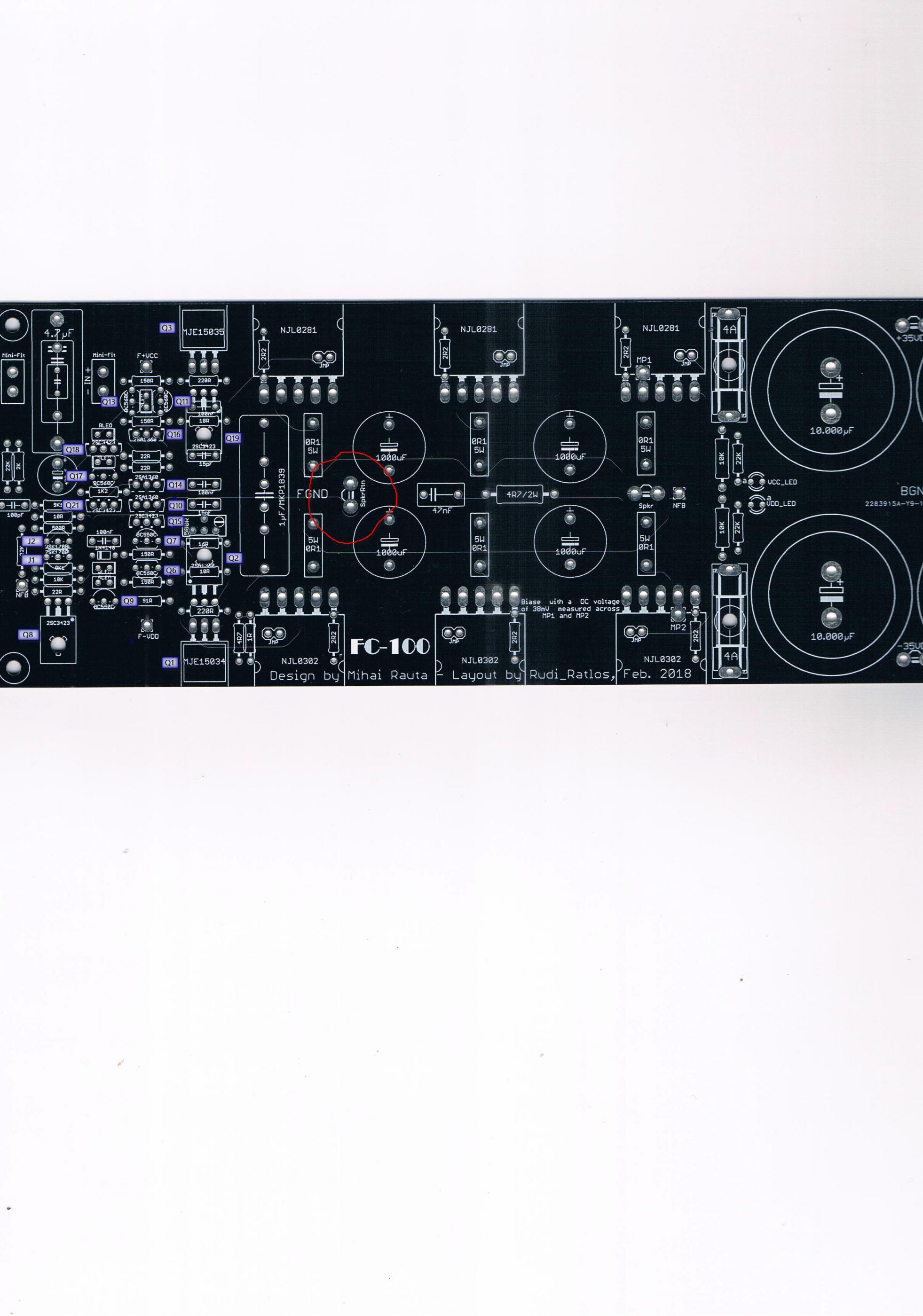

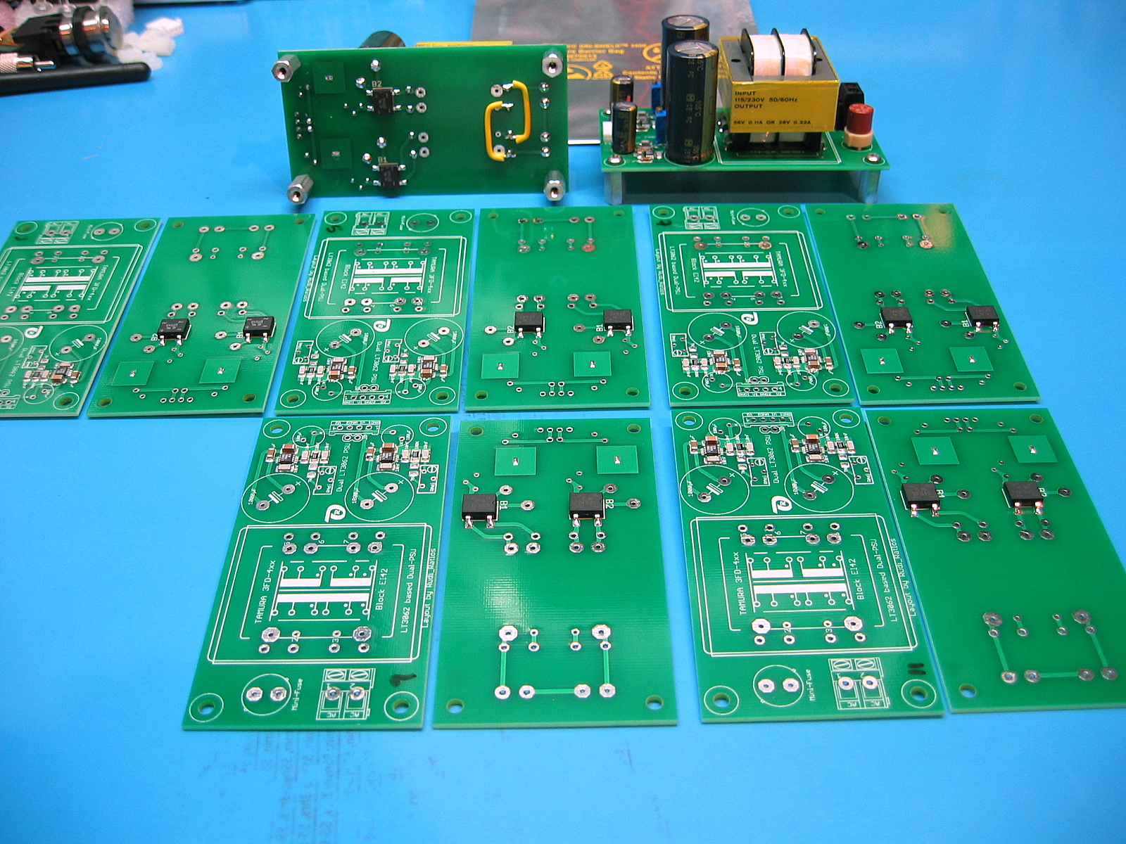

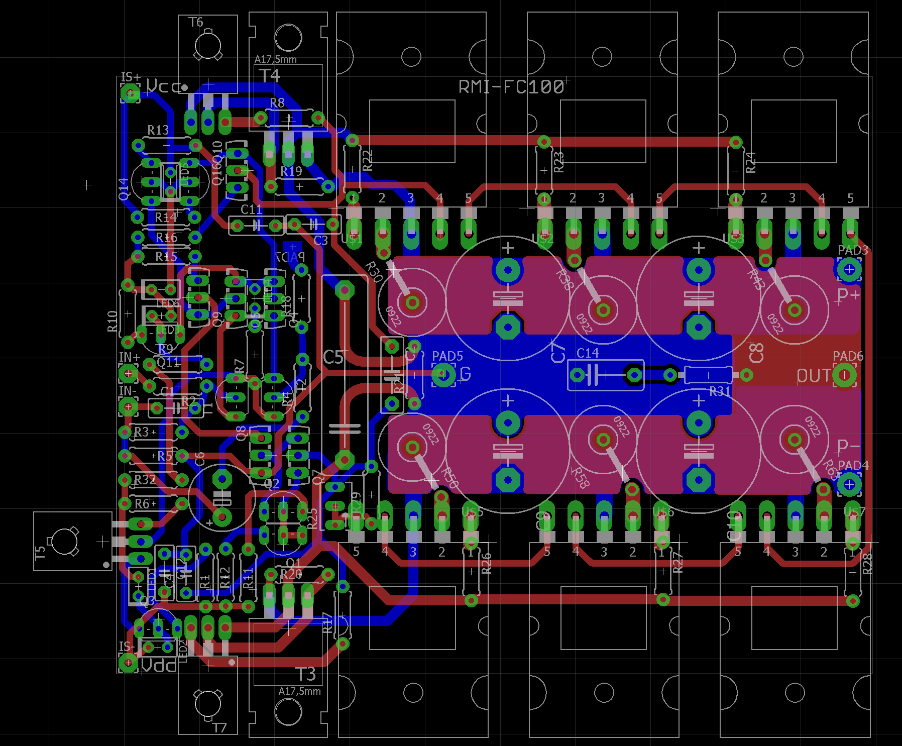

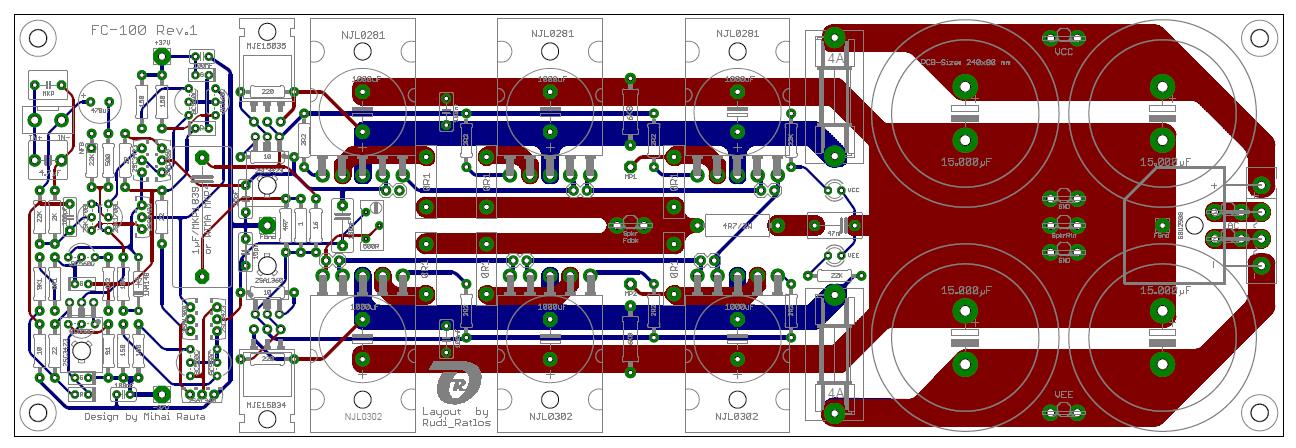

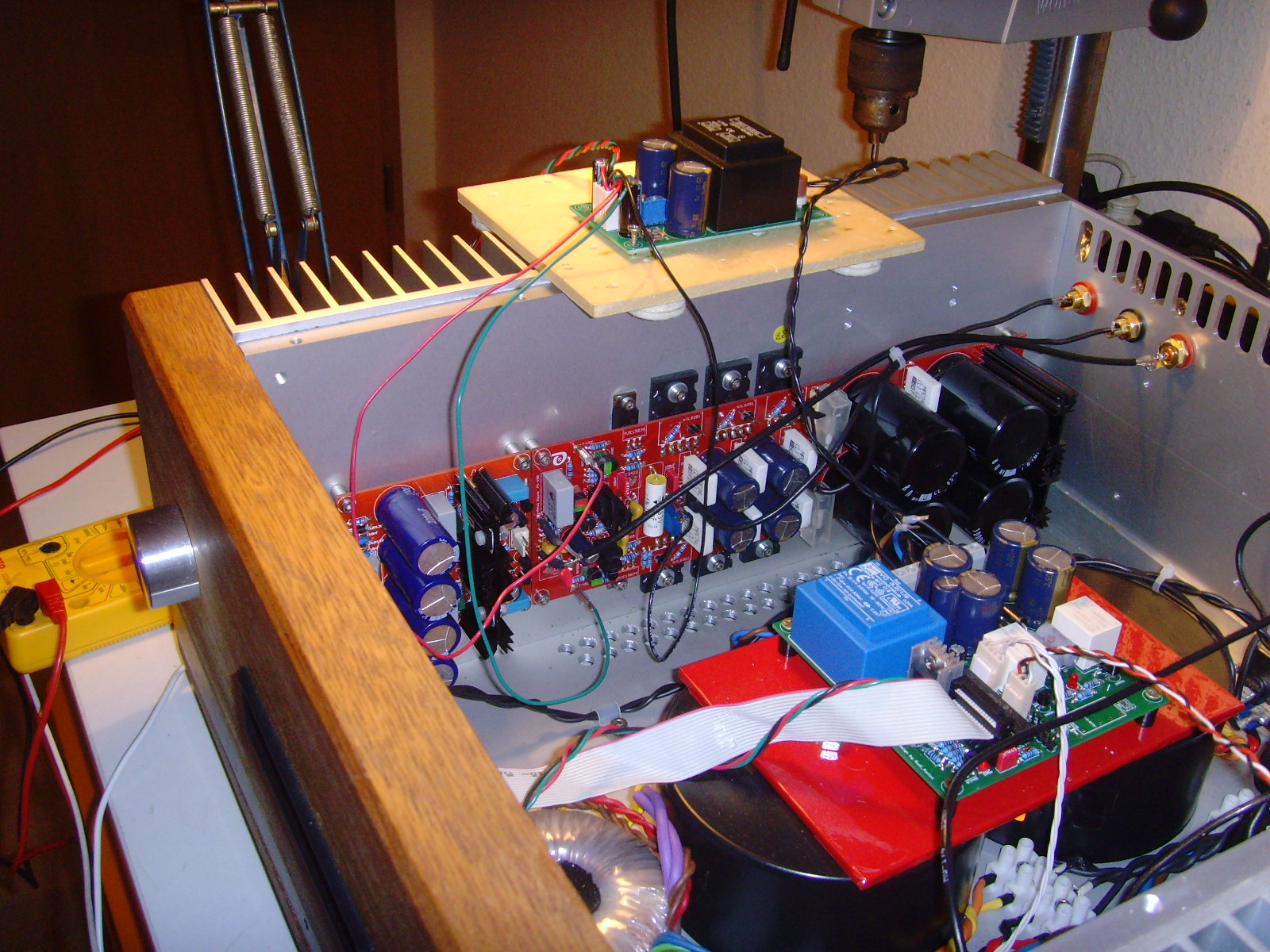

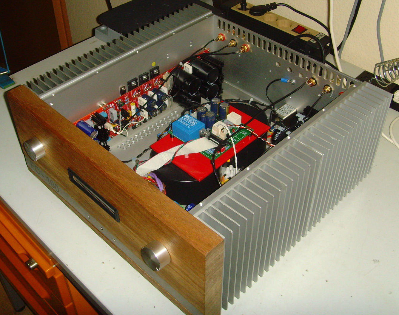

Gentlemen, I have been asked by a DIY-friend to give him a pair of FC-100 amplifier PCBs.
I agreed and ordered 10 PCBs - the minimum amount to order.
Image 0 shows my own FC-100 (with an ADDON-PCB on top of the transformers); image 1 shows the topview of the current PCB.
The FC-100 is - at least in my ears - the "absolutely best-sounding DIY-amplifier" to build.
The chief-editor of a German audio magazine even took the FC-100 into his "hall-of-fame" and uses
it - among other amplifiers - to "evaluate" new audio components (image 2, on the right side: Endstufen : DIY FC-100)).
Compared to the previously offered PCBs: there are some "cosmetic track changes", but they do not concern.
The major changes of the current FC-100 revision concern the PSU.
The bridge rectifier - as shown - is a GBUx-type, being directly mounted on the heatsink.
You can easily change it ("But why?") to something like the KBPC1002 or even to a "boutigue LT4320" (LoL).

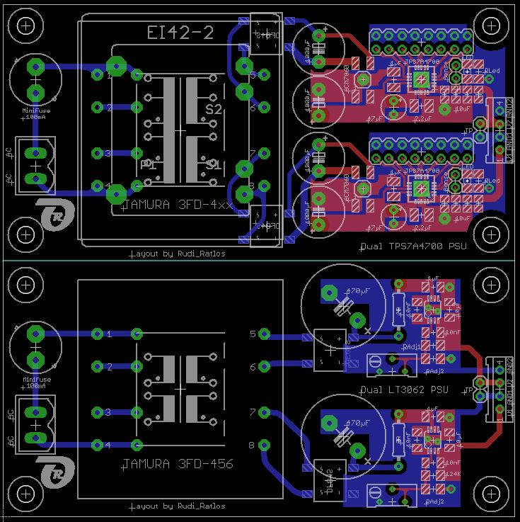

The second change concerning the PSU is: I will not offer you a PSU shunt as frontend-PSU, but will offer
a dual LT3062 - based frontend-PSU - PCB(see image 3 and 4).
My offer then includes 3 PCBs (2 x FC-100 PCB, 1 x LT3062 dual PSU), unregistered shipping and PAYPAL-fee.
Shipping within the EU-tax -union is 25€, worldwide shipping is 30€.
Please give me a PM, if you are interested to have the FC-100.
I will send you the schematics, BoM, drill-template, ... then .
Best regards - Rudi
