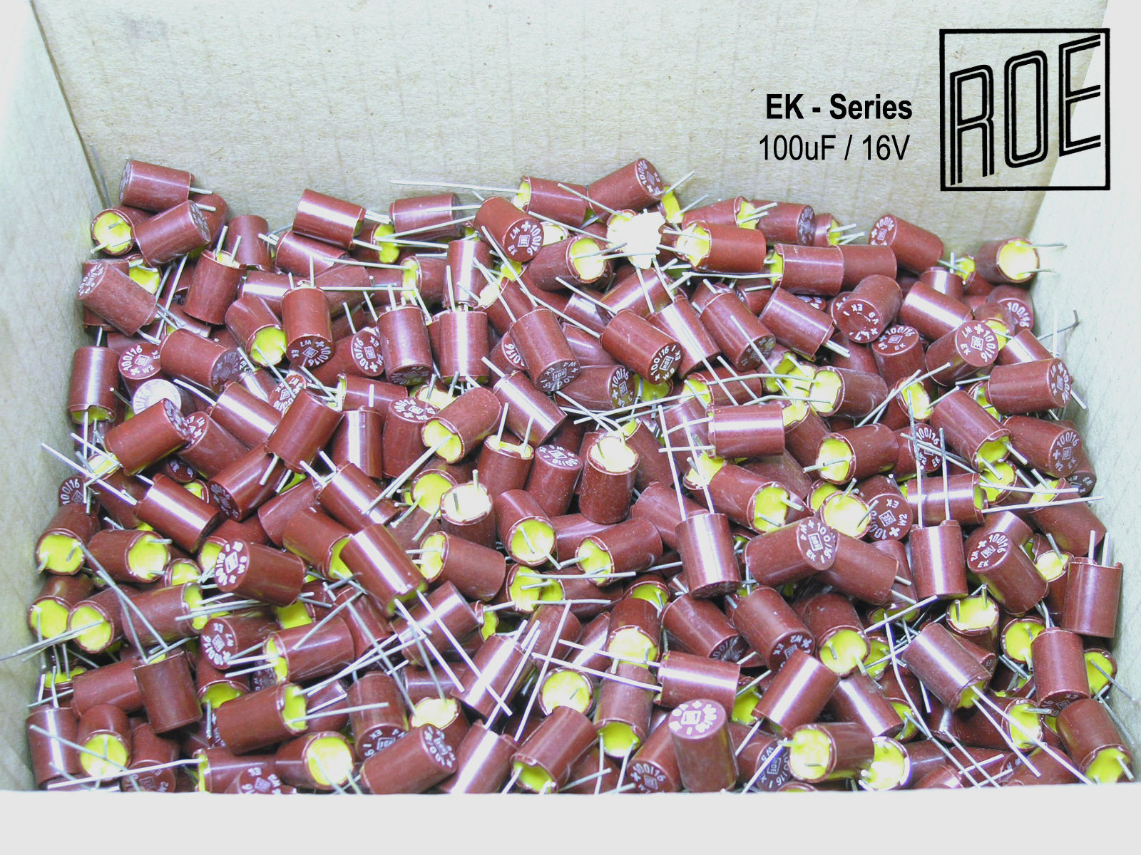

I have "lots" of experience with these caps.
You see the red caps with Roe and Siemens logo. I think both were made
in the Roederstrein plant. We used to order these on a regular basis and
when they arrived came as either R. or Siemens 35 years ago.
As said problems start after decades (sometimes one decade only) and in hot
environment. The plastic case (I don't think it is Bakelite ) can not withstand
thermal stress. The point with max. mechanical stress is on the top edge.
Sometimes the cracks are only visible with mag. glasses.
My experience: the absence of cracks does not guarantee proper function
and also a cracked cap may still have full capacitance. These caps will not
likely fail with a short, but:
They (as probably el. caps in general) don't like to be operated with low dc
voltages. A common point of failure is in a special breed of amps where they
are used for emitter ac coupling with only .5 to .6 volts dc. They may become
conductive with still full capacitance when used like this.

These capacitors were heavily used not only in TV sets, but also in high-end audio gear by Revox, Bang & Olufsen and others.
In my experience, these capacitors are the first things to replace when the equipment comes in for service. The top surface of many is cracked and they are dried out.
Maybe these capacitors where O.K. when new, but after a couple of decades, in my view they are no good anymore.
The dull red ROE elco's are really bad components and need to be replaced!

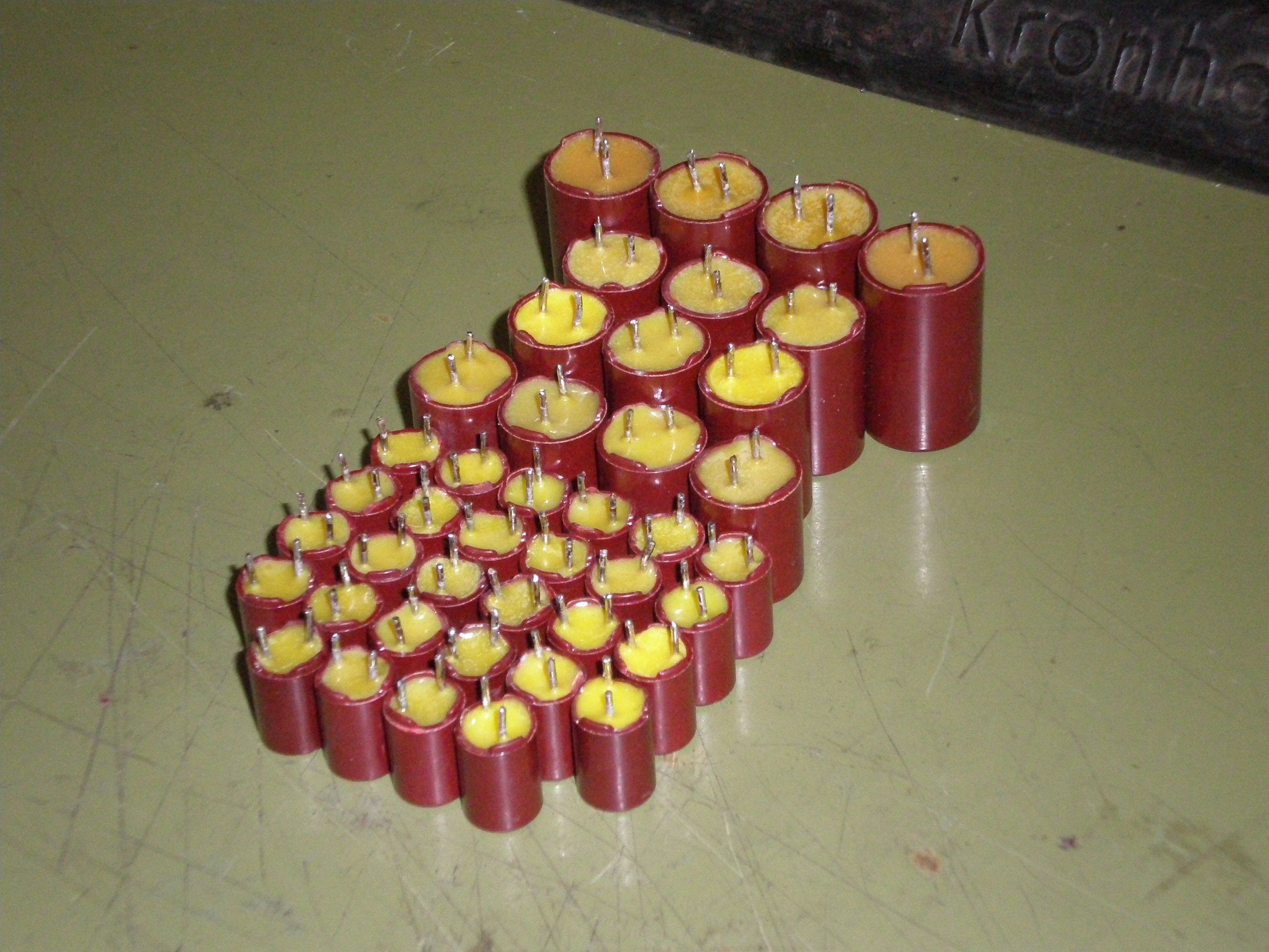

I have examined some samples in details: at first sight, they look very similar: identical case dimensions (but it could be down to some DIN standard), similar case thermoset material (except for color of course), similar sealing epoxy resin.
However, when you look with less naive and more technical eyes, there are some telling differences: tiny details like the shape of the feet or the transfer-moulding flash are different, which means they come from different moulds.
This doesn't mean they come from different factories: they could have two (or more) sets of machines, and they may even have actively cultivated some minor differences, just to be able to prove that the brands are actually different.
This is not an uncommon practice: look at some Aldi and Lidl products for example.
I still don't know; all I can tell is that the Siemens ones were always somewhat better, but it could result from an end of process screening...

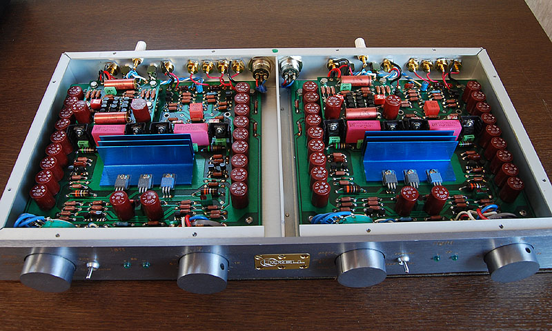

The ksp7b I rebuilt sounded much better with pana fc replacing the old dead, dried out and cracked rode's
I've tried Panasonic FC years ago, 'bout '88 if I remember right ...
... whacked 'em in a nice DIY phono-pre I lashed together in my spare time.
The 'new' Bakelites I have stashed for the NEW phono-pre, aren't dried out or cracked at all ...
... tip top & Bristol in fact !
So should be hunky dory ... I recon.

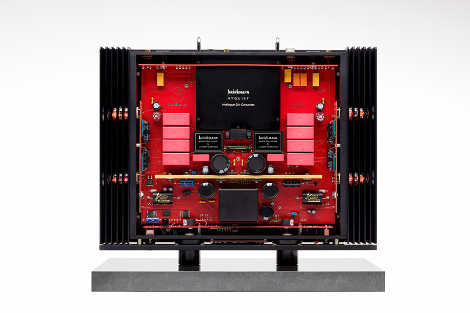

" Brinkmann Nyquist DAC, released at the 2017 Munich High End show in May, $18000
Helmut must have collected a giant stock of the Red Roederstein EK series "
