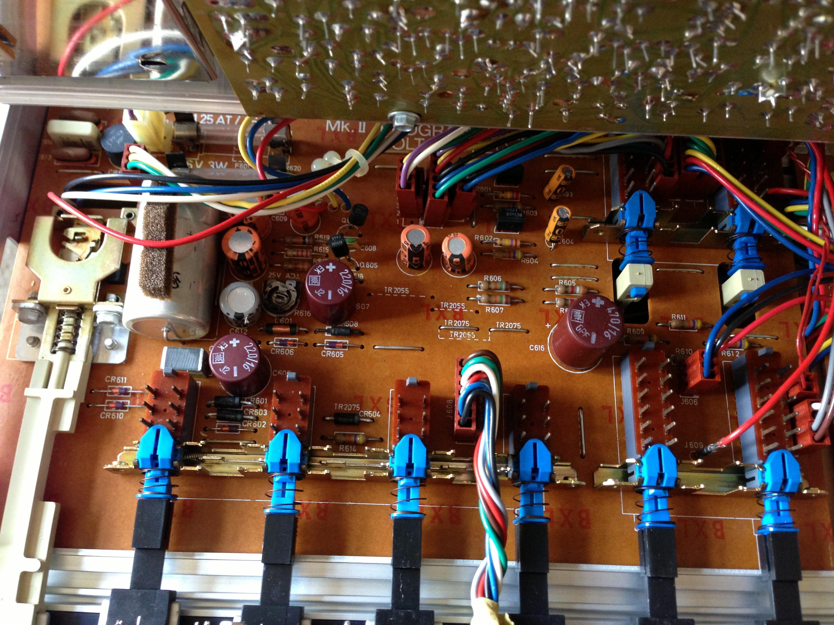

The Sprague (reddish orange) are most probably in worst conditionBetter pic...
Spragues will get replaced too
Yep, they'll get replaced too =D
The Roederstein EK (Bakelite) type of caps are so different that I want to make sure I get a replacement that will not change the sonic signature of the receiver. It's been recommended I use a low-leakage cap like the Nichicon KL which are great caps.
Hi, how did you solve the problem with substitution of EK capacitors? I'm facing the same issue with my Tandberg TR 2075. On top of yours I have one small, most probably 10/63 - it's quite difficult to read it since this small one and one 220/16 is covered by kind of yellowish salt from leaking capacitor...
Sorry for the late reply. I wound up using Nichicon KL 10% 105C caps to replace the the ROE EK caps. I have recapped two Tandberg 2075's recently and the ROE EK caps on the Program Voltage boards had unacceptable ESR when checked with my BK 879. The ROE EK caps on the Preamp and RIAA boards were still barely ok. I changed them all out while I was in there to avoid problems.
I'd really like to get the datasheet for the ROE EK caps but I keep coming up empty online. I guess I should just contact Vishay and see if they can provide it or info on a good replacement. I think the following maybe the Vishay replacement for the ROE EK but not entirely sure.
