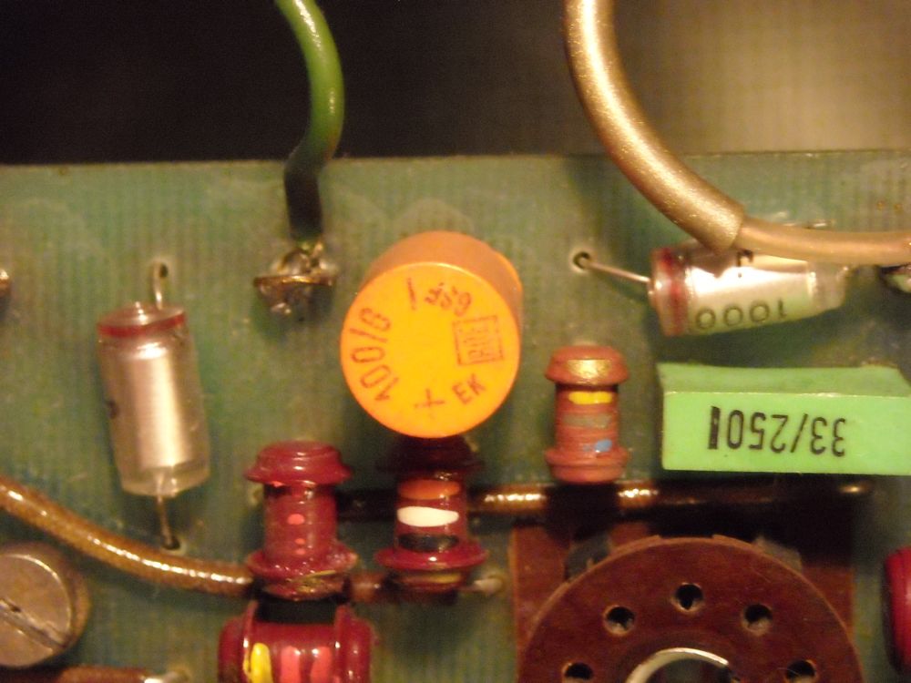

Hi again Elvee
There was some speculation earlier...
...that the casing's might be something OTHER than Bakelite...
...perhaps an 'improved' sort-of Bakelite.
( I believe Phenolic, was kinda the MKII Bakelite...
...sort-of anyhow ! )
Well...
...the brown/red case, is absolutely TYPICAL of Bakelite...
...which did seem to be made in 'certain' colours...
...including ORANGE.
A friend of mine showed me some Bakelite objects ( he collects them ! ).
Orange is/was an unusual-colour he told me.
He also told me BLUE is 'quite rare' and VERY collectable...
...I'll take his word on all that !
Just looked at a brown/red Roe-cap under a microscope.
The casing is 'ever-so-slightly' chipped.
And indeed !...
...SAWDUST was mentioned earlier as well...
( my collector friend also mentioned this )
...there are what looks, remarkably like small 'wood-colour' particles, emerging from the surface of the casing.
Impossible to see with the 'naked eye' of course.
I believe also the 'porousity' of Bakelite was mentioned earlier also.
Perhaps there IS a 'controlled-venting' from an otherwise, epoxy-sealed case...
...through slightly porous Bakelite.
Perhaps THIS was one of the main ideas of using the otherwise 'fairly obsolete' material; way into I think, the 70s' & 80s'.
Bakelite also seems entirely, non-resonant ( or fairly, at least ).
All these 'high-end' capacitor manufacturer's sales-pitches; are constantly on about, anti-resonance this, anti-resonance-that.
Maybe the 'top-boffins' at Roederstein had figured this out YEARS before...
...and implemented it as standard, at a normal, sensible cost ?
Cheers.
Si.

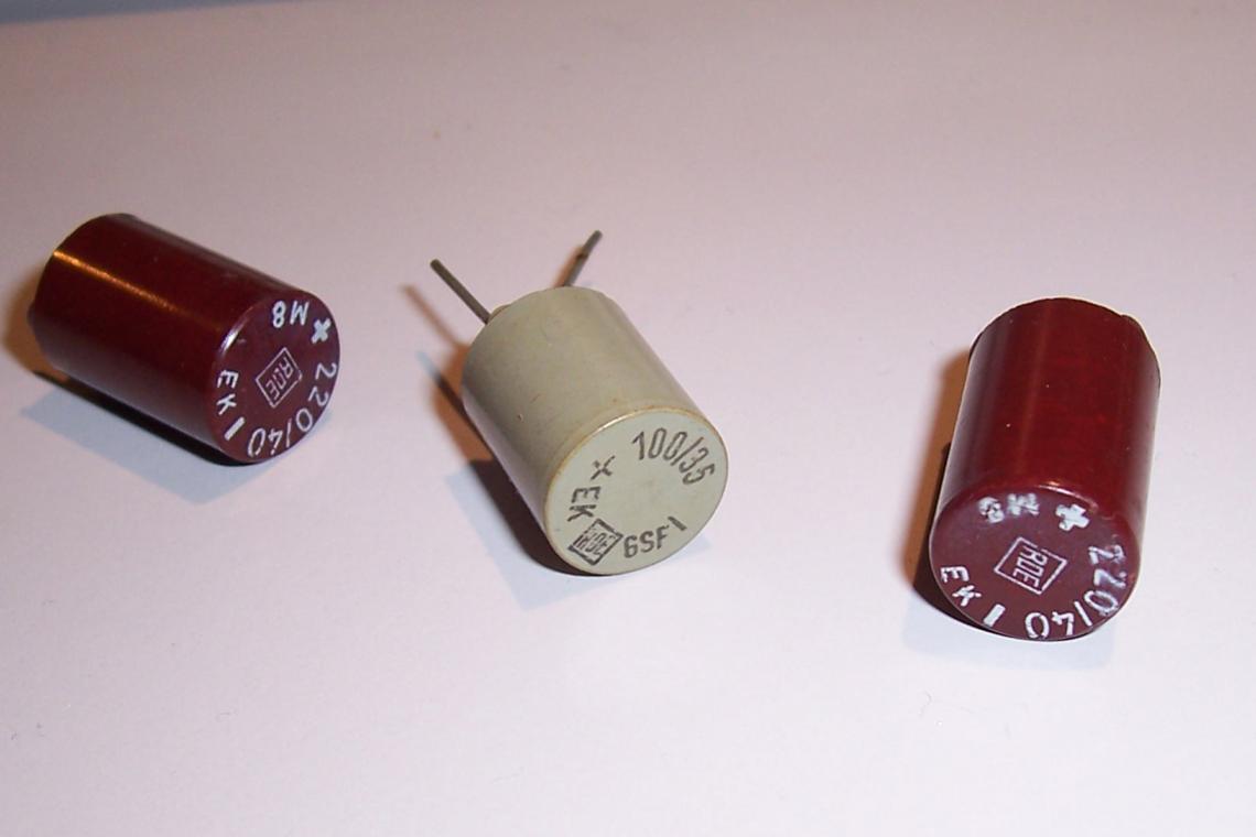

I found some more in my stock, including the grey one.
I don't know if this color has a special meaning.
The esr @1KHz for this NOS 100µ/35V is 131mΩ
The 220µ/40V of more conventional aspect measure 67mΩ. They date from 1980 and have served a harsh duty: they were filter caps in a modular DC/DC converter.

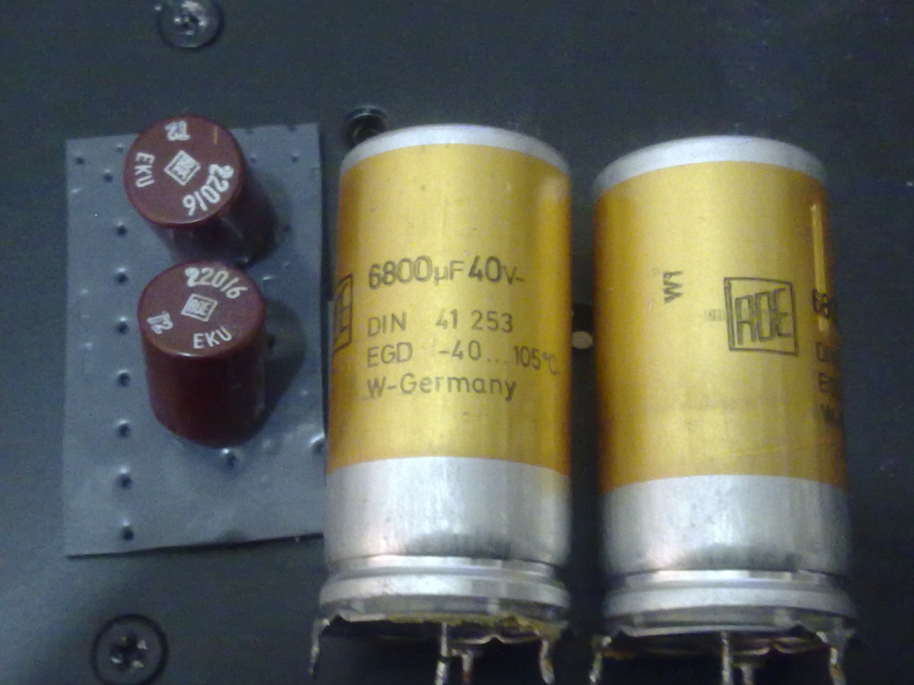

here is my roe collection the radial electrolytics in this piccy have the same problem has the axial version..
They look like axials in (very poor) disguise. Not surprising they behave similarly.The lytics in this piccy have same problem has the axials
my experience with those dull-red ROE capacitors is that they are very prone to failure after about 25 years.
They were heavily used by Bang & Olufsen and Revox since about 1970.
The first advice of all service technicians that I know, is to replace these capacitors, in whatever audio brand they are used.

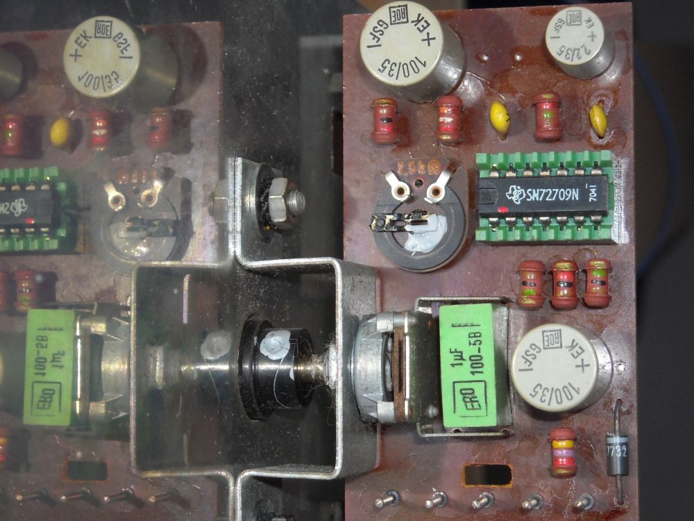

Ah those resistors and the metal (but open) potentiometer... old times....
Please replace the ROE stuff even if they are made by fairies and measure the lowest ESR on this planet.
Please also replace the trimpot, the moving metal contact always breaks or is no more pressing on the carbon track.
(all Revox A-77 's are affected)
Best regards, 968driver.

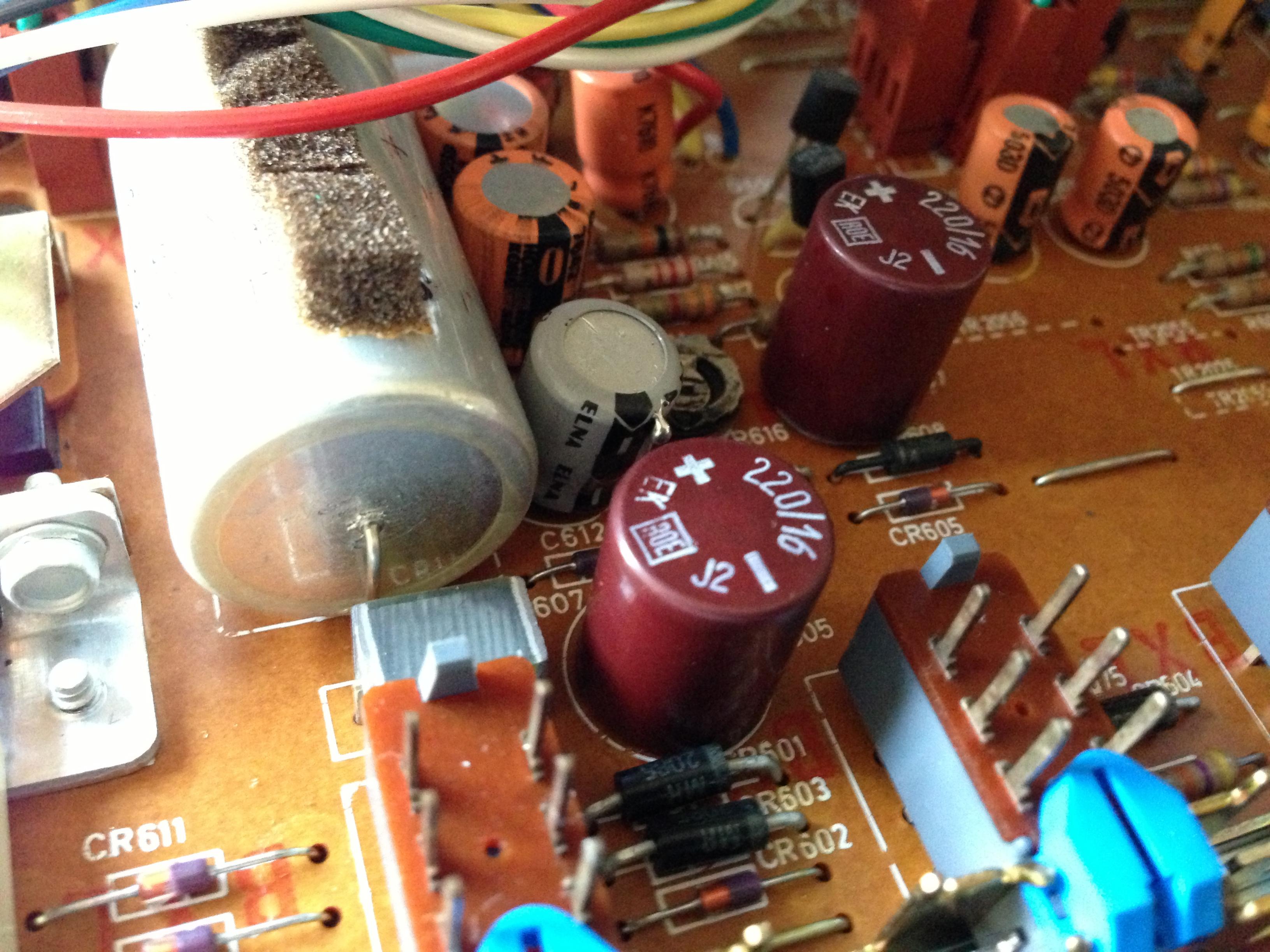

Add Tandberg to the list. ROE EK used heavily by Tandberg. Would anyone know what the J2 and GPK designations stand for? My caps are ROE 220uf/16V EK J2 and ROE 470uf/16V EK GPF. I'm trying to figure out the difference between the J2 and GPK. I assume these designations tell me the tolerance/temperature range/pin spacing? I'm trying to find a data sheet for these so I can find suitable replacements. Thanks.
