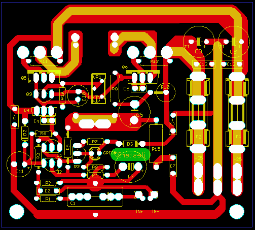

Michael, thanks for the link. BTW, SOA paper downloaded! Useful read for pros and (us) amateurs alike.
D
Deleted member 148505

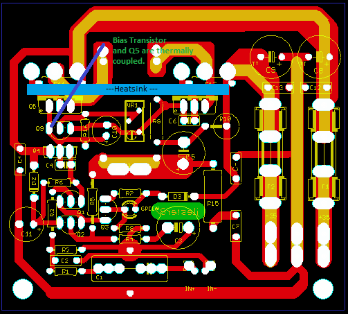

OK, then improve the thermal coupling between drivers and bias transistor so it doesn't take ages to stabilize and responds usefully to changes in dissipation...... im improving it 🙂
According to the pics, you don't have a driver heatsink anyway, so what bias current are using now? You don't need to move much to allow better coupling with just a single heatsink for all 3 transistors, assuming you don't already have this arrangement but just haven't shown it here.
D
Hi, the drivers will be connected on a single heatsink. Bias transistor and Q5 are thermally coupled (glued by thermal epoxy), thus changes in Driver transistor Q5 will be quickly monitored by Q9.

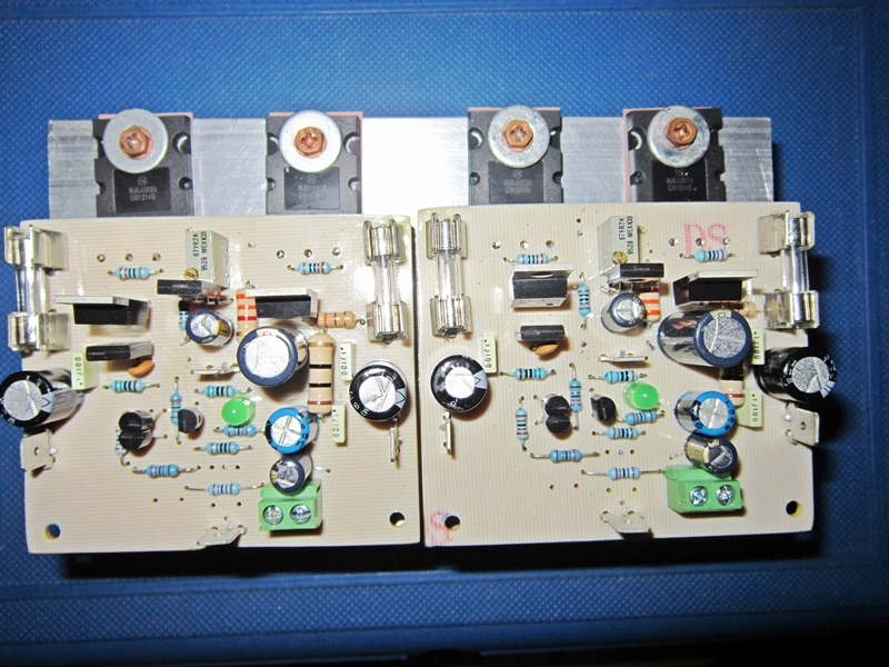

5W output collector resistors are on the underside of the PCB.

Nice layout - I also used this approach for my TGM1, TGM2 and TGM3 - having power rails on one side and sensitive parts on other side.

What I liked with P3A(sziklai) is that only the O/P transistors are mounted on the main heatsink. This simplifies the work on the amp case. Also it has low parts count, so it is as easy to build as chip amps.

The Power Ground does not need to be connected to the Signal Ground by using PCB traces.
The Power Ground and the Signal Ground need to be referenced to the same voltage. This can be on board, or it can be off board.
If you are building more than one channel into your amplifier, then I assert that the Main Audio Ground (where Signal ground and Power Ground meet) must be off board.
So many critics to my own layout, thanks guys...
time to improving it 😀
so many words....what does it amount to?🙁🙄
why can't AndrewT just show us in pictures what he's got so we can appreciate what he says....
