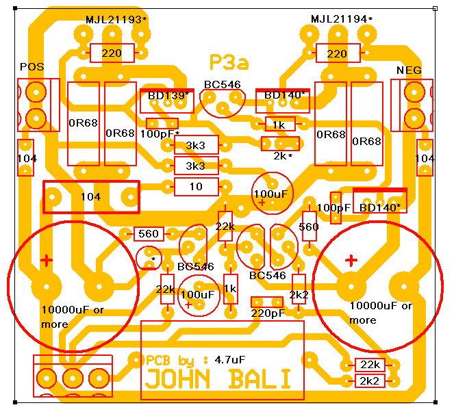

Hi PMI,@John Bali: 1) It would help if you posted a layout with the component reference (in any form) superimposed on the layout, or component values, or something like that.
1)Ok, attached
2)I see Sakis comparison & okay better the yellow one, we can put the elco or not there & maybe we can find something 🙂
3)I don't like trimmer so I change it to resistor but now I changed it back to trimmer
4)Agree
5)I keep it tight because I saw it on Sakis's comparison table & what the tricks he made
6)How about if we try make it & compare to our PeeCeeBee 😀 ?
but I guess it is not fair

@John Bali: I will take a closer look later today, bit short of time right now.
If you do not want to keep the trimmer on the board, it is a simple matter of laying the pin pattern of a resistor and trimmer on top of each other. This way you can do what Shaan suggests in his thread, use a trimmer at first, then remove and substitute a resistor later. I posted a pic of how I did that here (4th pic from the left, circled in red):
http://www.diyaudio.com/forums/solid-state/231662-peeceebee-38.html#post3487017
I think the rail caps are big enough now 😀, just have to make a note of the series resistance. Low ESR can sometimes be better than high capacitance.
Btw, why is the Zobel cap so large?
John,
see the empty space where P3a is printed?
That is where your Power Ground and +ve supply and -ve supply should be.
All grouped together to minimise loop area in the cables/traces and very close to the biggest current consumer on the PCB, the output devices.
It's here that the HF decoupling will connect direct to the output device power terminals and very close to the Power Ground.

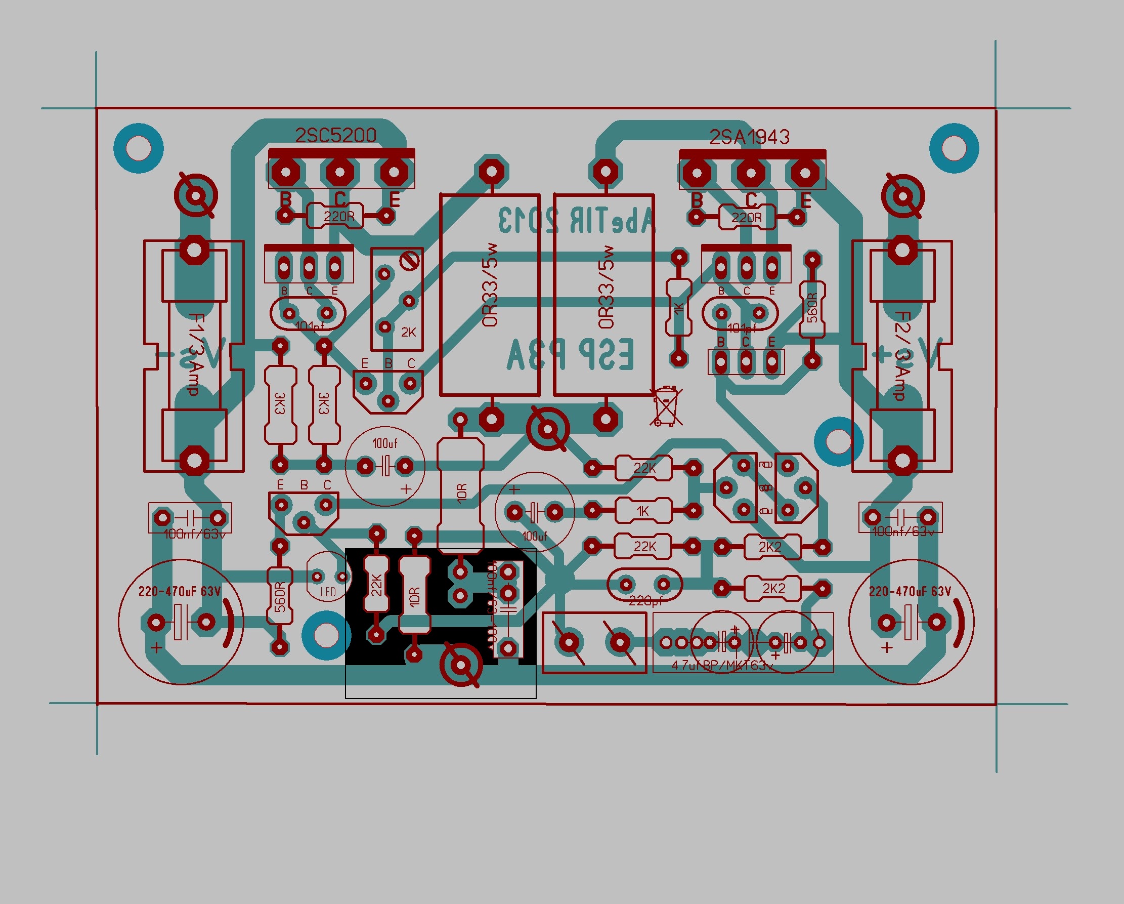

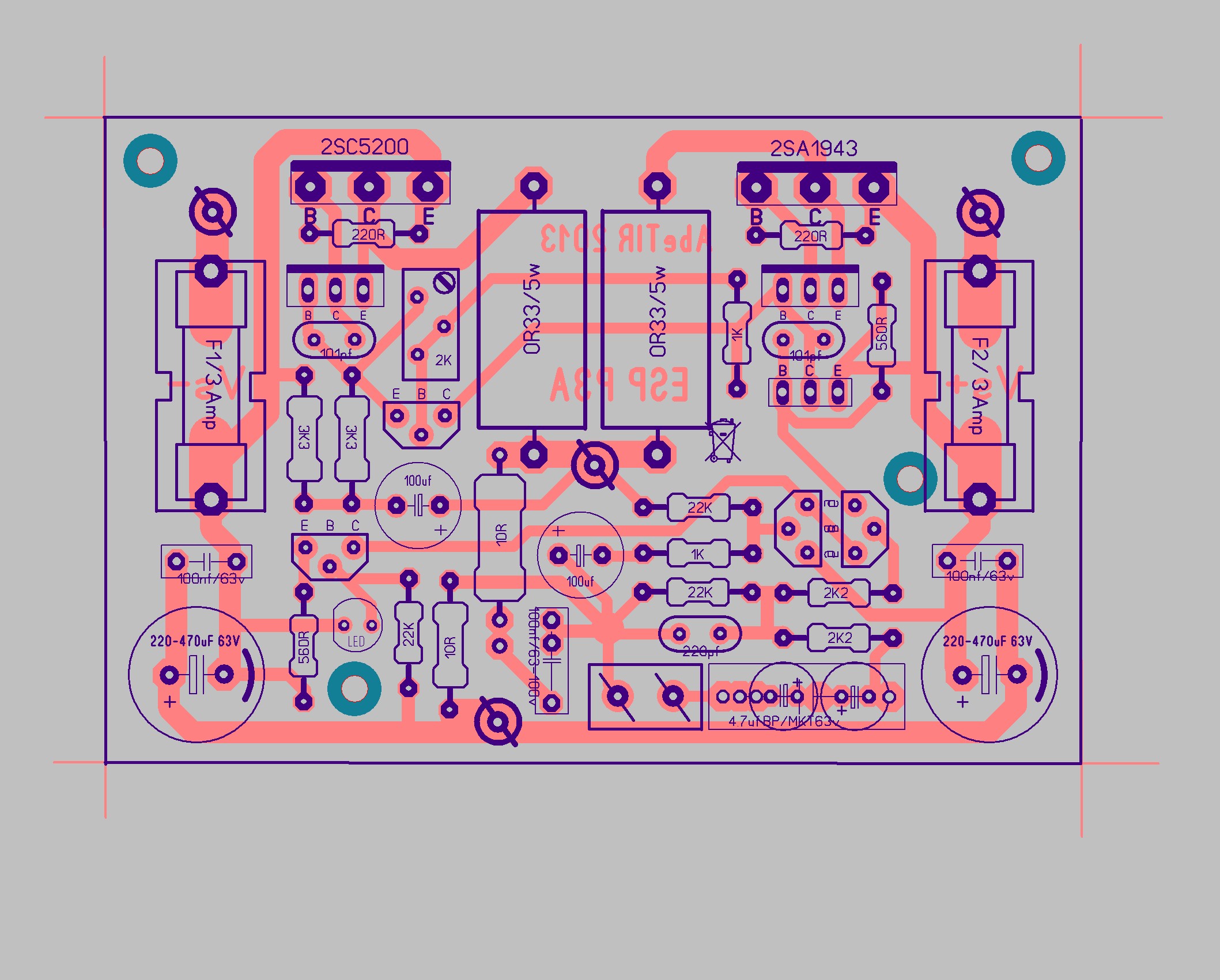

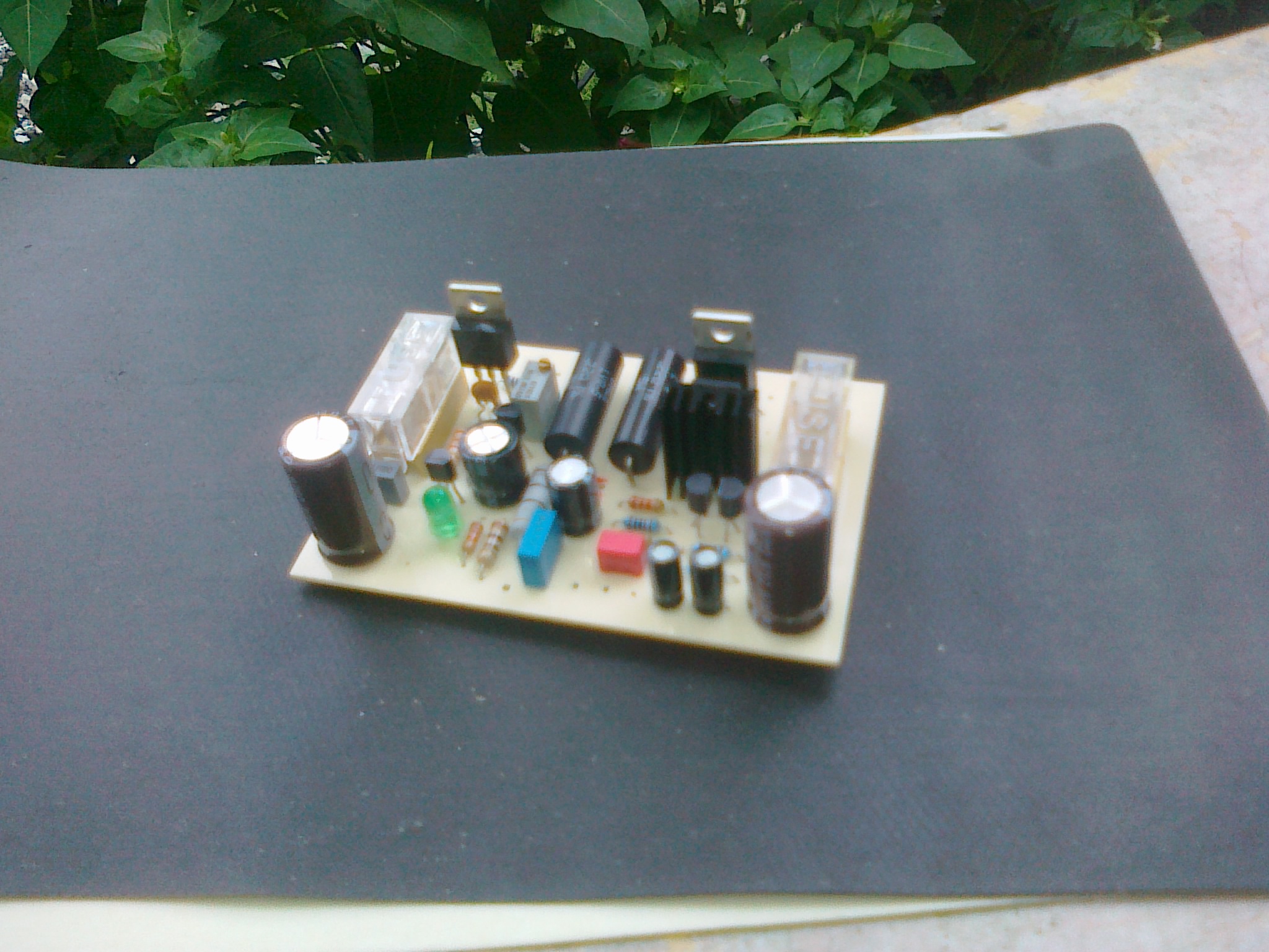

Hi All,
I just thought that I could also use some critiquing on my lay-out 😉. It is to my knowledge a resemblance of the ESP lay-out, however I have never seen an actual board from ESP, this was a copy from a lay-out done by a member posted somewhere from the old P3A thread (could not remember who it was dv something??) . Anyway I have posted two images of my own version, and I have a question about the ground scheme of the zobel network and of the current source.
1st image, highlighted, current source ground goes to the star ground, zobel ground is tapped direct on the power ground.
2nd image, current source ground goes direct to power ground, zobel ground is tapped to the star ground.
3rd image, a cheap shot how does it look like when assembled (not tested yet 🙂)
If my memory serves, I have read that the current source ground should be separated from the rest, also by placing a common heatsink for the drivers and the bias servo should improve thermal tracking (just like John Bali did in his version) not on my version. Another question, I have seen lay-outs that uses ground lifter (10ohms) but others do not have it. Is this necessary or is this just a matter of preference?, I understand this is CFP. Anyway is there something that I should worry about in my current lay-out?
Best Regards!
Best Regards!

Hi AKSA
how are you 🙂 would you say some critics to my layout please?
Thanks to your suggestion about elco & resistor//trimmer tricks
BTW I draw it long time ago & my PCB will not use any silkscreen 😎
But your suggestion is good, I will try it 🙂
So if I do like what you say the power ground will be surrounding all the board's side, right? Ok we make it clear on next layout that I make
Regards
That cap so large because there are two tracks between it legs 😀 & I don't want to use any jumper. 250-400v rated will be fit there.@John Bali: I will take a closer look later today, bit short of time right now.
That reserved for small heat sink for the drivers & VBEJohn,

@John Bali:
Overall, the component placement looks pretty good, 🙂
Finding the best place to put the Zobel network, or any other output filter for that matter is usually awkward on a 2-layer board.
The 10R resistor should probably be rated at something over 1/4 watt (at least 1/2W, more depending on how much power you are designing for). This RC network will be in parallel with the speaker load, and it will see the same output voltage as the speaker. It will look like a high impedance at low frequency, and a low impedance at high frequency. (you can actually calculate impedance and estimate power at 60Hz and 20KHz)
So, wide pin spacing makes more sense for the resistor, than for the cap, and the resistor is the more likely component to bridge over a trace or two. You can also move the 10R on the other side of the trace that connects the 0R68 pairs, and avoid some of the problems. The 10R can bridge over the positive rail, and the cap will be normal size.
A good size rail cap on the board is a good idea, but 10,000uFd is probably overkill. I think you can shrink those a bit if you need room, and even if you do not, you could make a double pad pattern for smaller caps. From what I have seen testing my P3A, between 1000 and 2200uF would be enough for me. Obviously this depends on the main power supply, speakers, listening level, etc.
The same thing applies to the 4.7uFd input cap. There are capacitors with smaller dimensions that would work here just fine.
@PMI
ok thanks 🙂
The 10R & 3k3 they are 1/2 watt the others are 1/4 watt.
Zobel 104 & 10R is easily to swap just change the silkscreen.
Actually I more likely to make PCB layout as good looking to my taste 😎 even maybe not good enough for some reason.
Then when I make it I hope it just work, if not just redesign again/tweak it & I enjoy it 😉 at the end it works & you know how that feels 😉
About 10mF elco, you're right it is too overkill 😀 I'll follow your 1000-2200uF.
Input caps also can be reduces 😎 or put it in other place (off board or jumper if sure our source is DC free)
Now there is some thinks inside my head 🙄, maybe I'll make a new layout for it
Btw it is good or not if we integrate power supply on the board ?
Dual mono maybe just better 🙂 & if someone want to make it...
it's so simple just connect to transformer, input & output. Done...
