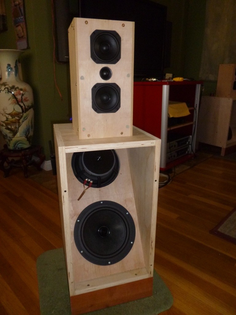

For KaZba, Qts between 0.35 to 0.5 can work, but try at least with 12in drivers. In my experience, a dual 8in just did not cut it. However, your results may vary depending on size of room and your room is very small.
KaZba is different from open baffle dipole in that the K aperture loads the cone so it needs a stronger motor (lower Qts, higher B). If no K aperture, feel free to use high Qts OB drivers - but it is no longer a "K". 🙂

0.6 Qts is not that high... (although they may not measure as advertised). Those 6 inch drivers could work as a quasi-Kazba speaker. If you have a separate subwoofer to handle the deep bass, then you would not need to worry about a lot of displacement.
If you did want to use them for lower frequency bass, then you could use more of them per speaker (i.e, 4 drivers per speaker instead of two; 5 of them would equate to about the area of a single 15 inch driver).
The other issue is what size Kazba box you would need to make. Since the Q is higher than what X was designing, you would need to have a larger box and a larger Karlson-style opening than what a lower Q driver would allow, which would load the driver less.
Since you don't already own the drivers, it might make sense to pick up a pair of larger drivers which would allow you to build the box in the style that X was designing. I would definitely go with the two driver approach, though, reversing the orientation of the two drivers from each other (reducing second order distortion is a good thing).

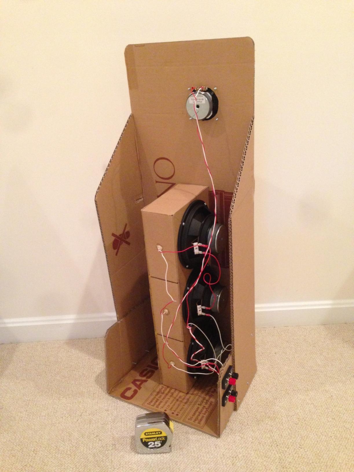

I made a slot loaded open baffle (SLOB) with qnty 6 x 6.5in high Qts polycone woofers once and it sounded very very good. The bass had a nice quality of naturalness and good for not shaking the room walls, but giving you the deep and articulate notes when you sit nearby. Although made of thick cardboard, it was one of the best sounding speakers I had heard. I used a full range to cross-over around 300Hz to 400Hz as a FAST.

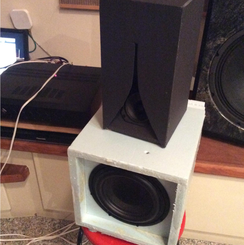

Thanks everyone for your input. If I may share my plan regarding this speaker build, it is to fill the lower end to accompany my 0.4x Mini Karlsonator using 1 Vifa TC9 each side. I want this speaker to fill 200Hz and lower. Flat down to 50Hz or so should be enough for me. The 0.4x K is rated 8 Ohm and 88dB/W/m, is that about right? Then either the 6” or 8” driver above can be wired in parallel to get 4 Ohm and 94dB/W/m? I am looking at open Z baffle here.
Does the above sound doable, and will these speakers work just okay? They are bargains, priced much like Factory Buyout drivers.

You can wire the mini-K and the woofer in parallel, and get 4 Ohms (that is if you don't use a XO) but you will not get 94dB.
If you use a XO (well, you'll need it, so it's not really a suggestion) then you are back at 8 Ohms.... and still not 94dB.
The best way to handle this is to use a sub amp. It can be bought new, or salvaged from a subwoofer box with a damaged woofer. Plenty of people selling 2nd-hand plate sub amp. Should be able to get it cheap.
With the plate sub amp, you get a variable XO, a boost at about 25-35Hz (most of them have it) and a volume level to match output to the mini-K. That way, you don't need to try to mess with a passive XO.

No, not from me other than sad news that my foam core Kazba got destroyed in the basement flood almost exactly a year ago.
