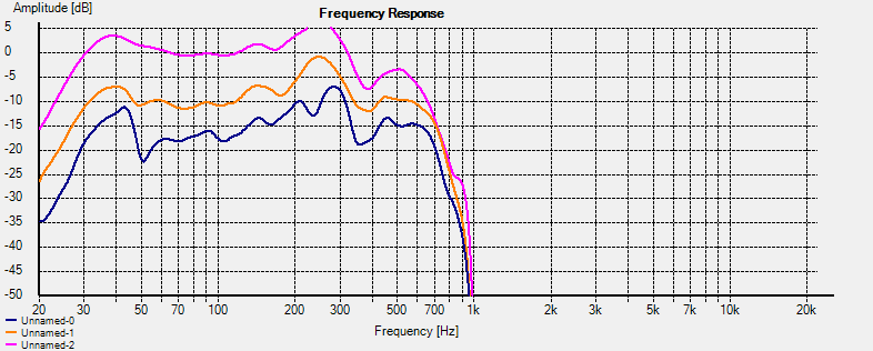

My internal cabinet dimensions are 16" x 14" x 26". Baffle is 20 deg. I did 3 measurements from the center height, 3 ft.(blue), 1.5 ft.(orange) and edge of the cabinet (magenta).

That's excellent bass extension. That looks like a solid dipole sub woofer. Can be used for a lot of things. Try the aperture though and see how it sounds.

Can you explain this graph to a layman like me? To an amateur it looks like it gets quiet fast. Not disputing the excellent results just trying to understand what it means and how to maximize my PRV's at .62.

That's just the bass measurement from 20Hz to 500Hz. I only measured the woofers.
