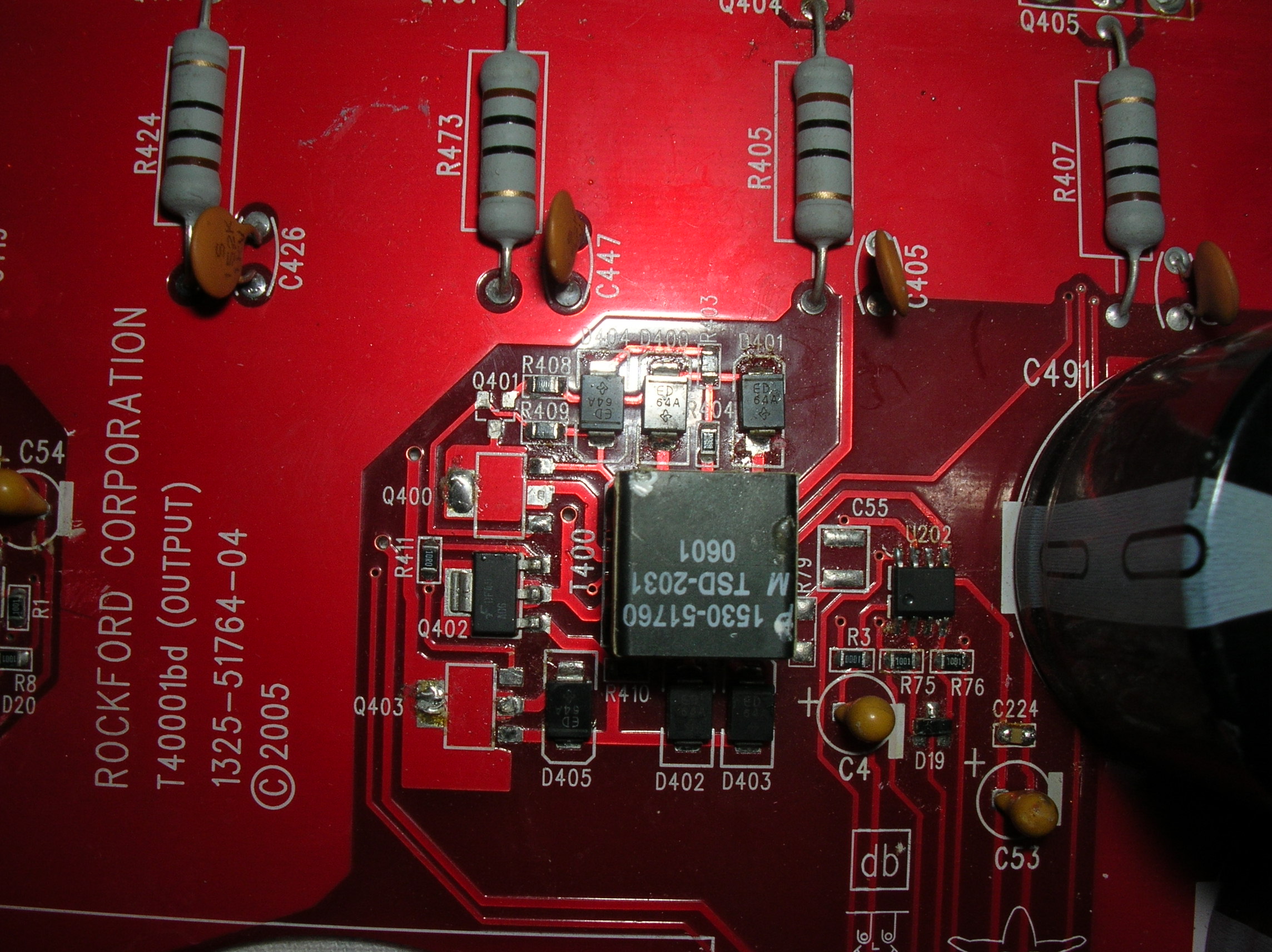

I received today the parts I ordered (the 20 fet, and 5 LM5110 not inverted)
I have done some inquiries before installing the fet ...
I connected the amplifier to observe voltages in each of the four fet groups of the audio output motherboard, and I detected differences ...
In the first set (Q404, 405, 410, 430, 434)
Source: 0v
Drain: 145v
Gate: 6,6v
In the second group (Q431, 414, 413, 412, 411)
Source: 4v
Drain: 0v
Gate: 6v
In the third group (Q433, 429, 428, 427, 426)
Source: 4v
Drain: 0v
Gate: 9.7v
In the fourth group (Q432, 420, 419, 418, 417)
Source: 0v
Drain: 145v
Gate: 3,2v
At all gate of the fets, I see square waveform except in the fourth group.
is this correct?

Yes, Perry, there is square waveform on the output pins of the two IC's.
I have seen the voltages and in U202 on the output pins there are 3.6v, and on U204 there are 1.3v....
Are the supply voltages the same for both ICs?
Is the amplitude the same on the output for both ICs?
I'm assuming that you're measuring the voltages you're posting with a multimeter.
