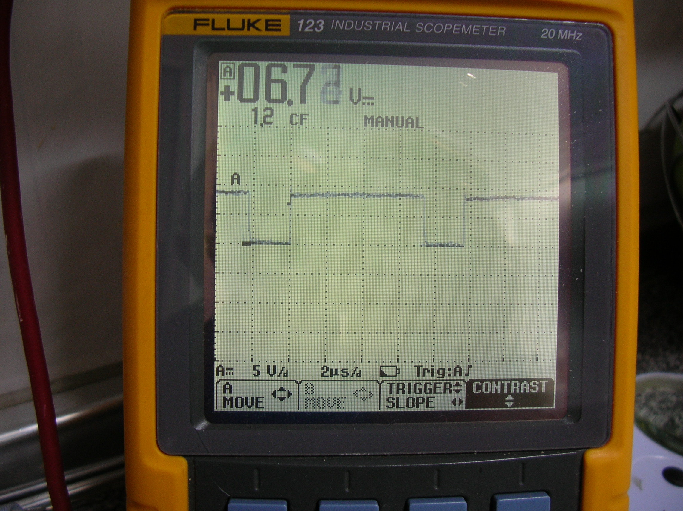

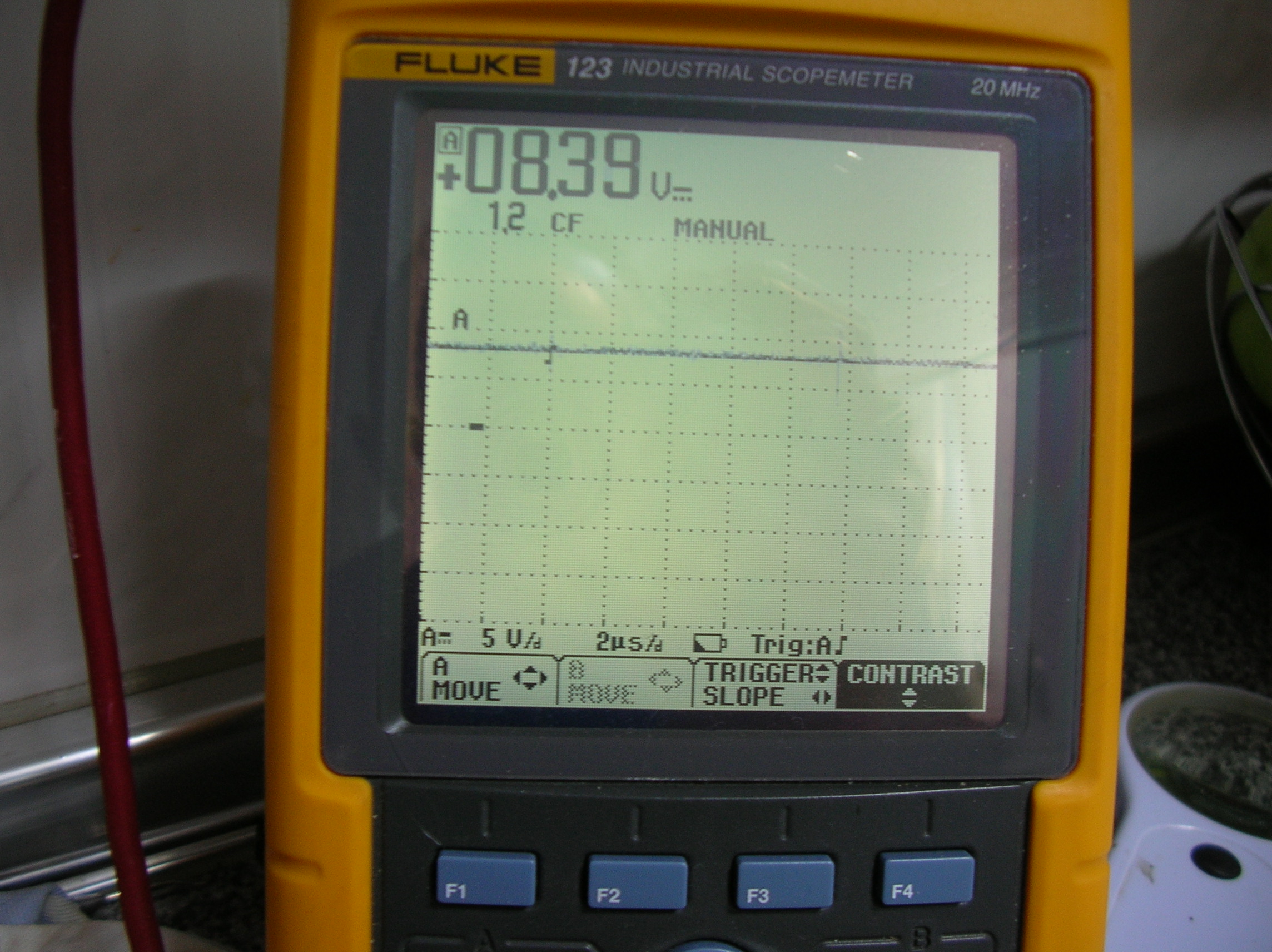

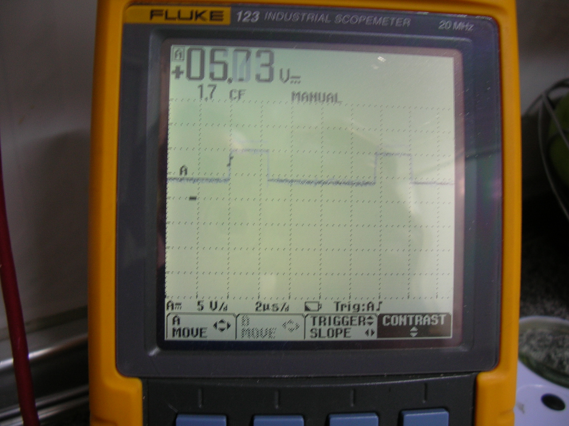

Here I show the pictures of each group of five fets.
The first corresponds to the first group (Q404,405,410,430,434)
The second to the second group (Q411,412,413,414,431)
The third to the third group (Q426,427,428,429,433)
And the fourth to fourth group (Q417,418,419,420,432)
I have to indicate, in this latter group, the square waveform appears for a second, then disappears.

Yes Perry, at all measurements the scope probe was connected to the gate of the source fets on the motherboard.

With the power supply board disconnected (red and blue), do you get a good drive signal on all of the gate legs of the audio FETs?
With the red and the blue disconnected, I do not get any signal of impulse in the gate of the FETS.
Only 8v are obtained at Q411, 412, 413, 414, 431 and Q417, 418, 419, 420, 432
measured with the multimeter.

With blue wire and red wire disconnected, and a bridge between pins 1 and 2 of U301,
An almost square waveform is observed on the gate pins of all FETS
That's your drive signal.
What was wrong with the waveforms when you tested it in normal operation earlier?

Battery powered scope?
Probe ground on source leg or amp ground?
Which FET?
Are all FETs the same?
Which FET?

All right, Perry.
The scope has battery.
The probe ground is connected to the ground of the amplifier.
All FETS are the same.
The sample of the photo in particular is: Q413

It's virtually impossible for all of the drive circuits to have the same exact fault resulting in the same defective waveform. This is likely perfectly normal.
If the scope is battery powered and has no connections to it other than the two probes, you can touch the probes to the gate and source to get a direct view of the drive waveform.
