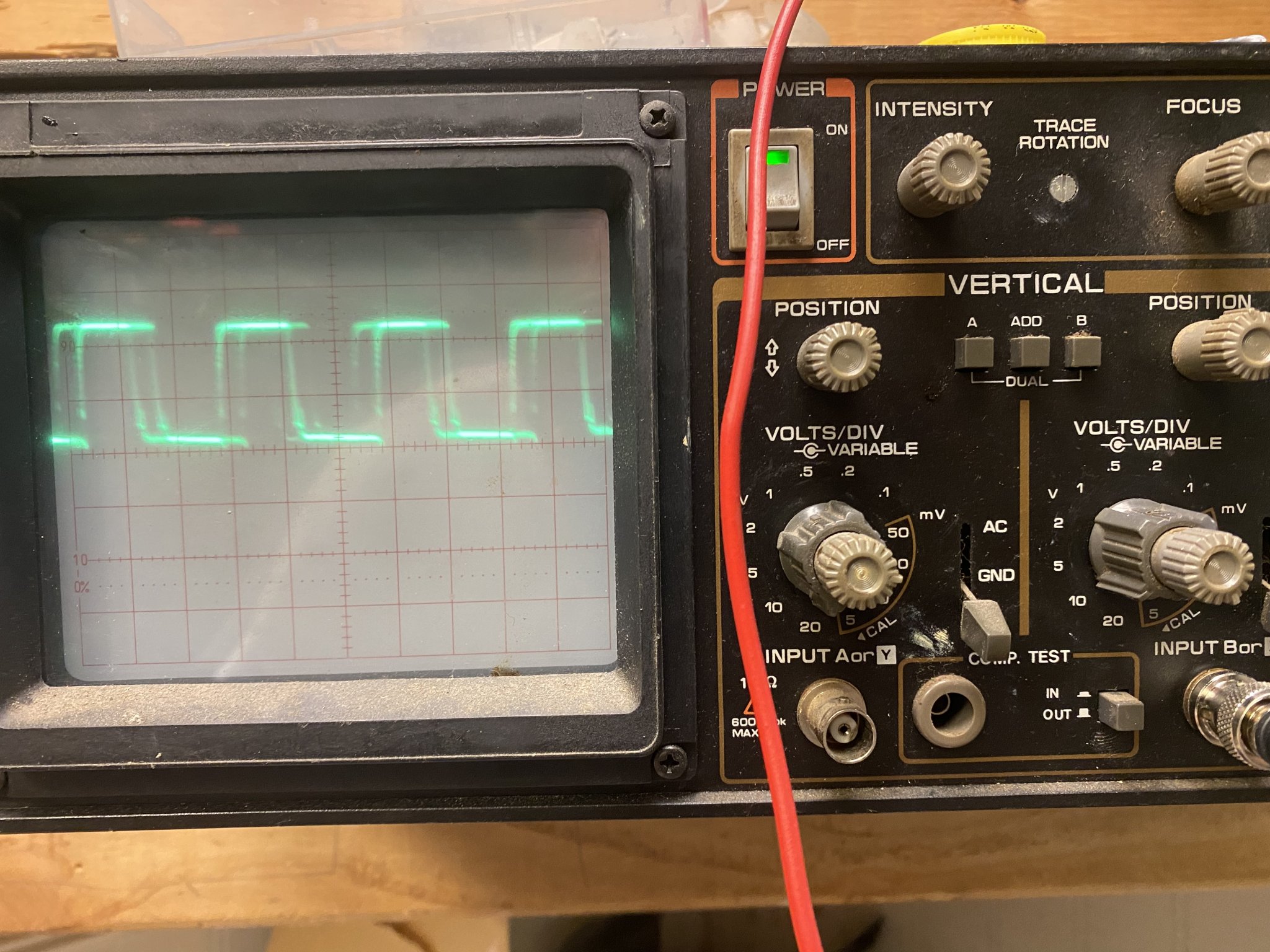

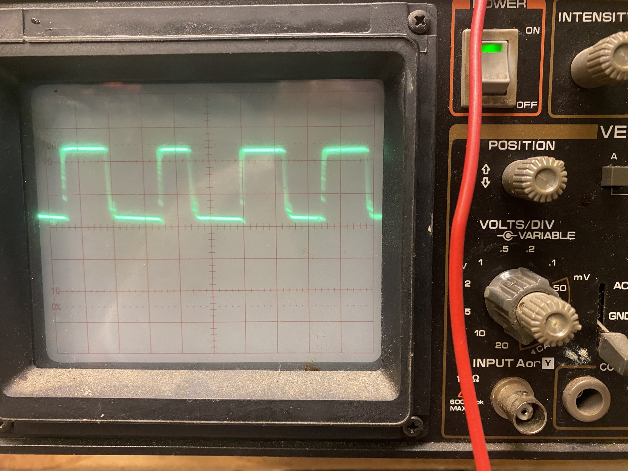

Adjust the trigger level to see if you can get a clean signal.
I think it's likely OK. Does it produce audio?
Here what I get after adjusting the trigger level
The amp will produce clean audio .
