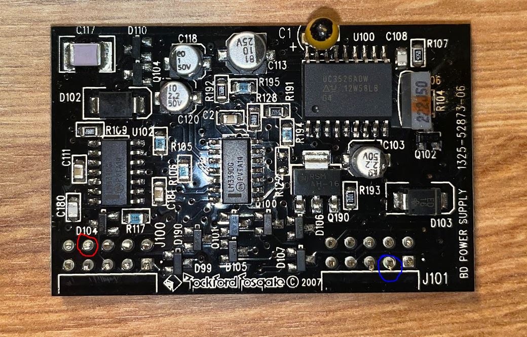

I removed the drive board from the amp and powered it by itself. Gate drive doesn't disappear anymore but it is sometimes jittery.
At first it was drawing about 60mA, i come back an hour later and it is now drawing about 45mA, but still has gate drive. It appears that the duty cycle is a bit lower as well.. Power cycle and it looks normal again, but still jittery.
C106 sets the frequency of the PWM, I replaced it with another 2.2nF cap but doesn't seem to have helped.
With the drive board running standalone like this, the duty should be consistent and not change right?
I didn't pull anything up or down and only had 12V connected to red circle and GND connected to blue circle (attached pic).
It seems that when the drive board is wired to the amp, something is causing the comparators to trigger. Do you know what could cause a fault with only REMOTE power?
Hmm.. I didn't remove the actual IC, but am powering the BD power board as shown in the image above. Sorry if that was a little confusing.
The Shutdown pin of the 3526 does go LOW when the BD power board is installed in the amp. Which means something is driving one (or more) of the comparators outputs to a faulted state when it is wired to the amp. What could potentially trigger the comparators when only REMOTE power is applied?
