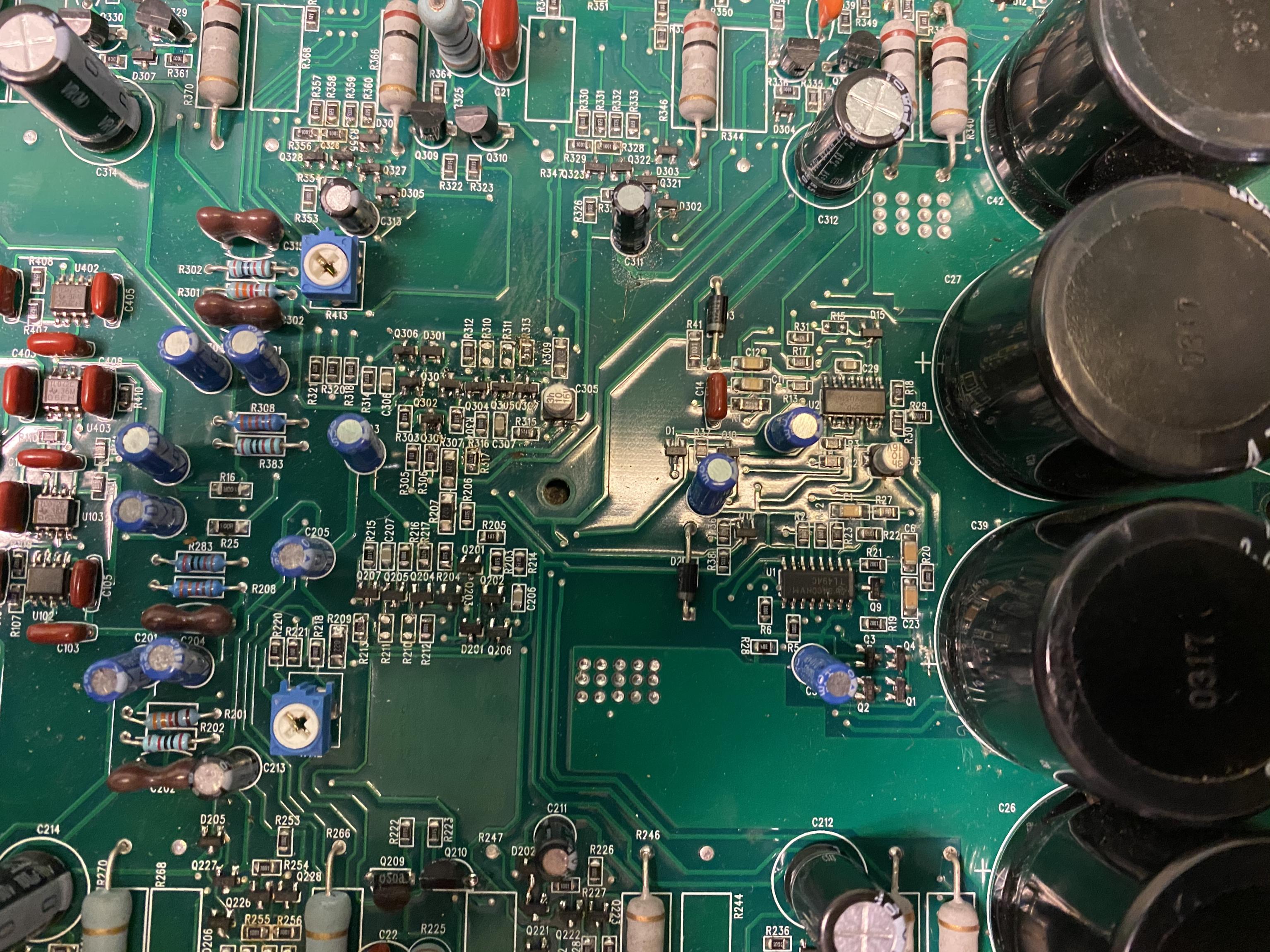

Anyone know why every source resistors is way out of tolorance and about 90% if the smd resistors are burnt in both channels like the amp self destructed . And most of the smd transistors are also shorted

When the outputs fail, that can cause the source resistors and driver circuit to fail. When the source resistors fail, that can cause even more damage in the protection circuit.
Have you carefully checked Qx01-Qx07?

Qx01-Qx07 means 14 transistors, not 4 transistors.
Are the voltages indicated for this part of the diagram what they should be?
If I leave out R310,311,313 would it hurt anything so I can check the voltages ?

No the amp burns R210,211,217,R310,311,R313 instantly as soon as I touch remote voltage to the amp
According to the diagram it appears I should have +15 volts on R330 I’m
Getting 49 volts and on D303 I should have -15 volts I’m getting 20 volts
So none of the voltages are correct
Ok found the LM317 is defective it has 50 volts on the output leg .
The LM337 is at 20 volts .
