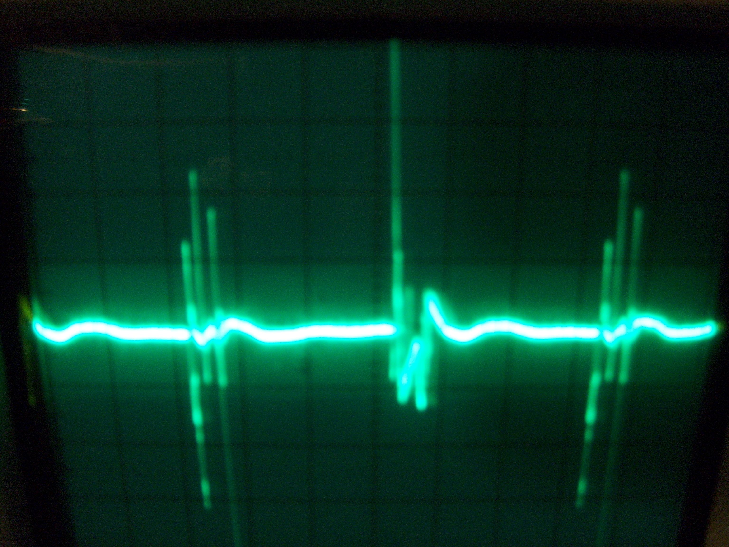

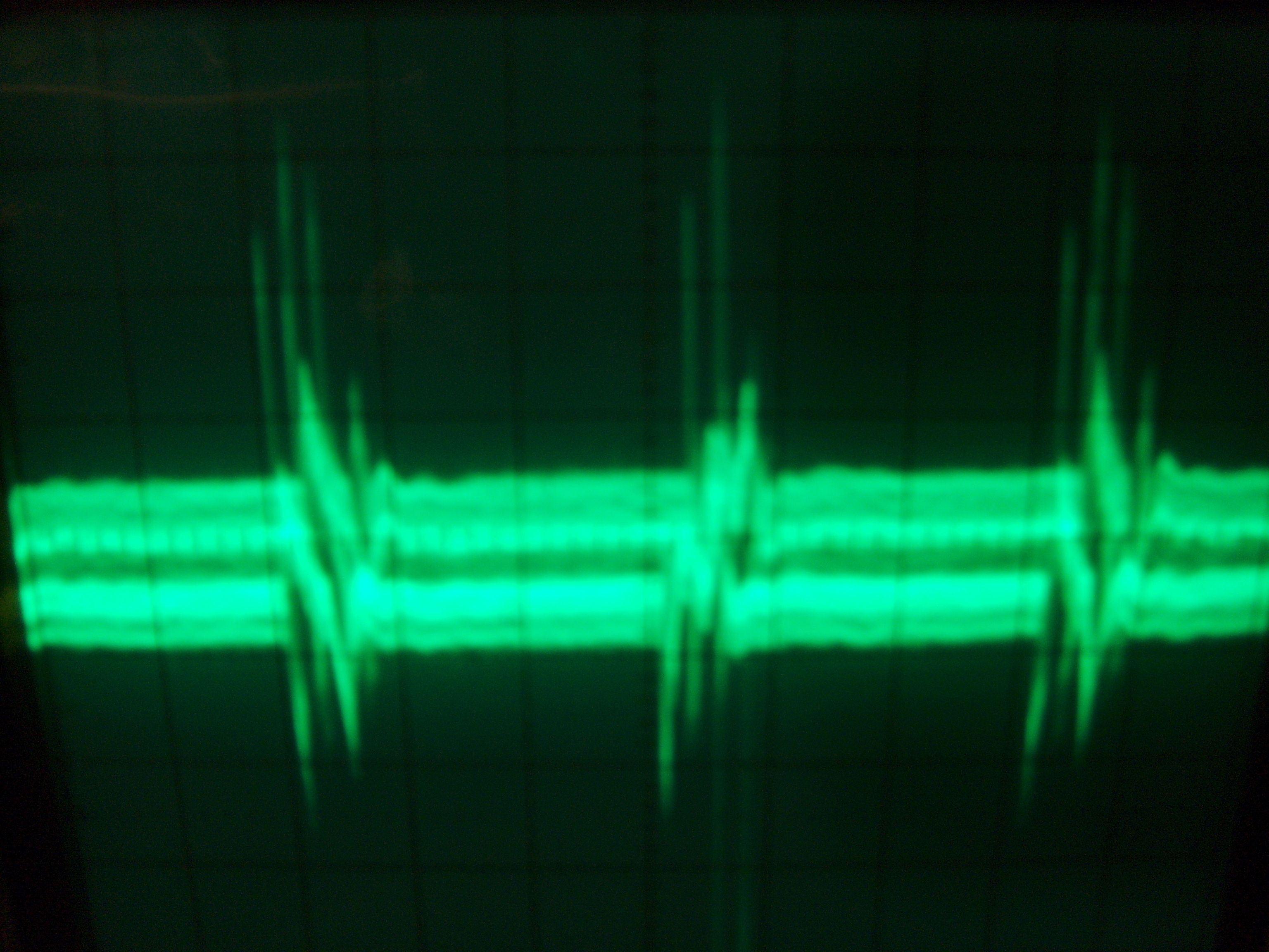

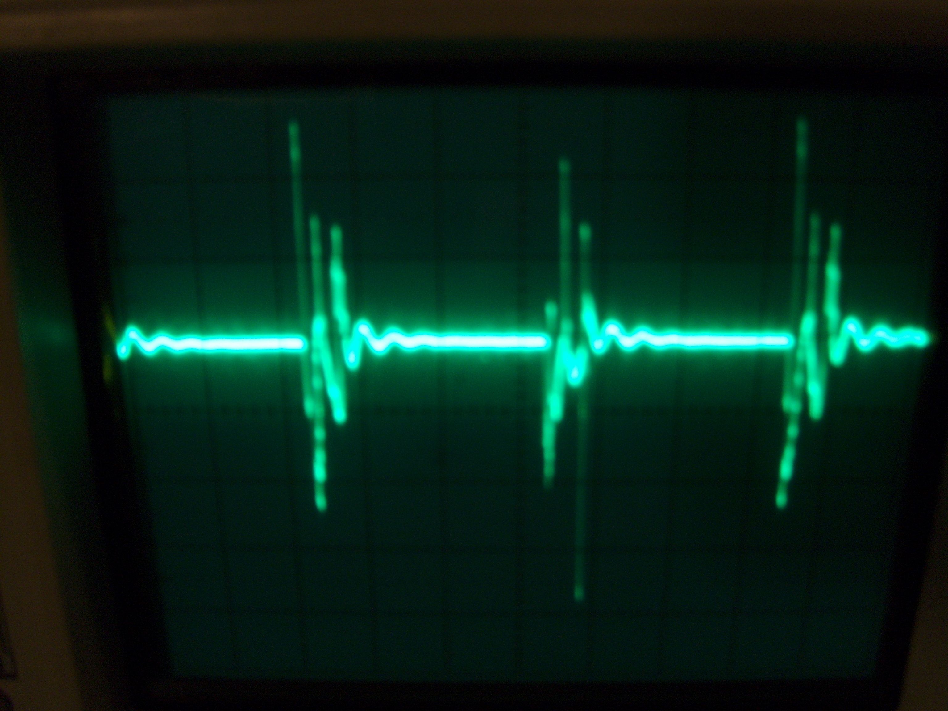

I will post a series of pics. The first is input signal at idle, the second is the good channel at idle, and the third is the faulty channel at idle. Scope settings are 50m vol/div and 5us.

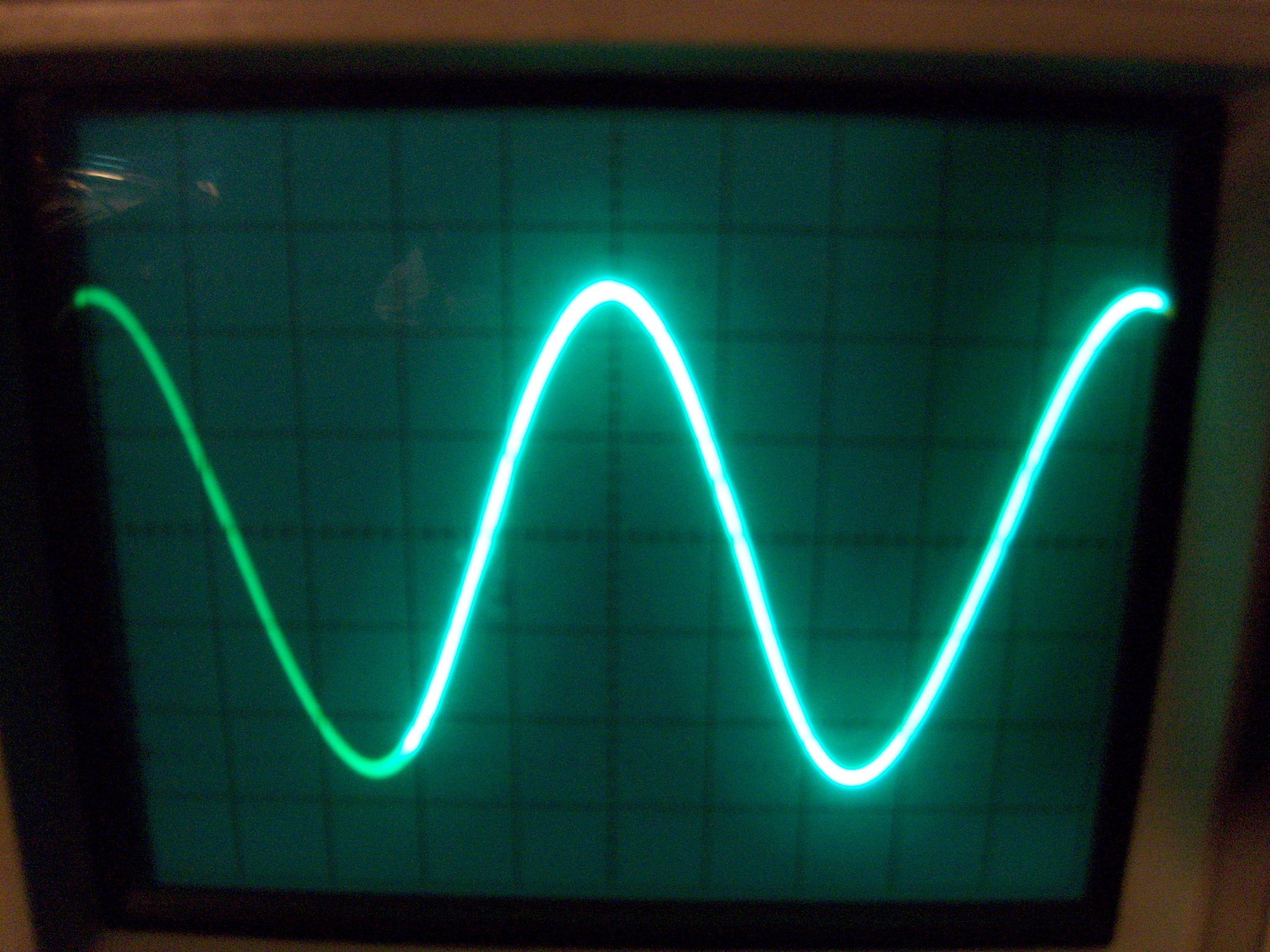

I posted a pick of the good channel wave form. This signal is identical on both sides of C111 and changes as it should.

Scope settings are 5 vol/div and 2ms

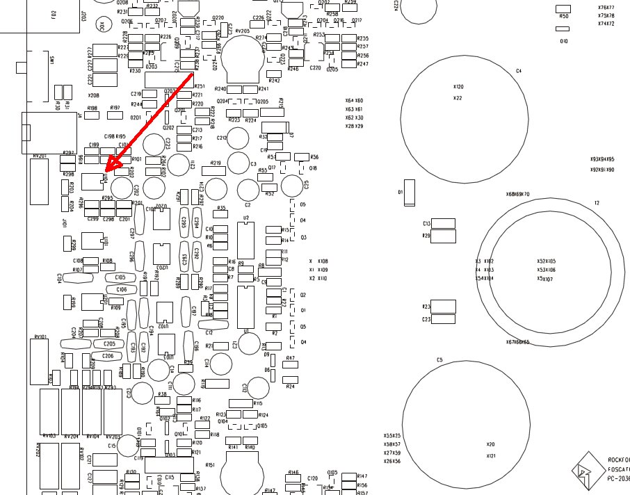

I dont find any U104 on the board.
U101 U102 U103
U201 U202 U203
These are the only ones I see.
