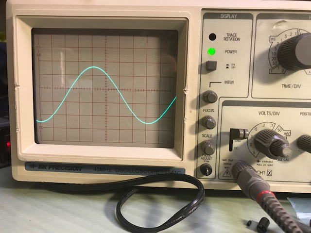

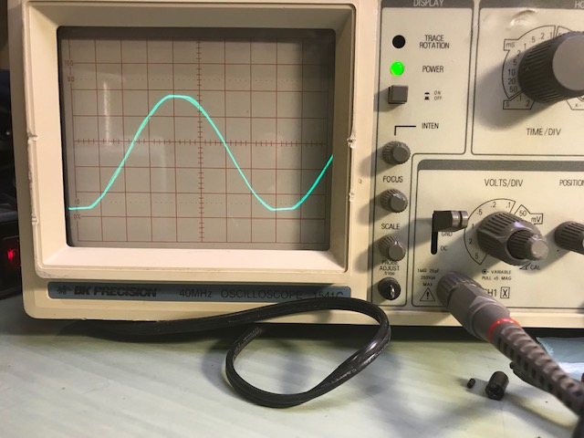

OK channel 3 definitely is different from the others in that the bias pot makes little difference in power draw, no matter where it is turned. The sine wave output is clean though. I had another set of output transistors, so I tried changing these, but it made no difference.
Here is the scope plot just under clipping: 9959
and just into clipping: 9960
